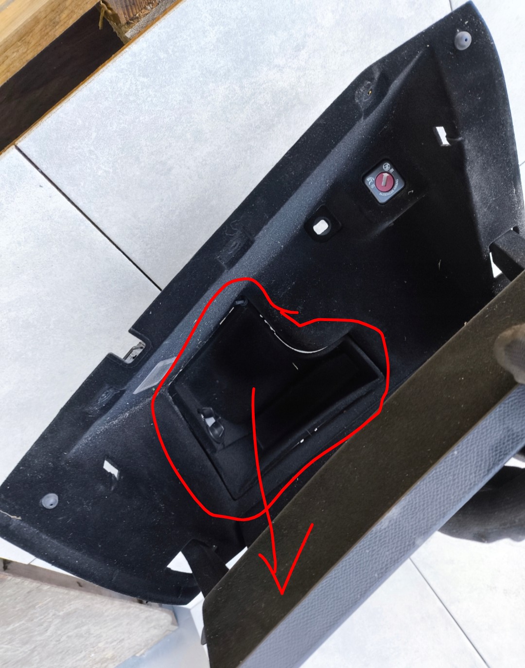

Just familiarising myself with the car, I’m slightly confused to where the cabin filter is? Some people have mentioned it’s behind the glove box but I can’t see anything, I’ve removed the little panel in the passenger side and the panel underneath the glove back and can see something that looks like a filter compartment behind the centre console, I took the little plastic cover off and there is no filter in there but it looks like that’s where is should be.

The same place as in many currently produced Stellantis cars.
Look here:
But to make replacing the filter easier, you can remove part of the passenger glove box. This helps a lot. Unfortunately, the guy in the video didn’t know that.

What a bloody nightmare…I’m sure my glove box is different.
Replace the filter by removing a section of the glove box, and then imagine that other cars don’t have this feature. They have to change the filter from the bottom, like in the first video. You’ll be grateful yours has one.
My glove box has a fuse box in it so getting your hand in looks near on impossible.
Sorry, but I’m forgetting about the UK version. In that case, only on the driver’s side and only from the bottom? Unless they made a different version of the air mixer for the UK.
