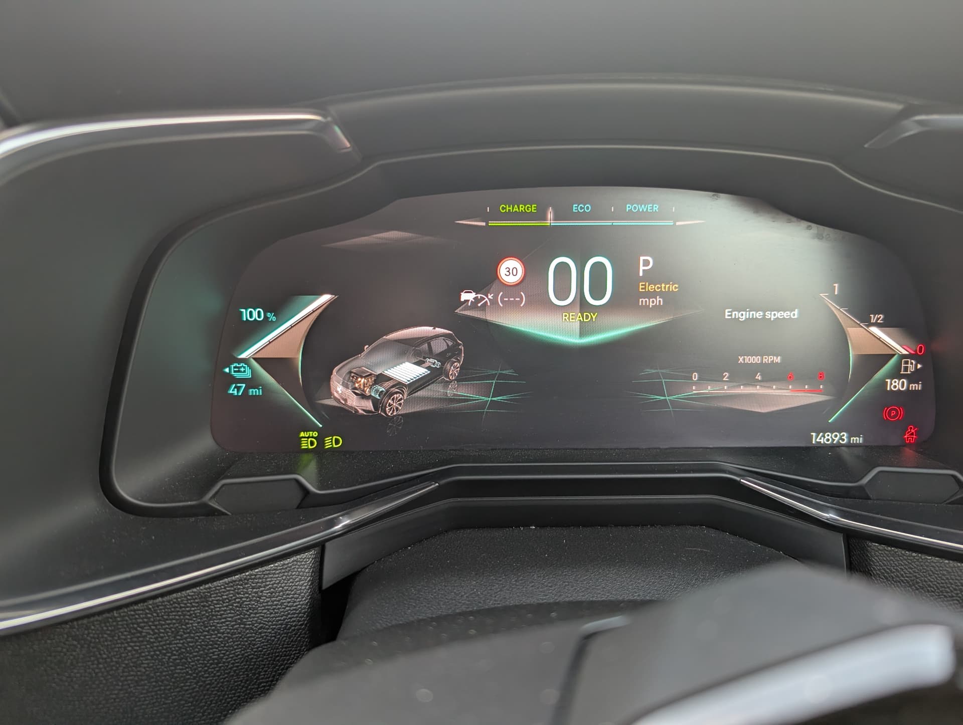

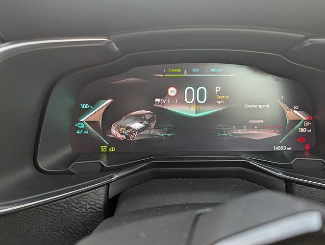

Just to add to the discussion my GOM is indicating 47 miles range :smiling_face_with_sunglasses:
I don’t understand how you guys do it.
I’ve never had the GOM over 40km (25 miles).
:roll_eyes:
Me neither.
It must be something in how the car is used though .
