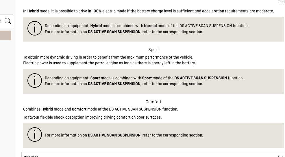

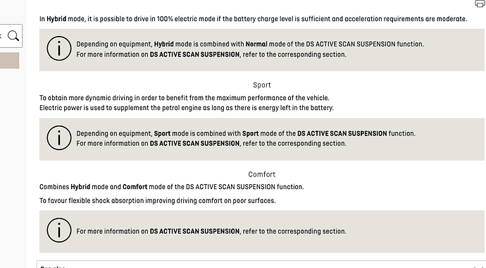

jUst found this .
So Hybrid is a combination of comfort and hybrid.
The manual terminology seems a bit ambiguous. My understanding is that there is no difference in terms of how the powertrain works between Hybrid mode and Comfort mode, they are both have normal hybrid operation. The difference is in how the suspension is tuned, though the manual does implies that the Active Scan is active all the time, but just gives different actions (Normal or Comfort).
Sport Mode has a different powertrain operation to Hybrid (and Comfort) and Active Scan in Sport mode.
… it is all very woolly as to what those things actually mean, but the different modes do change the behaviour of the vehicle dynamics per their description (Hybridi/Normal, Comfort or Sport)

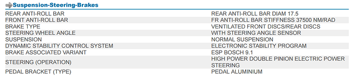

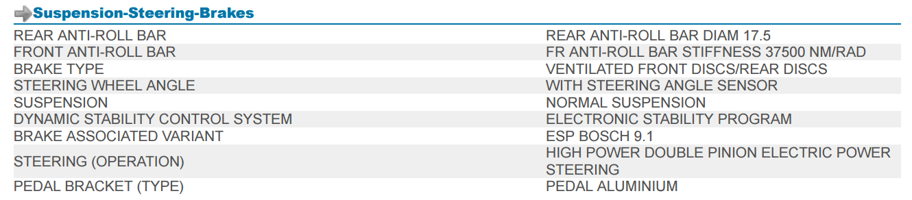

I do have the PDF that you get from providing your VIN to the admins here. Not sure what I’m looking for though, except for what’s in the screen below.
What is “Normal suspension”?
That’s what I class as a build sheet, and yes under ‘Suspension’ it says ‘Normal Suspension’, if you had Active Scan it would say something different!
