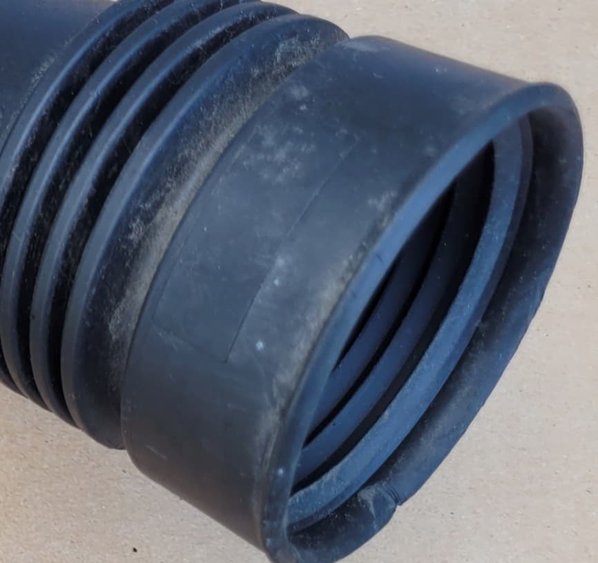

I also noticed something suspicious. The large corrugated intake hose fitted just after the MAF body moves quite easily on the MAF housing. There is no metal clamp there. I looked at pictures of a compatible VDO/Continental MAF, and the long neck where the hose fits seems completely smooth, with no groove for an O-ring.

On this 1.6 e-HDi / DV6C engine, is it normal for the large intake hose after the MAF to be simply push-fitted without a clamp and without a visible O-ring? Should it move quite easily, especially when warm, or should it be tight on the MAF body?
The hose seems to correspond to PSA part number 9683725080. I am wondering if the hose may be old, hardened or enlarged, allowing unmetered air after the MAF and disturbing the EGR/injection strategy.

Any leak between the turbo and the mass airflow sensor causes problems.
There must be a clamp on the mass airflow sensor side and a proper seal on the turbo side.
yes, this is my opinion too…but I looked for more pictures of this engine and nowhere did I see it have a metal collar there (like I’ve seen on other cars) - I think maybe it has an o-ring that is not visible…but I couldn’t find any code, or a schematic/diagram where I could see this).
It might not have a clamp, but there should be a gasket inside the pipe consisting of three rings. Even if you put the clamp on, it won’t do any good without that seal. Check if it’s there.
That was my suspicion (I haven’t removed the hose completely to check yet)…is the gasket separate from the tube or is it made of the same material? I pulled the tube a little and it seems to move very easily…if I pull a little harder I can feel it coming off the MAF tube - shouldn’t it offer some resistance if the gasket is in good condition?
It should.
