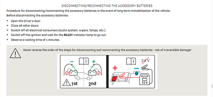

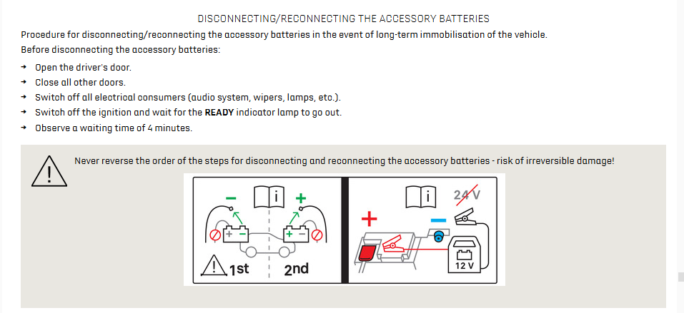

It shows the order on how disconnect in the cars manual.
I believe its negative on the smaller battery first, then positive on the main one, then negative on the main one.
Connect the positive first when reconnecting.
