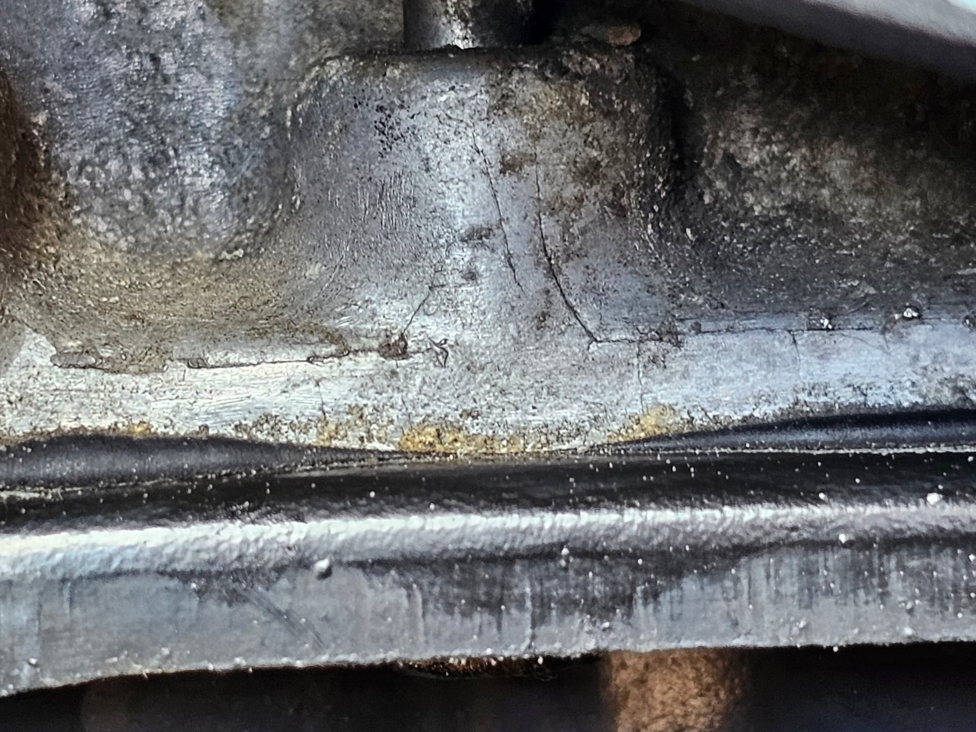

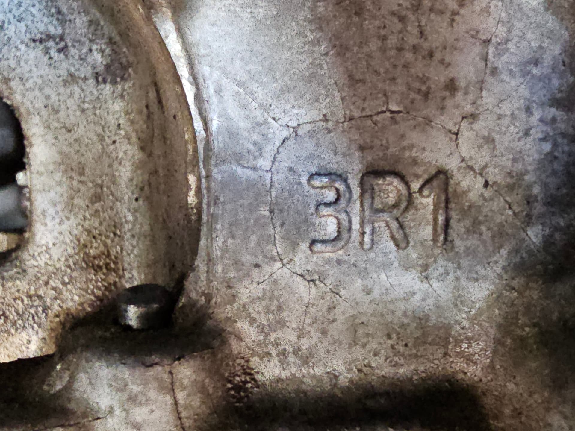

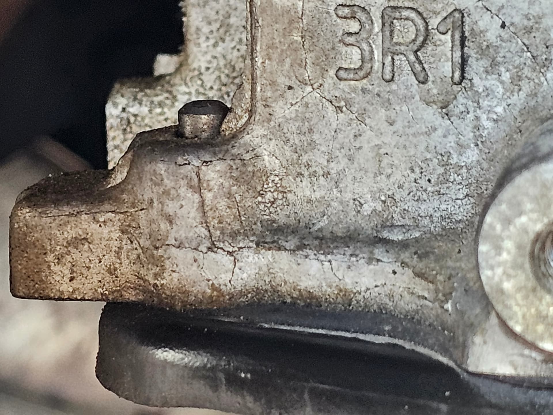

I have a ds7 crossback 1.6thp 225bhp 2019 55k, changed auxiliary belt today because of high pitch squeal after revs drop to tick over after starting, quick rev and it goes. Turns out not that still does it. Think now water pump tensioner friction pulley. BUT this is not for that.
It is for what ever these appear to be in these images. Don’t like the look of these. Any thoughts anyone.
Replace the valve cover because the engine breather is whistling. A known issue. OE no 9818425480.
This is often what aluminum looks like after being removed from the mold. It is purely a matter of aesthetics.
