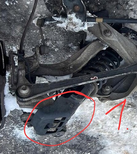

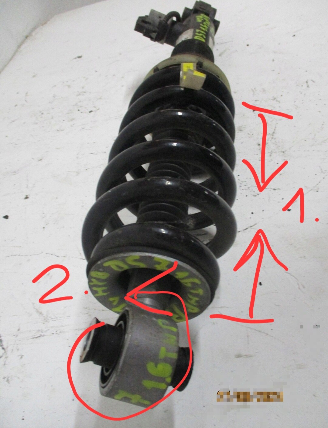

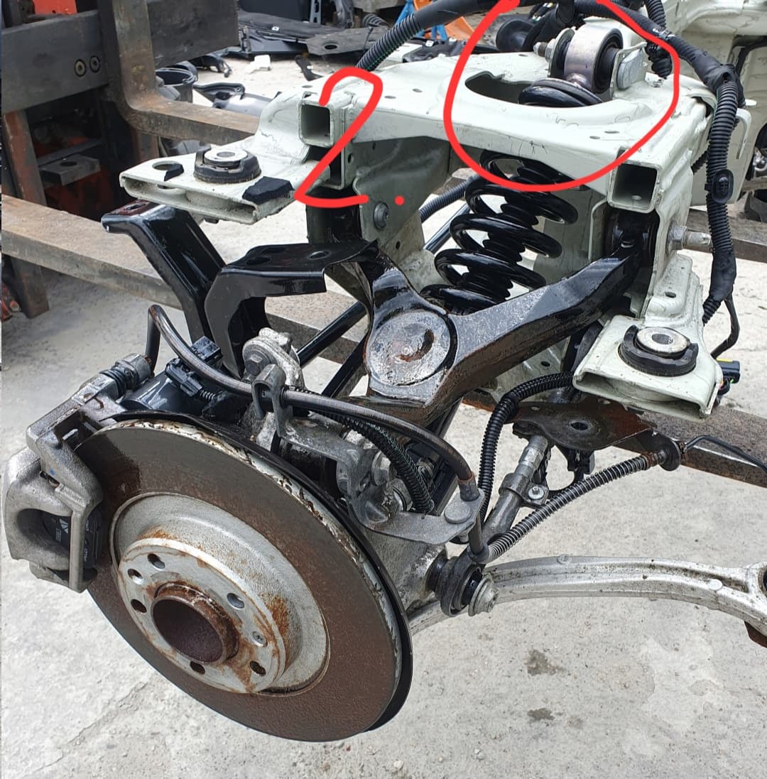

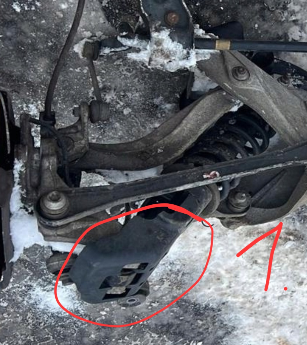

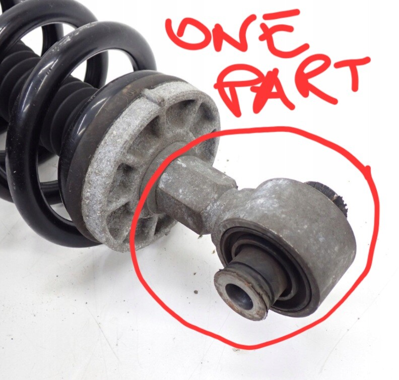

To remove the shock absorbers and springs, you need to unscrew four bolts (two on side) and disconnect the active suspension plugs. The upper shock absorber bolts (2) may be accessible from inside the trunk after removing the entire trunk floor; there are likely access covers in the bodywork there.
You need to compress the spring (1), then lock the shock absorber rod and unscrew the upper mount (2).
