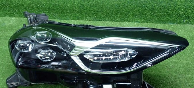

This will be difficult because the “super” LED comes with its own control unit and CAN bus integration—features not typically included in the basic lighting setup. It also requires automatic leveling.
A retrofit is likely not feasible.
That leaves the “Eco LED” option.
So it’d be easier to switch to a ds3 that has the led lighting?
Yes, if you want ones like these:

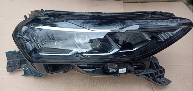

No, if ones like these will do:
AHH so if I pick up left and right of the bottom one, they are a straight swap?
I don’t have access to the diagrams, but I’m 90% sure this can be done simply, without modifying the wiring. However, you will need to change the BSI lights settings from halogen to LED. You adjust the headlight level using the switch in the cabin, just as you do now.

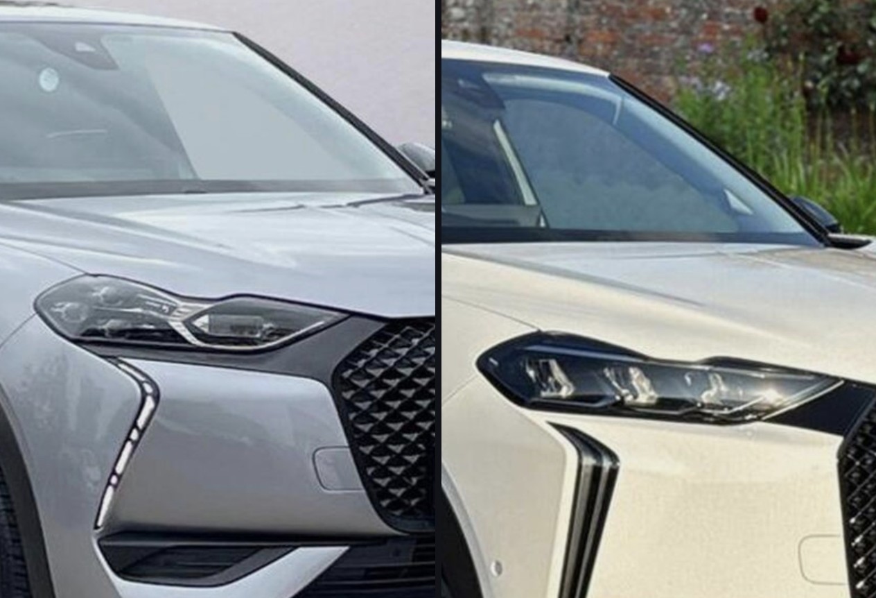

Also, which model are they from as had a quick scan on auto trader and can’t see any with them
Facelifted version from 2023
Ahhh would they work with my 2020?
If they haven’t changed the shape of the hood and bumper, it should fit.
They look slightly different :frowning:
Shape of the glass is the same. Physically, it should fit.
