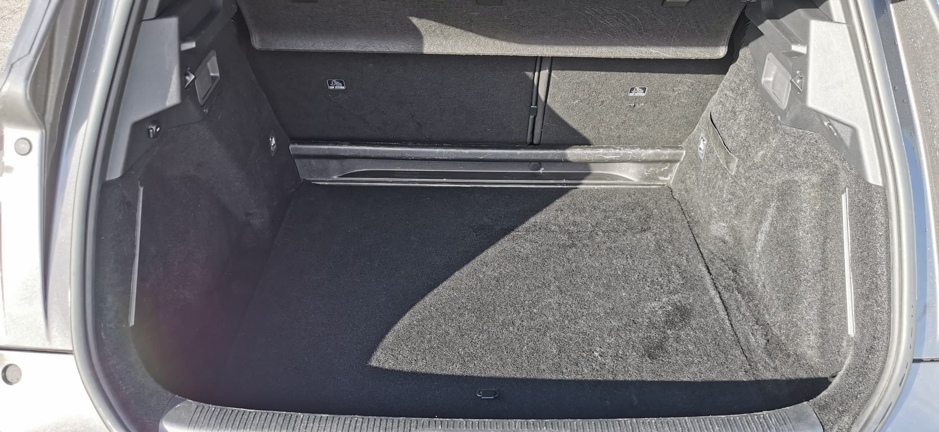

Hello, I’ve recently become the happy owner of a DS 7 Crossback… absolutely loving the car so far!
However, the car did not not come equipped with a variable boot floor and I was hoping if anyone knows if it can be easily purchased/fitted? I’ve had a good search online for the shelf, but without any luck. It seems a tricky thing to search for as my searches keep returning the boot trays and not the actual ‘false’ floor.

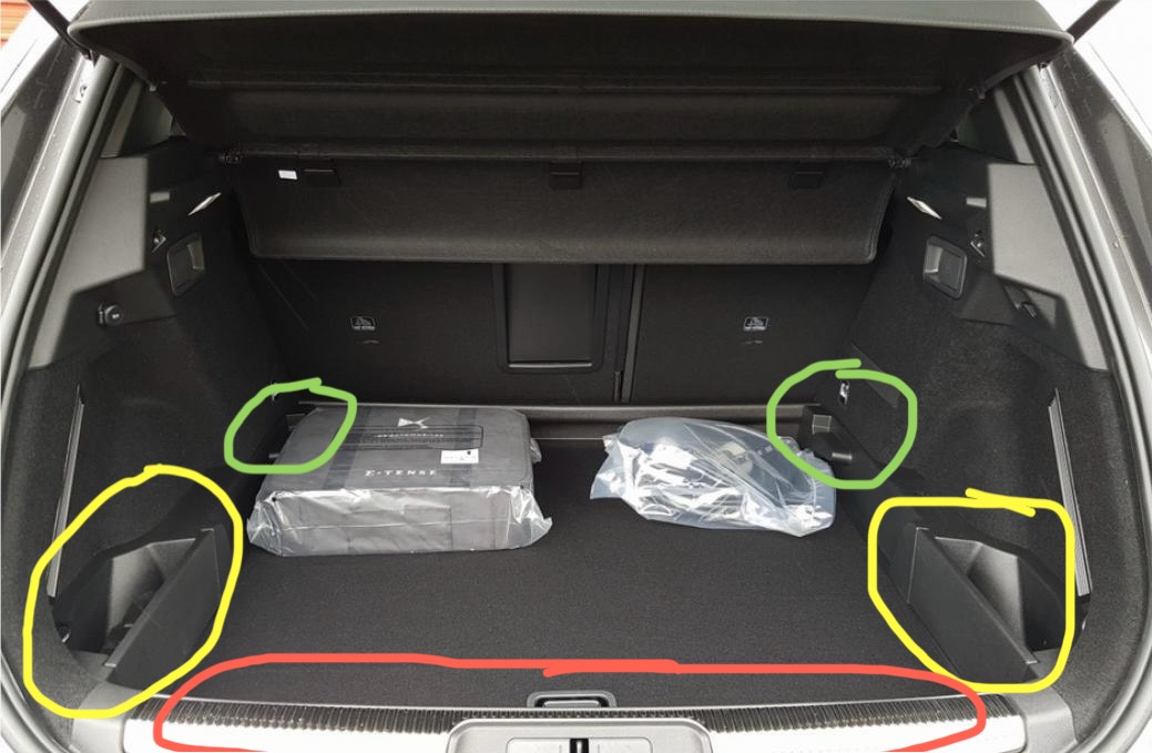

@ceejay2222 I’m in the same boat. Here’s what I was able to find. I’m planning on contacting them for them to check if this is compatible with my car as they can apparently check the part compatibility by VIN number:
This will only fit if you also have the plastic mouldings either side (yellow). The trim is different should also be metal (red) and there are parts for the shelf to rest on at the back of the boot (green).

Yeah, I’m afraid my DS7 doesn’t have that. Too bad.

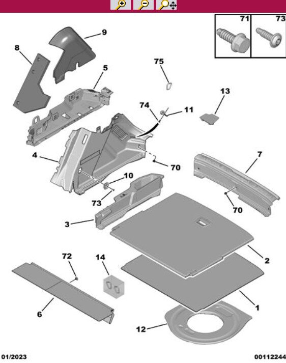

You require the following parts…
# Part Name Part Number Dealership Cost
2 False Load Floor 98 173 596 ZD £398
3 Bracket Right 98 174 877 ZD £86
3 Bracket Left 98 174 878 ZD £86
7 Rear Panel Trim 98 210 897 ZD £573
There will also be various screws/bolts required.
71 (MUL) FLANGED BOLT DIAM 6X100-20 RIGHT/LEFT BOOT SIDE TRIM SUPPORT FIXING (3) 6925G5 £0.83
73 (MUL) CBLX SCREW L=22 FRONT LEFT/RIGHT LUGGAGE ATTACHMENT FIXING (1) 9677750480 £2.27
