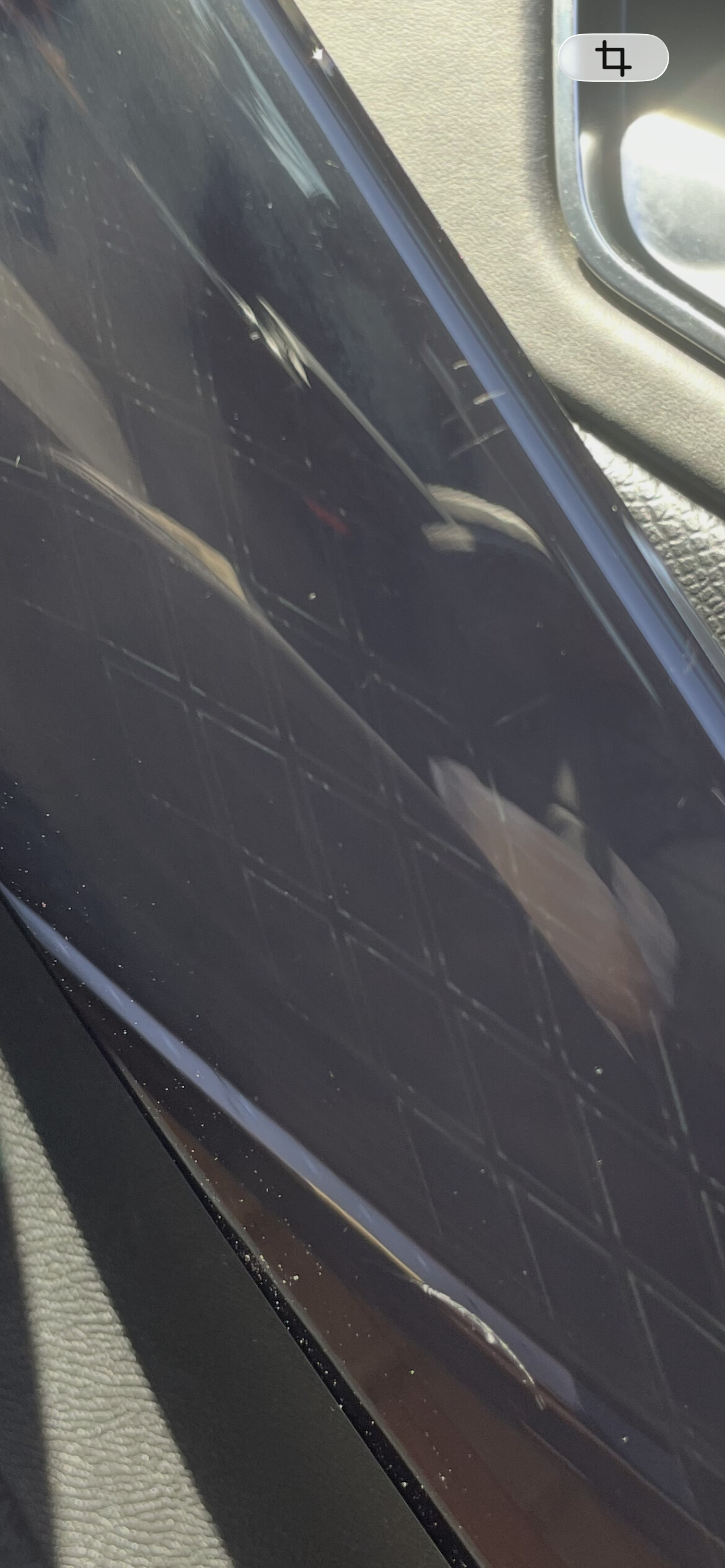

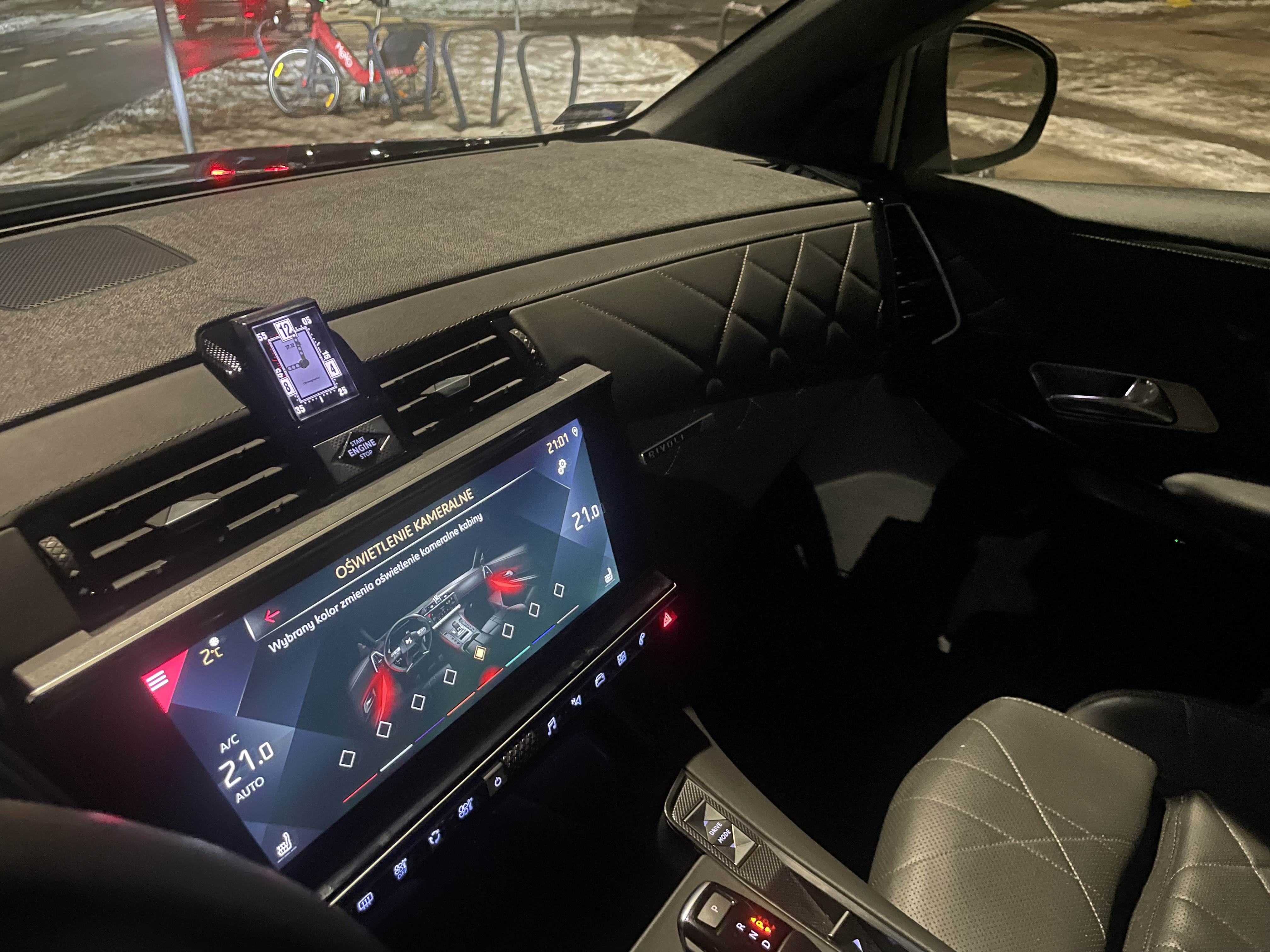

Hi, I have a question about the ambient lighting in my car.
In the settings menu, I can choose the ambient lighting color and adjust its brightness. The door handles also look like they should have illuminated diamond-pattern inserts. However, nothing lights up at all.
Is it possible that the menu includes the ambient lighting settings and the door handles are ok
, but my car actually isn’t equipped with ambient lighting?
I’ve already checked it in complete darkness, but there’s still no light.
