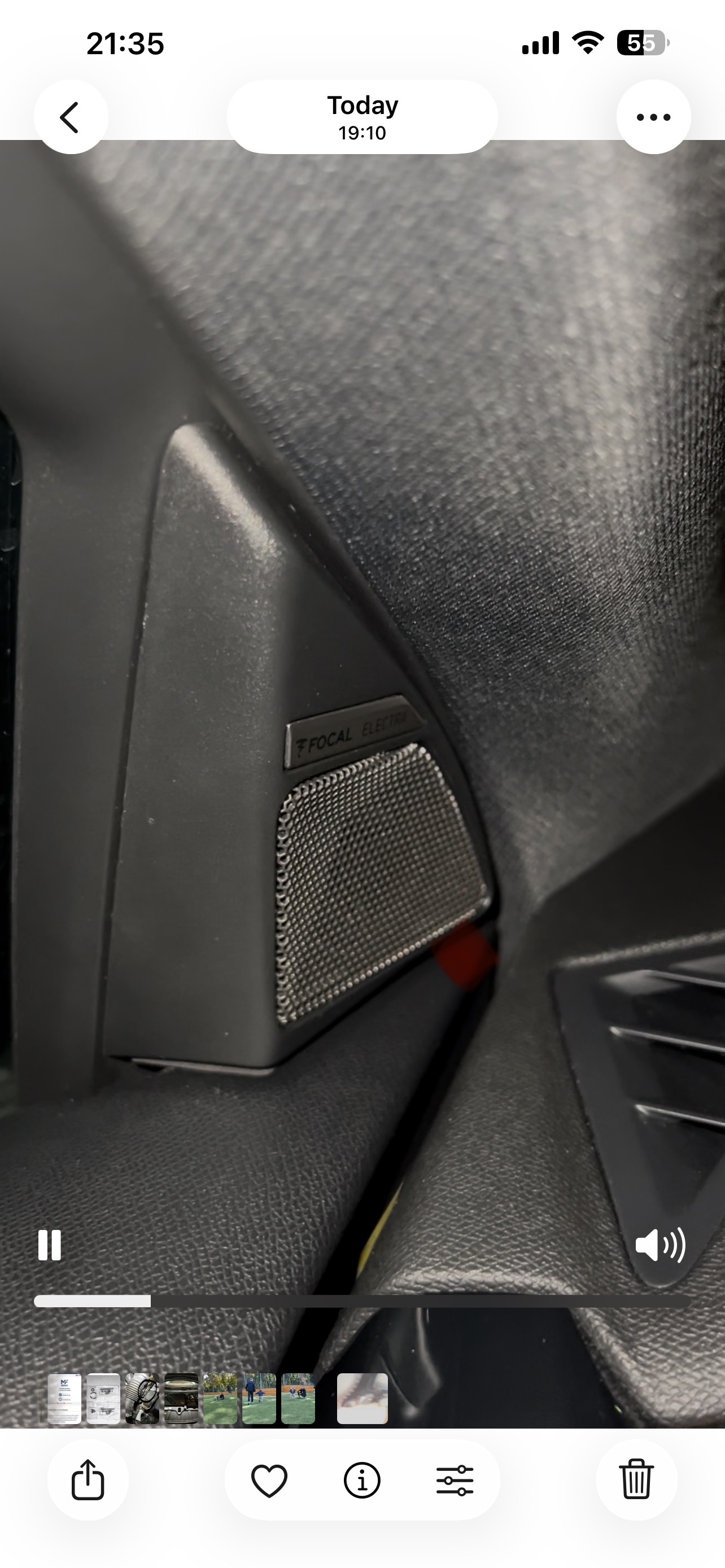

Any of you having rattle, clicking sound in the upper door trim side below or in front the small speaker where the doors trim ends? It’s quite noticeable now when its a bit colder outside. I can hear it from both sides and try to figure out what might be but still no luck.. If i even touch the upper part of the door trip with finger slightly, marked with red the
rattle stops..:blush:
Tried to put something between speaker and trim didn’t help. Seams like something related to the door trim upper part but quite annoying i cant figure out..
Any idea?:blush:
For anyone might having the same i manage to resolve it without disassembly by using silicon spray.. just spray between two contact surfaces or wherever the rattle comes from and it creates a thin layer of silicon preventing direct material contact between plastic rubber parts and stopping rattle or squeak noise..
