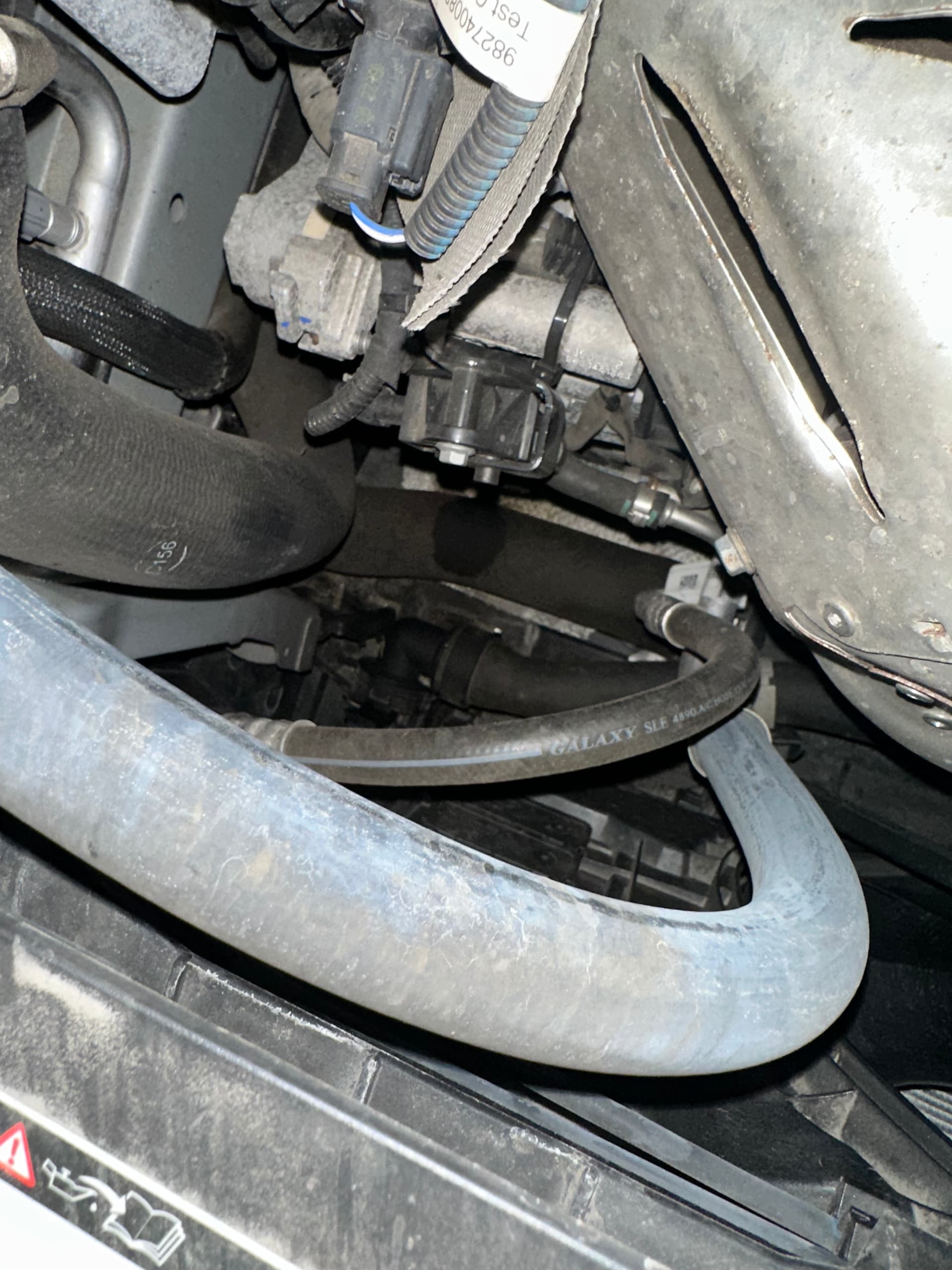

I noticed dark spot on the hoze, like it’s wet and after few days it’s gone and then shows up again. Could it be sign of antifreeze/coolant leaking since it is always a lil bit under MIN trashhold, but never goes more than this level?
Please see photo:
Could be condensation settling on the outside of the hose, this time of the year
It could be, but still amazed why am I loosing coolant so quick and it always stops just a bit under MIN mark. I asked them in the DS Service about this and the technician told me everything is ok with it. Temperature is always fine, no signs of leaking under the car, no milky deposit under the oil and coolant filler cap. :confused:

I added yesterday and now it’s close to MAX. Only concern now is what could be this dark spot on hose.
