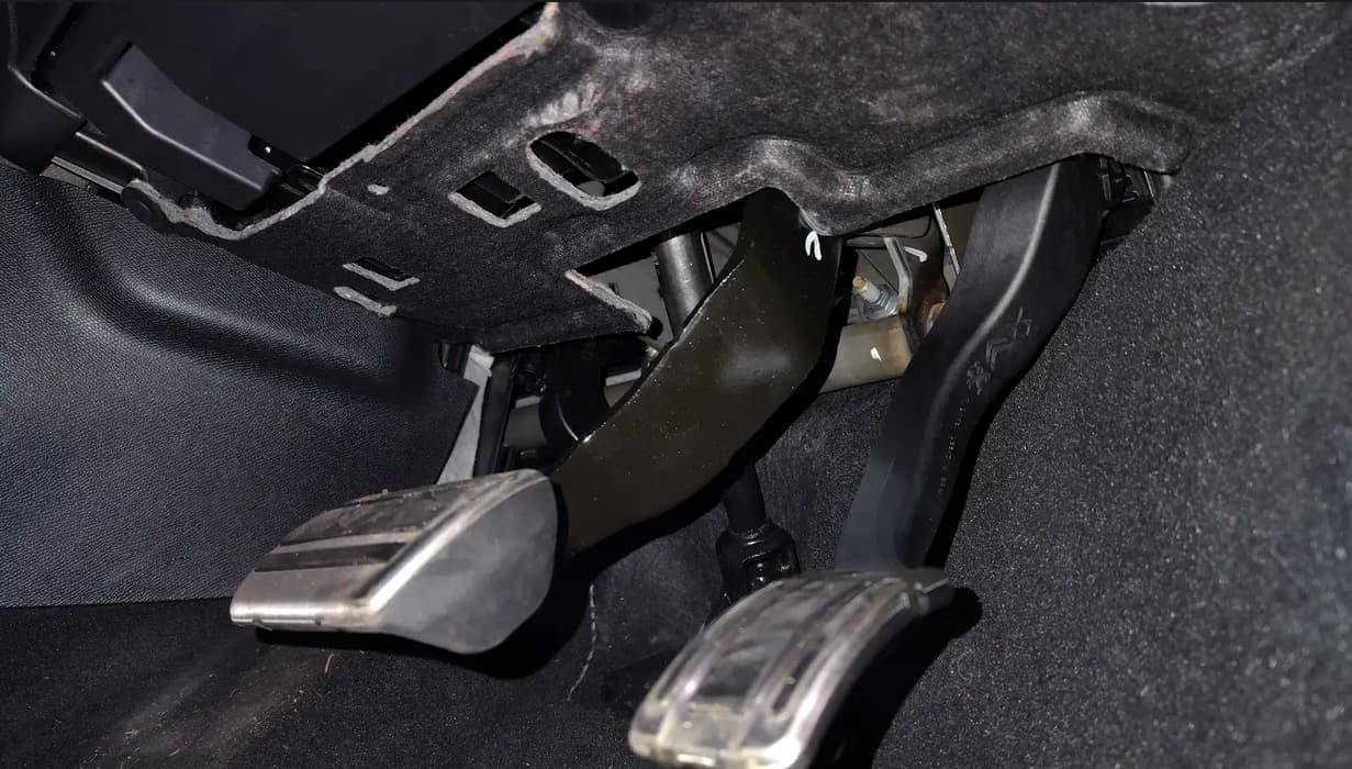

In my car (DS4 2022 E-tense), I am wondering if there is some missing trim that goes above the foot pedals. At the moment it just seems like some loosely fitted sounded deadening material - rather than some rigid plastic panel. Maybe it is supposed to be like that ?
Obviously I can’t see it - so not a problem - but I do get a bad draught of cold air around my feet when driving.
There was a small rectangular bit of black plastic that fell off into foot well when I first picked up the car, and maybe that is related - but it is only about 10cm x 5cm - and couldn’t see anywhere obvious for it to re-attach.
Thanks
It is exactly as in the photo.
Adjust the airflow, no foreign air gets in there.
Show us this plastic
Hi Andrew_PL, Thanks for confirming that there isn’t any obvious bit of trim missing from that photo.

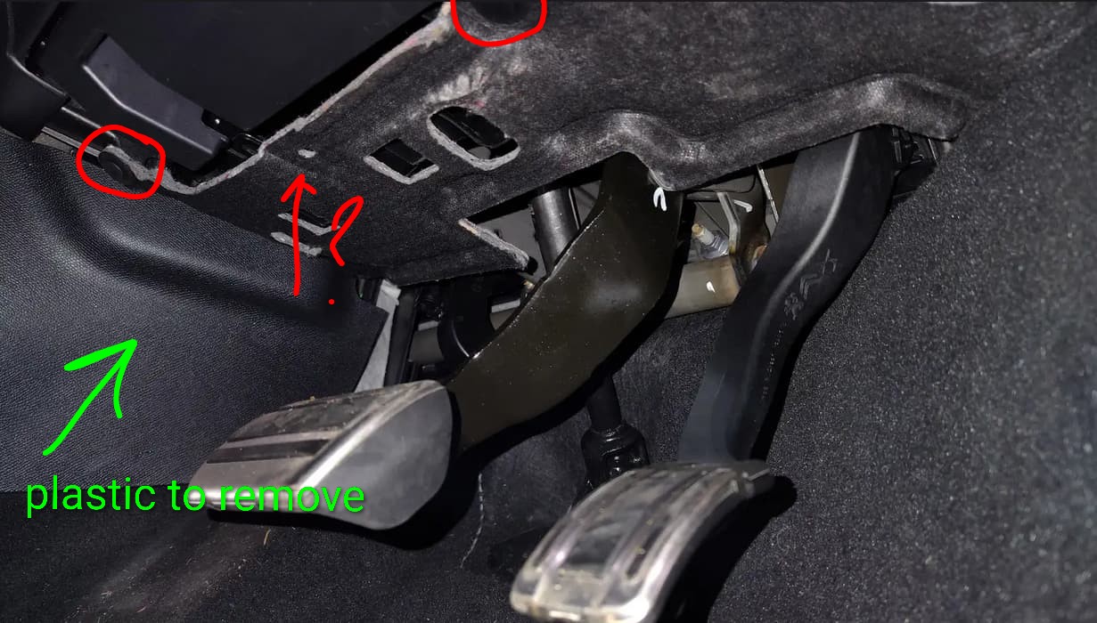

The panel has 3 clips (visible on the front along the glove box line) but I saw that yours doesn’t have one of them.
This plastic is inserted in the bottom center of the photo.
Thank you again - good to have that info,
The red marks are clips. The green mark is a panel that needs to be removed for better access to the cabin filter. The plastic has no screws, only latches. It can be removed by hand.
