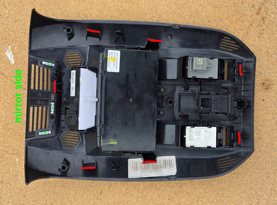

Anyone know how to replace a broken sunroof switch in a 2020 DS7 ? I have already purchased a replacement switch unit just don’t know how to remove the existing one.
Welcome @m.davies15
Rip out the entire panel. It’s held in place with clips. You will see the details of the switch after removing the panel.
Thanks Andrew but I’m a bit wary of “ ripping it down “ just in case I break something.!
There’s no other way. Start with the mirror side. If you’re worried, take it to a repair shop.
I’ve shown the panel’s mounting points with snaps in red. Green shows the mounting point for the small plastic piece (mirror side), which you can remove first.
Thanks for the picture Andrew, it shows me what to expect when I take the panel down.
