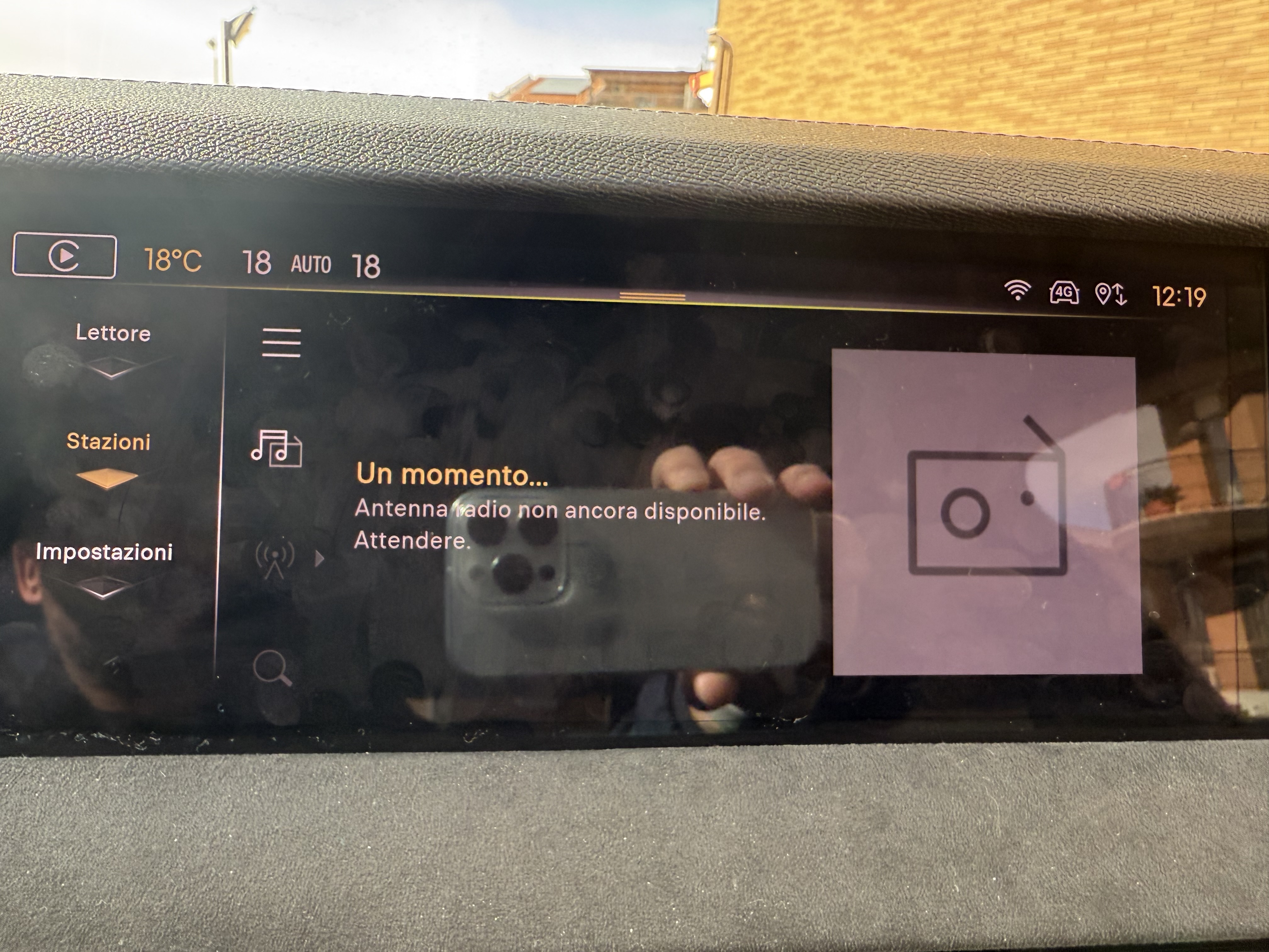

Hi, has anyone experienced this issue with the radio display showing “One moment… Radio antenna not available. Please wait”? How did you solve it? Thank you.

Hello, it’s always present. Unfortunately, the DS network in Italy is poor, and I was forced to turn to the Citroën group. After some diagnoses and various checks, they believe it is a software update issue with the BSFR control unit. Unfortunately, they don’t have access to the DS software update. They told me that many other DS4 owners have had the same issue during the OTA software update.
I wanted to know if anyone here in the forum has had the same issue and how they resolved it.
Otherwise, the alternative is the replacement of the BSFR control unit, which costs €650.
