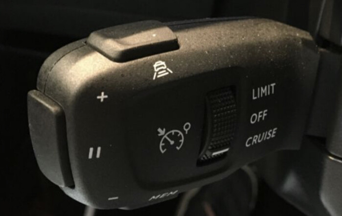

One easy way to tell, is on the cruise stalk, the top button is for the distance on models with adaptive cruise. Models without adaptive cruise have two MEM buttons instead.

With adaptive cruise
Without adaptive cruise

I have the second photo with the 2 memory buttons.

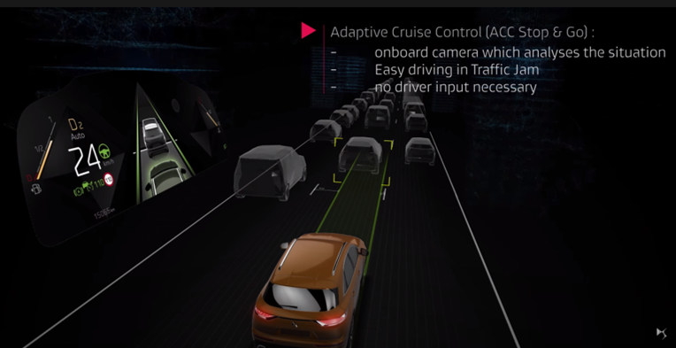

Automatic gearbox makes sense as the car can come to a complete stop with restarting in traffic jams.

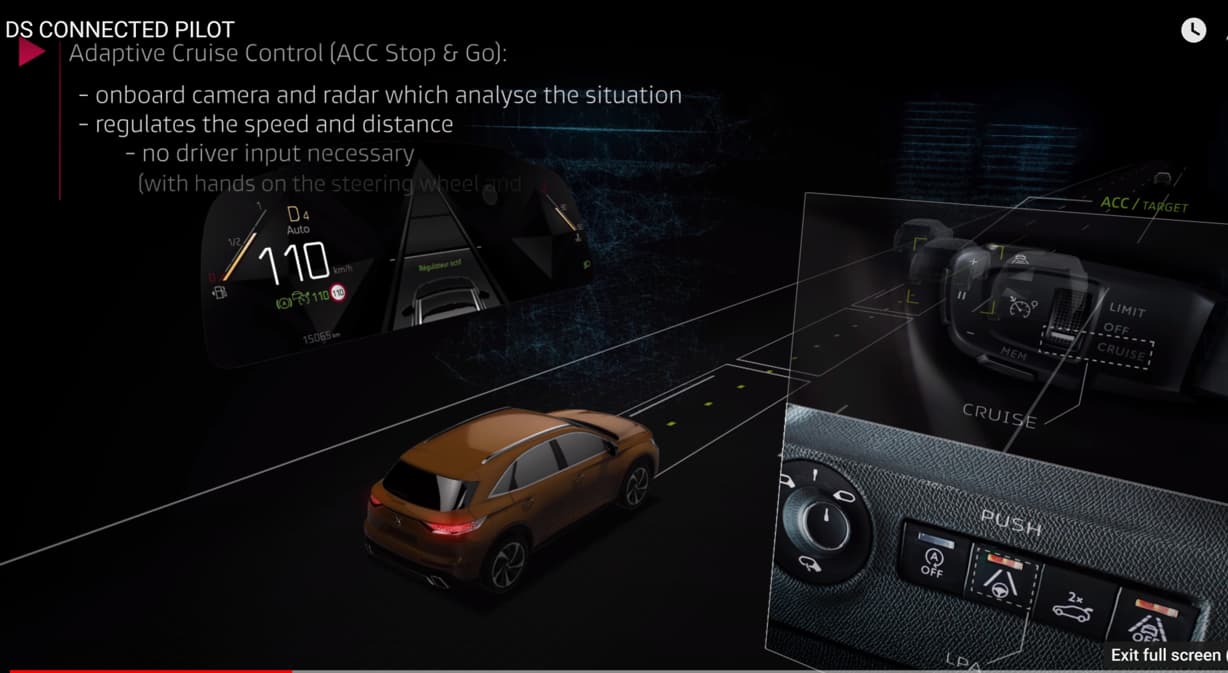

The DS Connected Pilot is linked to adaptive cruise adding the function LPA (Lane position assist) when activated simply press the Connected Pilot button and enable adaptive cruise, the car will then use autonomous driving level 2 to self steer and brake (you must keep hands on the steering wheel)
