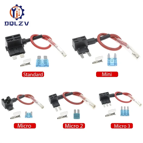

To get 12V for parking mode harness from the fuse box, these connectors are necessary (for DS4 type micro2 or micro3)

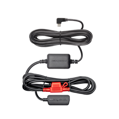

This is the hardwire kit for Nextbase cam.
It has a feature built in to switch off the camera if the cars 12v battery drops too low.

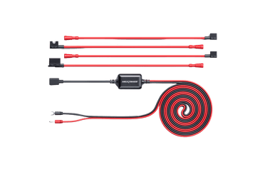

Series 2 Dash Cam Hardwire Kit | Nextbase UK
Not the same, because they shows for mini/standard fuses not micro2/micro3 as is in DS4
You won’t find a kit for the Micro2 or Micro3. You’ll need to purchase them separately.
update: this set has micro2 but it’s for “Nextbase Piqo”

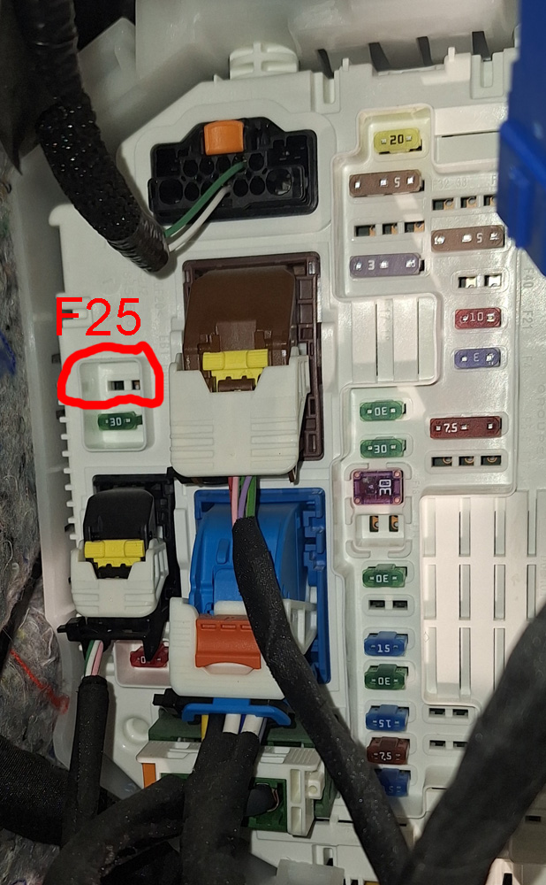

There’s one free fuse port F25 (micro2), which is probably powered by BAT+. If not, then F11 (occupied) and F15 (occupied) are nearby, but with this micro2 cable from AliExpress, that’s no problem.
Unfortunately, the fuse box is very tight.
