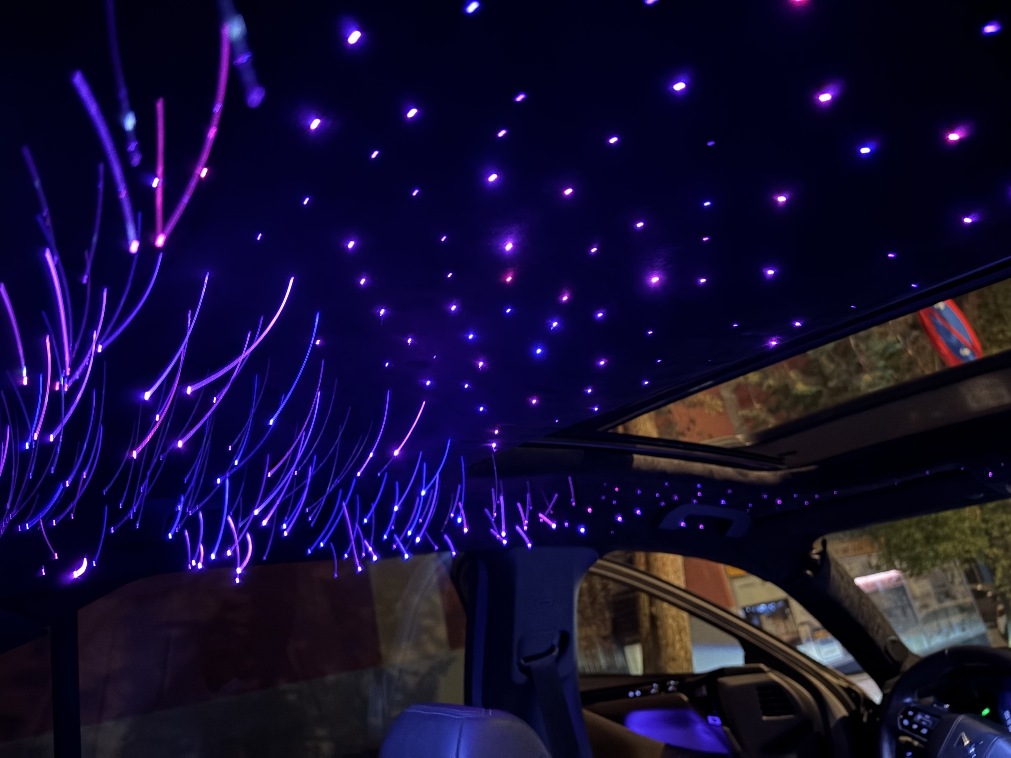

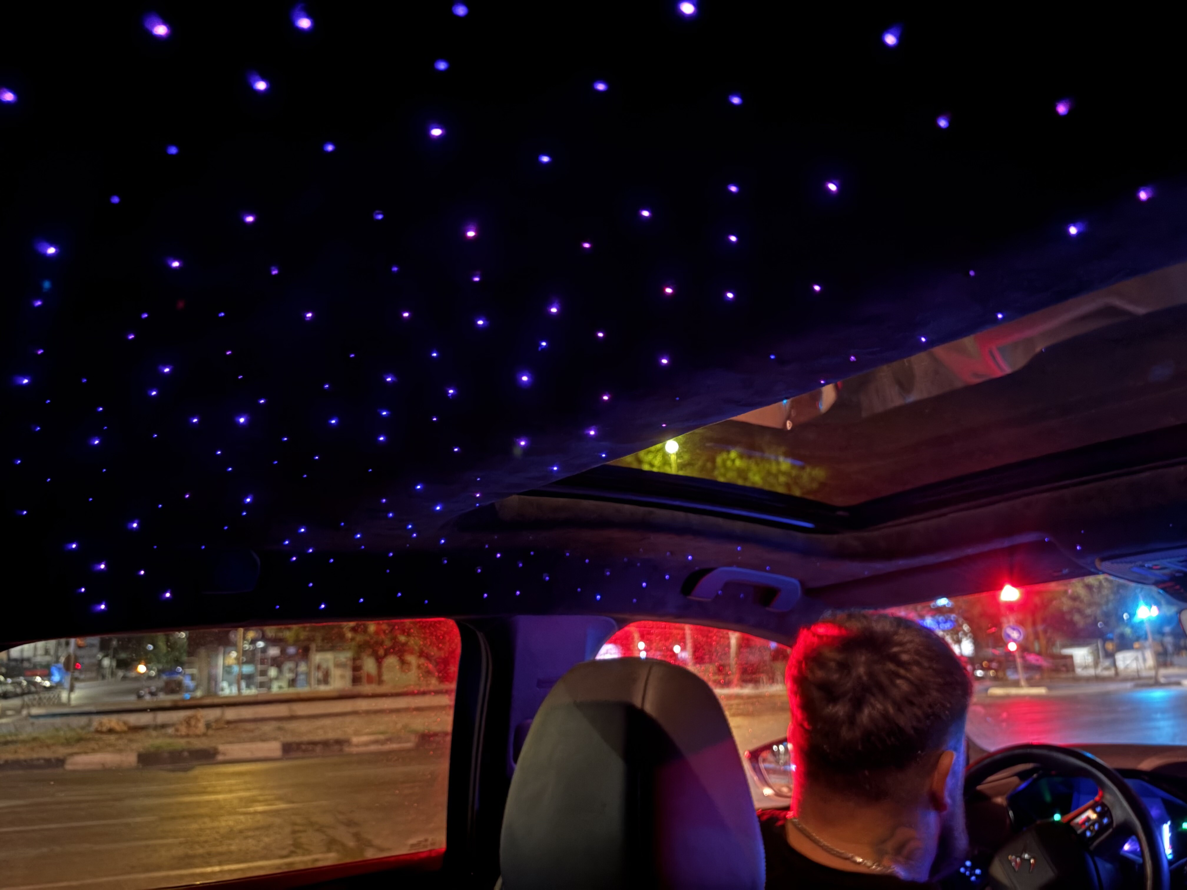

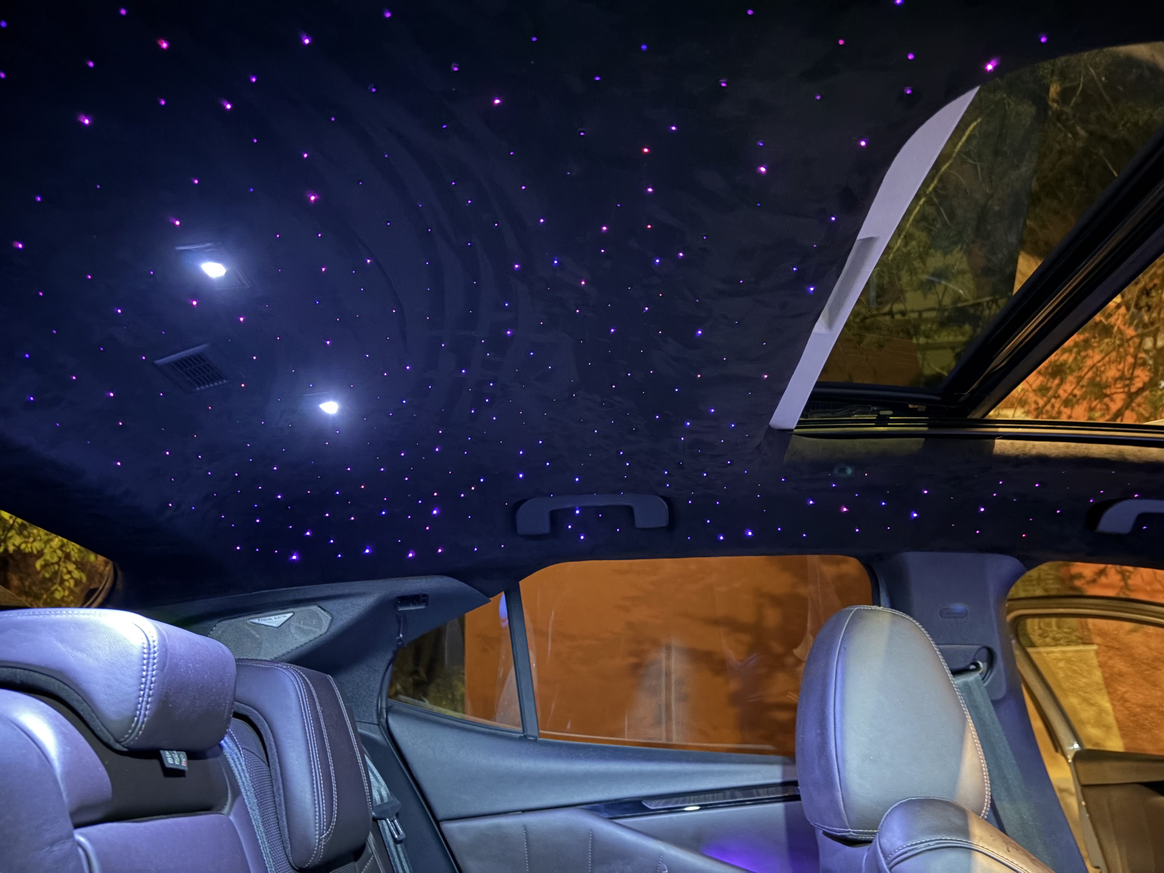

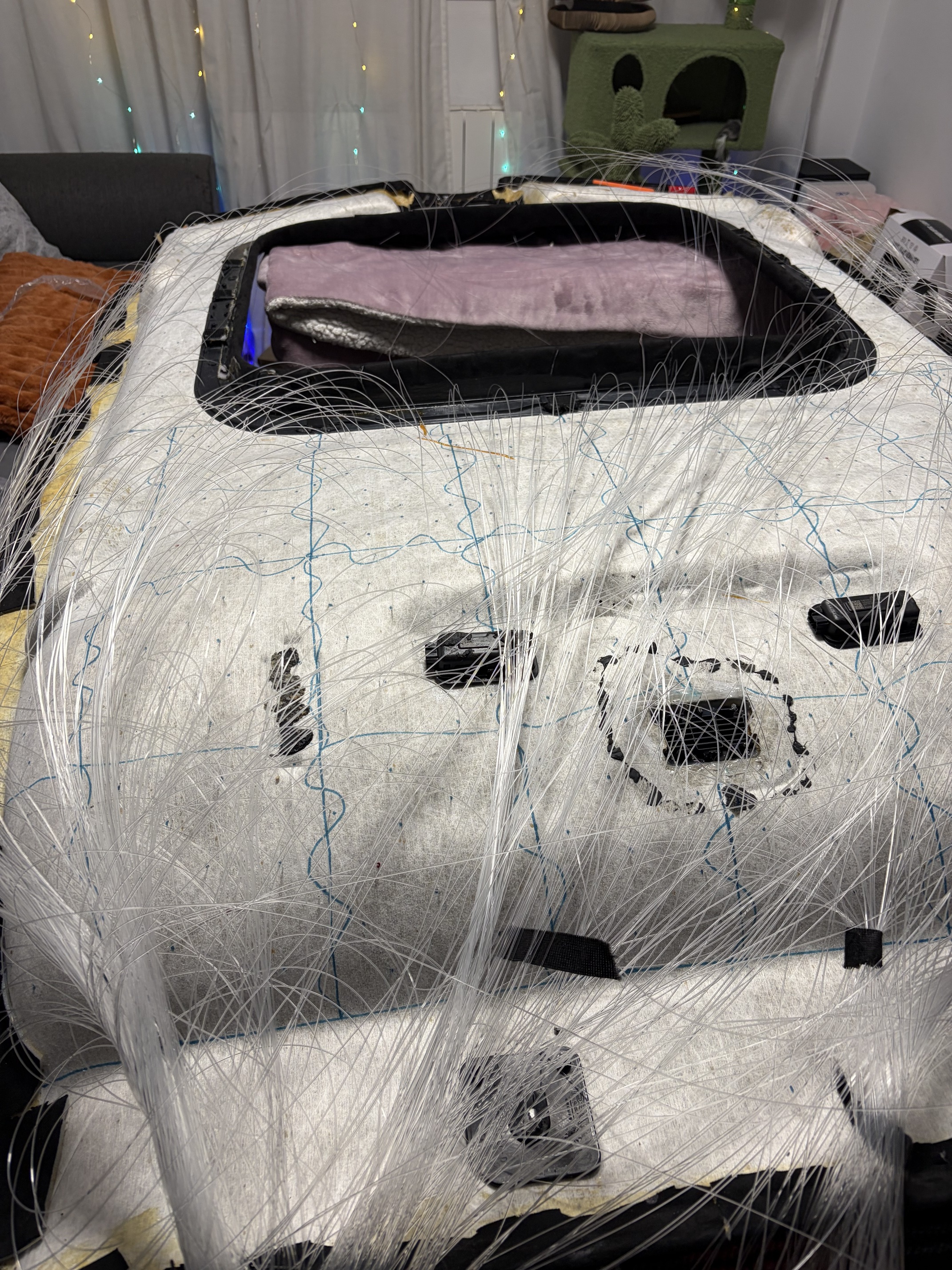

So I installed alcantara headliner with starlight :grin:

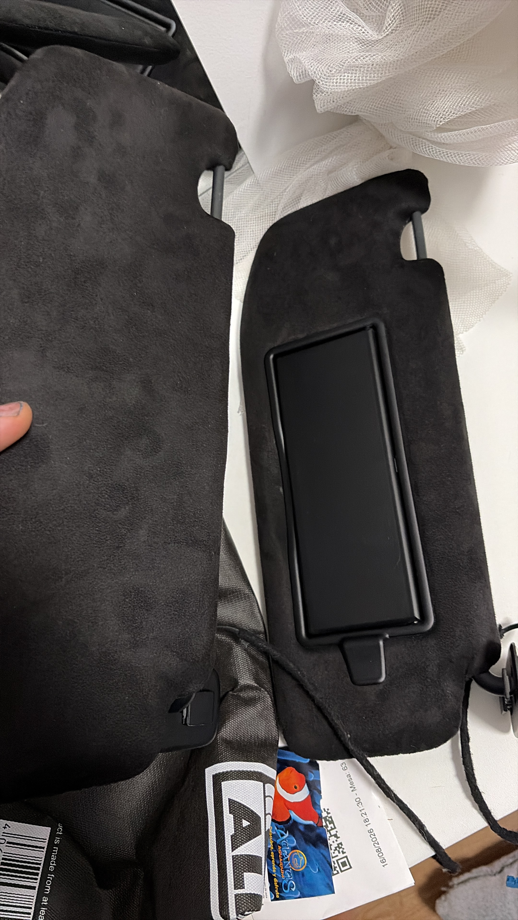

wrapped headliner, sunvisors, a pillars and painted everything black, I also changed front tweeters with hertz tweeters, I don’t like aluminium cone tweeters.
The only thing left to do is to remove the cealing shade, but with no info about how to remove it is a bit complicated, as for now i belive I have to remove the roof glass to be able to remove the cealing shade, take it out and paint it black with fabric paint and the plastic handle with mate paint
