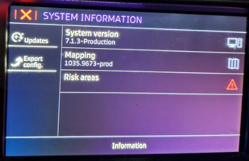

Hello, I am in process of upgrading the software in the car
VIN [VIN CENSORED]
System Version 7.1.3-Production
Where can I find older versions since the one downloaded by the DS Update gives “version not compatible with hardware”
Welcome @Tomas
You entered the system version incorrectly. For 2014 DS5 models, the audio system number always starts with the number 2… because it’s RT6/RNEG2.
