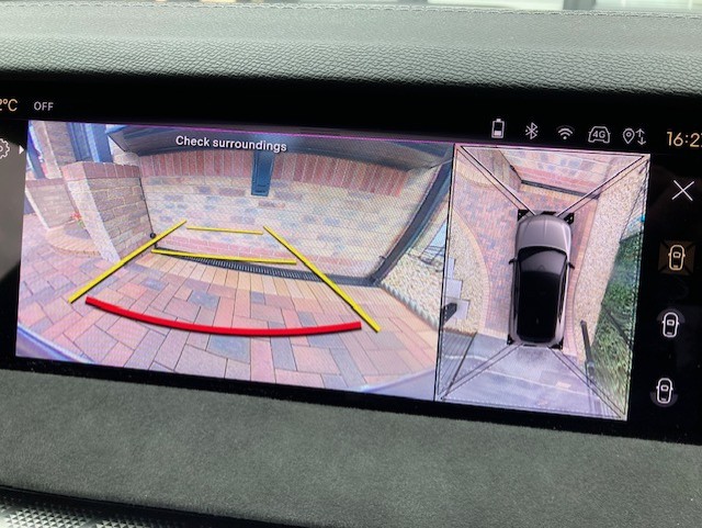

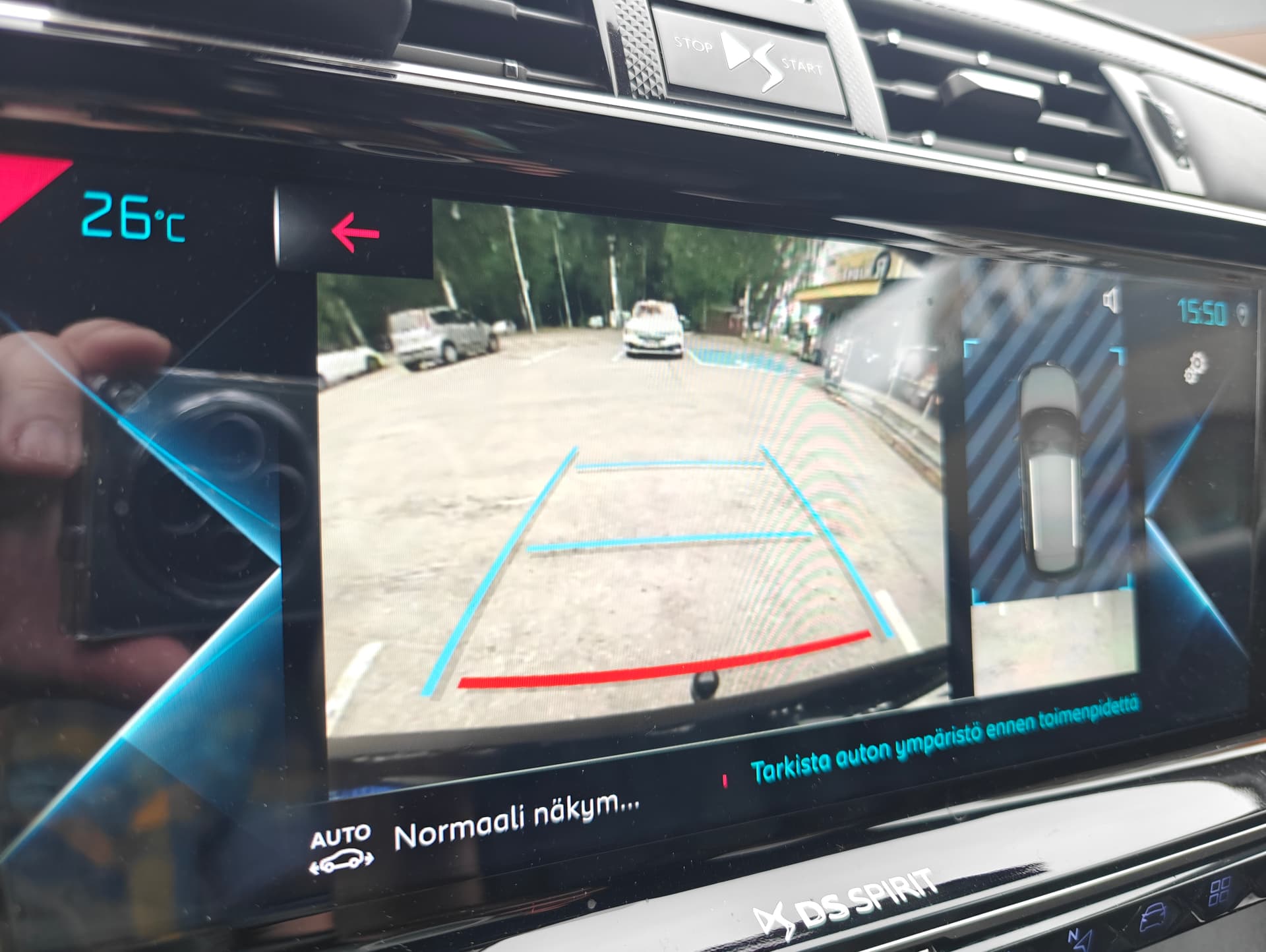

can you post an image to compare ?
This is what I can see.
Obviously this is a photo of an image , so in person its better and theres a setting to adjust contrast ect, but I’ve just left mine at the standard factory settings.

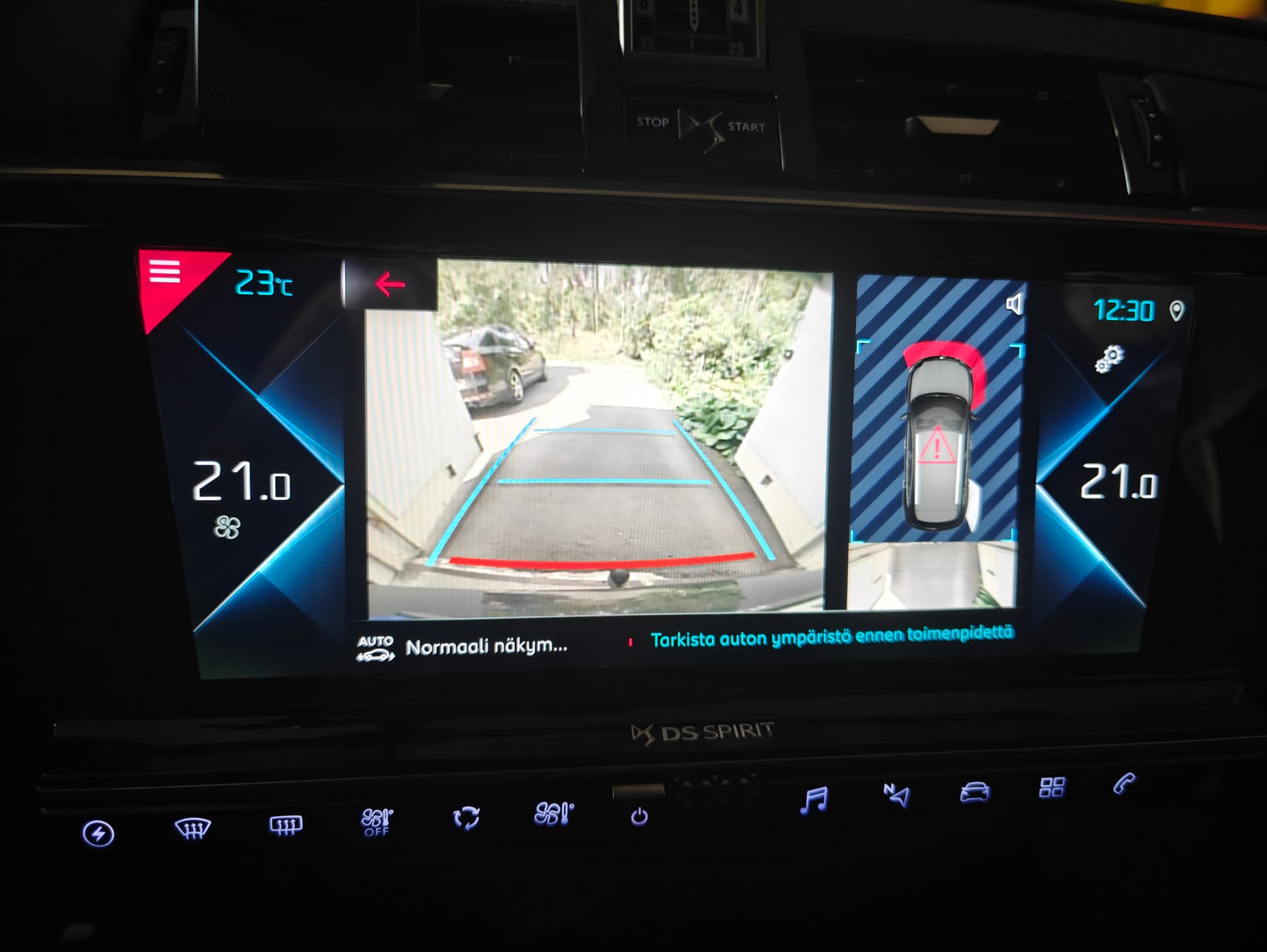

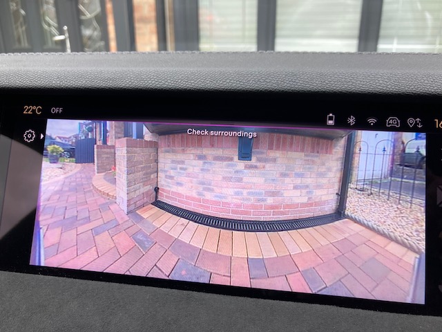

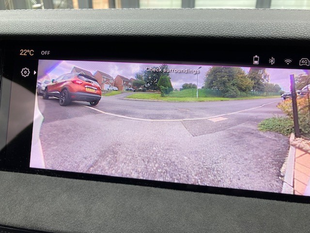

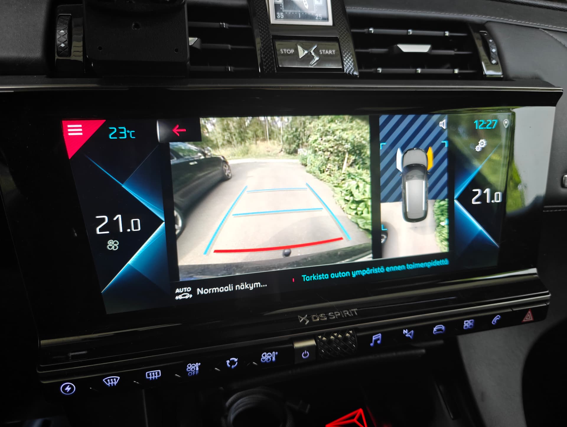

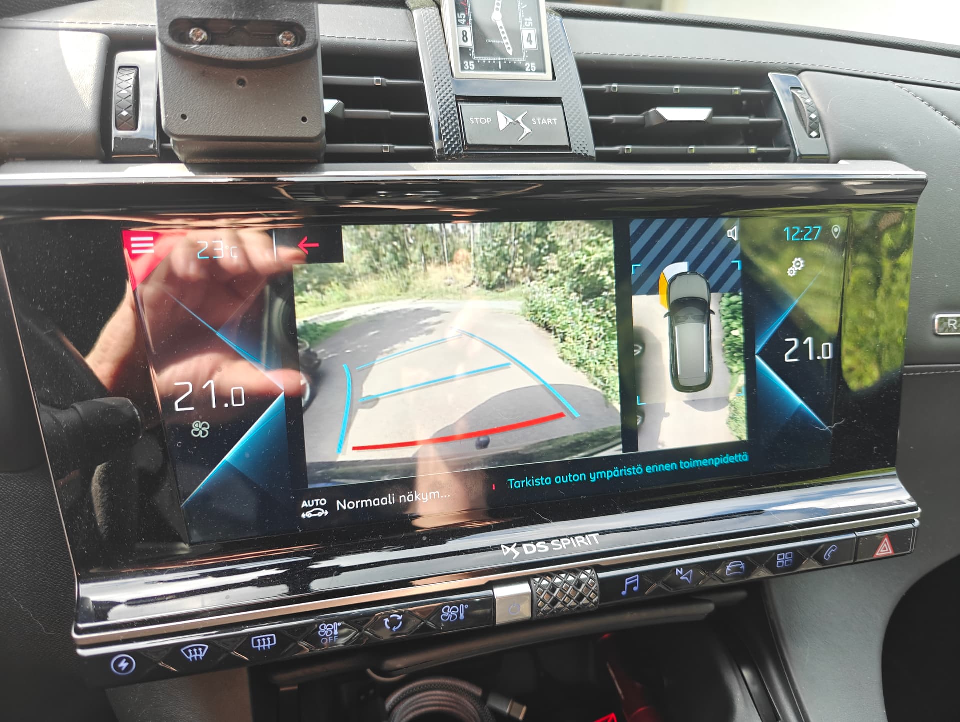

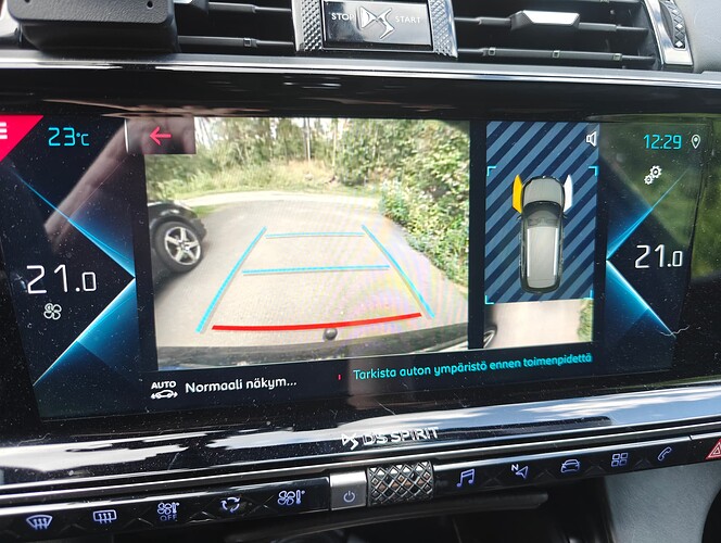

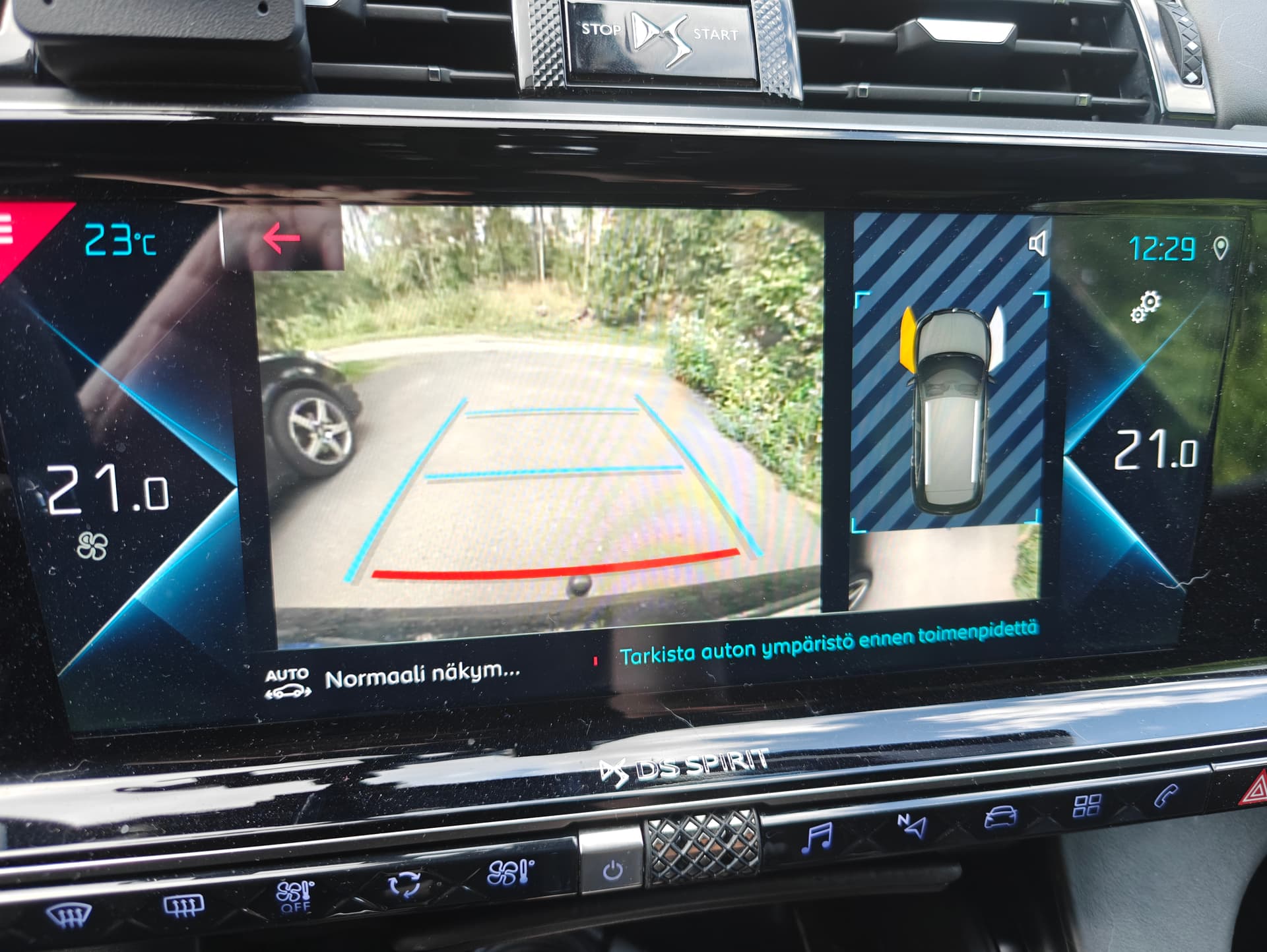

Here are a few low-quality reversing photos taken with a cell phone from my own yard. As someone said; I don’t think just changing the camera will improve the image quality much. So my car is a 2019 DS7 E-Tense.
I wouldnt say yours were that poor compared to some i’ve seen, maybe a little more blurry perhaps than mine.
The courtesy car i was driving last week was slightly better than mine but i havent tried changing any settings on mine s i dont know if i can improve the imge, but to be honest i’m ok with what it is at the moment.
