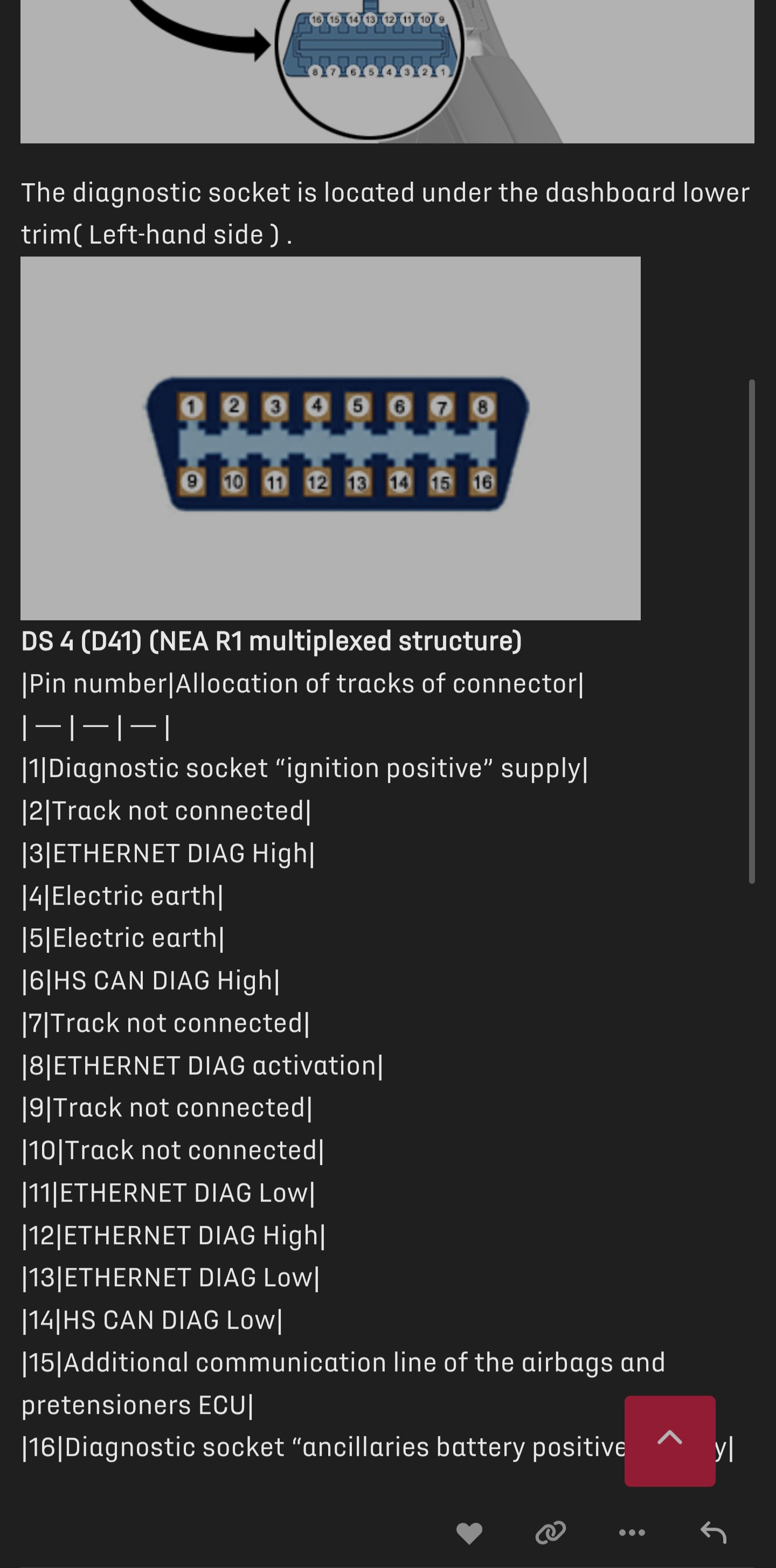

Hi guys. I want to install a 70 mai T800 camera with a 4g kit. How can I remove the protections from pillar A? Has anyone made hardwire on the obd port with a male obd plug to connect the cables to?
I myself performed a hardwire connection to some fuses to make my dashcam work, it sure sounds like the OBD solution would be a lot easier. Though I wonder if that port carries power when the car is turned off…
My post from a while back shows you what the inside of the A pillar looks like, should give you an idea of the way it’s mounted. Please do not break the speaker connector like I did :slight_smile:
I saw here that it has all three ports. Thank you!
