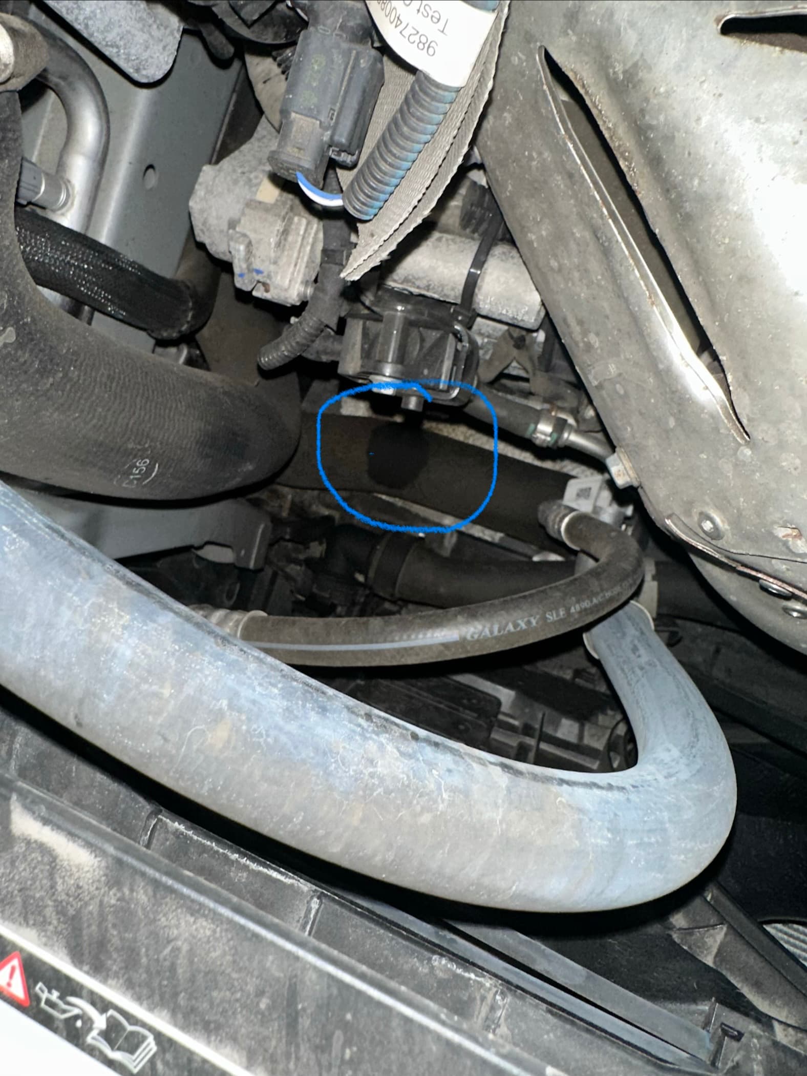

And what do you think about this wet spot on this black fat hose, what this could be?
I have no idea. Wash/clean it and see if it comes back.
I will do this definitely, thank you Andrew for the help!
