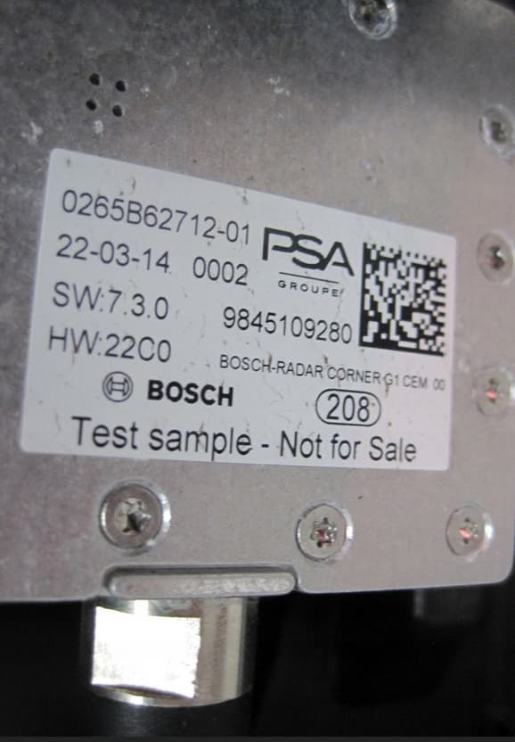

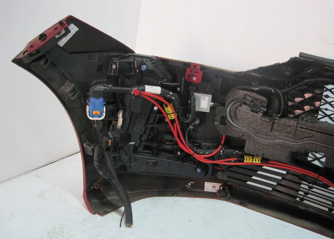

Let me put it another way: You fell for it, and that’s it. I don’t know of any instance where something like this was possible, because they tested DriveAssist 2.0 still in 2022. You can see that in the attachment. Front corner radars weren’t available in your model year because this system had not been developed yet.
To get it working for you, you’ll need to replace the front bumper harness and add two corner radars. Then you’ll need to reprogram the VSM and IVI_head_unit, which isn’t always possible. The IVI may need to be replaced after this procedure. Overall, I don’t recommend it.
This bumper is from a factory test car that was never sold. The release date on the radar is 2022. The visible red wires are for the reading sensors in testing Drive Assist 2.0. They are not found in a standard car.
