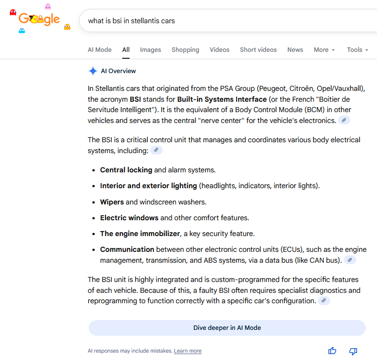

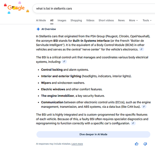

Still way over my head. :rofl:
Not my own work … but helps understand :grinning_face:
