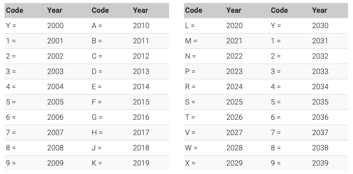

“NEW” cars can sometimes be sitting in compounds for up to 12 months, sometimes longer, waiting for a dealership to pull it from stock to sell onto a customer.
Ask your dealer to confirm the build date.
You can use this to confirm a build date, I had it off the dealership.
To confirm, use your chassis number 10th digit, which for my chassis number is the letter “P”.
That then is confirmed to be 2023 build.
Which can be found in this chart below.
By the code mine is a 24. I’m reasonably sure the indicators do flash with auto locking but I don’t know why i would be looking at the car while walking away.

The indicators do flash once when the car locks keyless.
Thats because its a 24 build.
