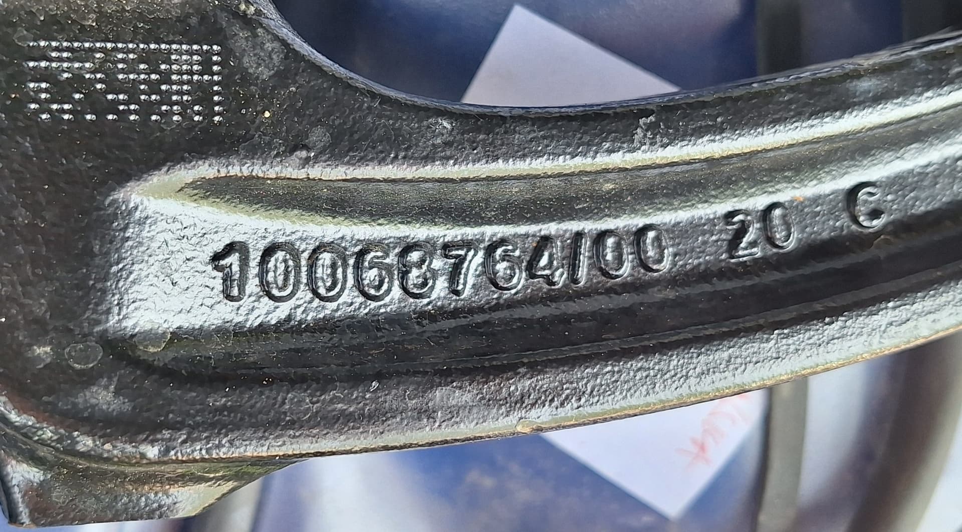

Hello. Does anyone have oem towbar on DS4? I found it on my car , but couldn’t find this part anywhere in the car.

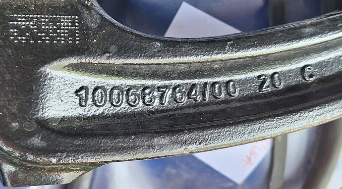

This is the only number on the swan: 10068764/00
Made by ORIS.
But this one propably only in E-Tense. Petrol/diesel may have different
I have towbar on my 2022 DS4 E-Tense - I think it is OEM/dealer fitted, but was already on the car when I bought it. I have a short paper manual for it and it is Oris AK41 Detachable Tow Ball. Is there anything specific you want me to take photo of ?
1669671280 is a towbar in cars excluding PHEV hybrid. PHEV Swan on my photo may not fit but fit

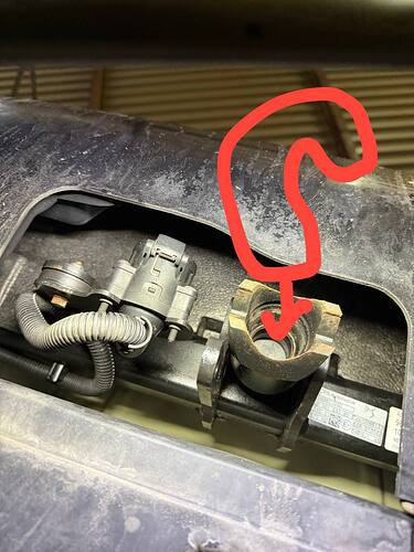

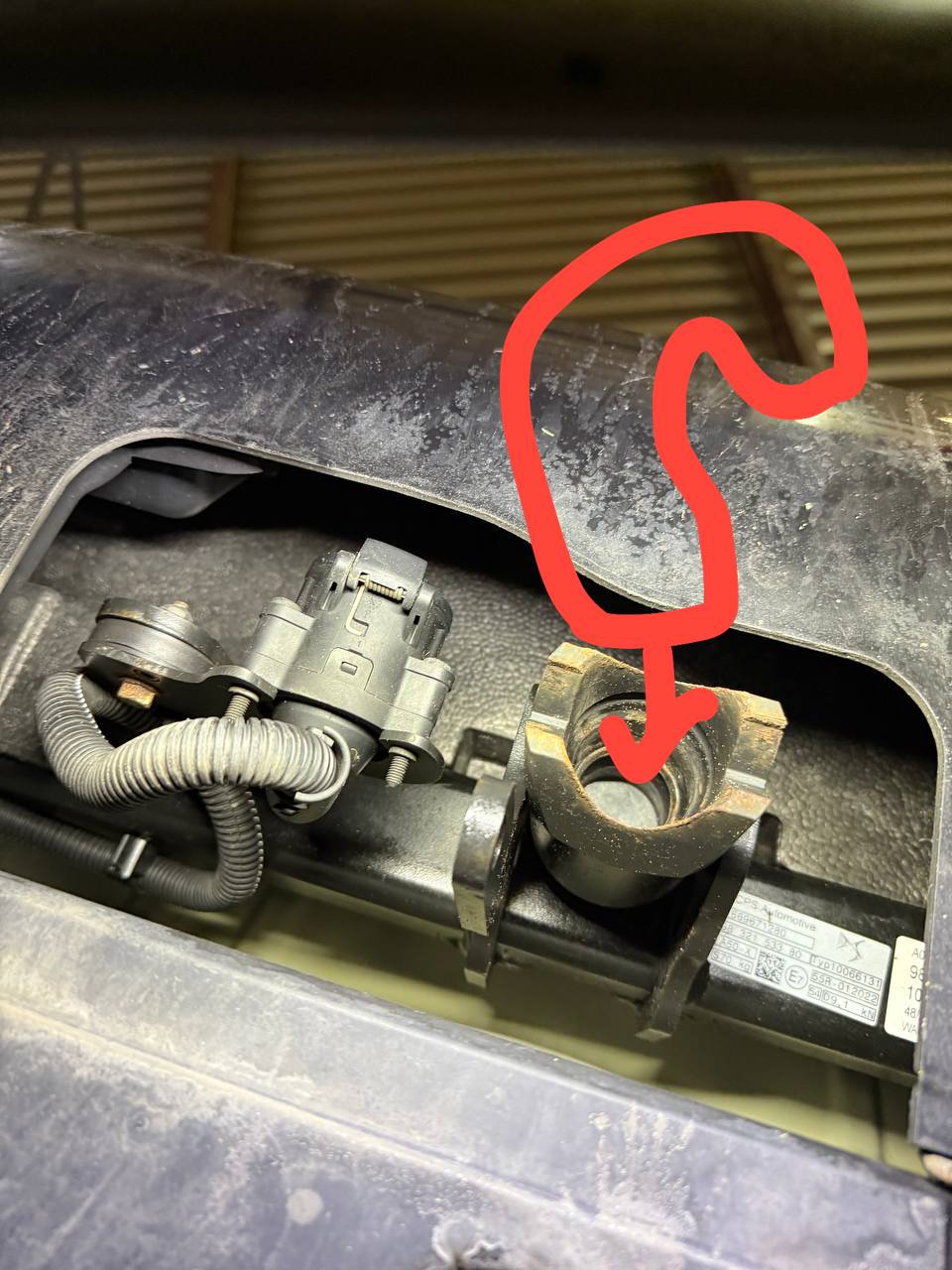

it looks like i need this one…
You already have it, just without the swan neck. So you have 2/3 of the whole these piece.
1669671280 that’s the whole towbar and you’re only missing the ball/swan neck - removable part of that towbar.
A new swan neck costs 150-250 EUR, not 550 as here whole towbar.
You can also search for used ORIS swan neck (but only with a key) from cars:
@haiko - sorry if this is obvious, but have you looked under the liftable floor in the boot, just in case the detachable hook has been put in there. The car must have had one at some point. Or contact previous owner if you can.
i was trying to find it there. Nothing.

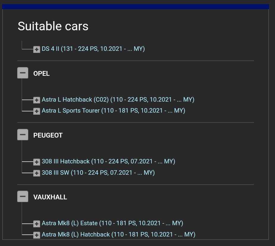

Try here, I think they have shipping options to multiple countries.
https://rrr.lt/en/used-part/kof661-10068764-peugeot-308-tow-bar-set
I don’t know where you live, but if you search for 10068764 you’ll find some options.
DE 10068764/00 KUGELKOPF ORIS ANHÄNGERKUPPLUNG in Baden-Württemberg - Beimerstetten | Ersatz- & Reparaturteile kaufen | kleinanzeigen.de
DE NEU - ORIS AK41 Anhängerkupplung Kugelkopf 2 Schlüssel in Bayern - Karlsfeld | Ersatz- & Reparaturteile kaufen | kleinanzeigen.de
CR 10068764, vuÄŤna kuka kula kulka PEUGEOT 308 T10 III 10068764 novi

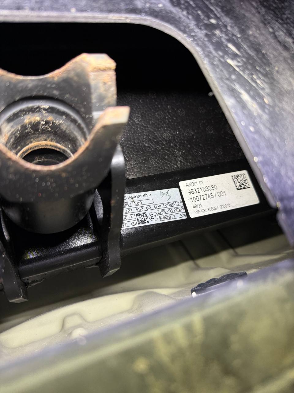

10072745 correct code. Thanks 4 helping. I wrote to dealership where i bought a car. Hope to get answer soon.
If we’re going that way, mine is 10073244 /001 (sticker on the beam) but in real life it’s 10068764/00
Found 10068764 tow bar and it fit well, Thanks 4 help :victory_hand:
