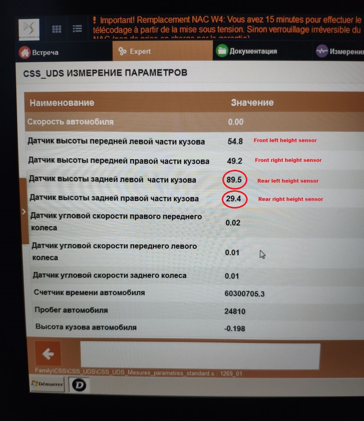

Great and crazy work i think to begin to make this :slight_smile: . I have one question. DS7 with active scan suspention have problems with rear axle (jump to right when go with bad way or manhole covers) . So, DS have TSB B3BW0132Q0 : Version 3 and change rear shock absorbers and suspension arms . My changed with waranty, but still no success. I see parameters from Diagbox CSS module and see big differences in rear height sensors. If posible to share parameters from you car to see if is OK? I see that rear sensors right and left is different and may be work different, but this differences for me is not normal. Thanks!

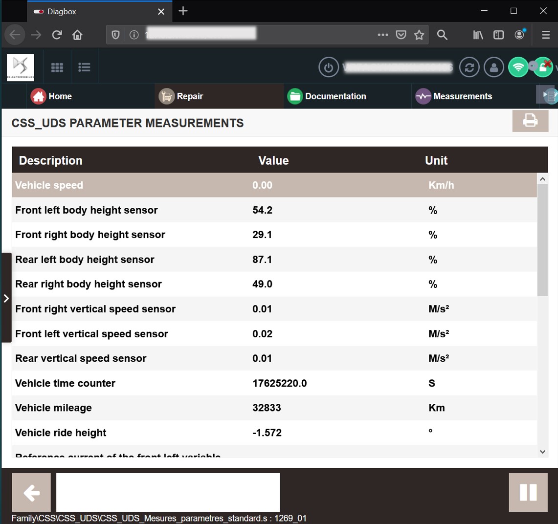

HI Kokovi4
Please see image of my parameters.
