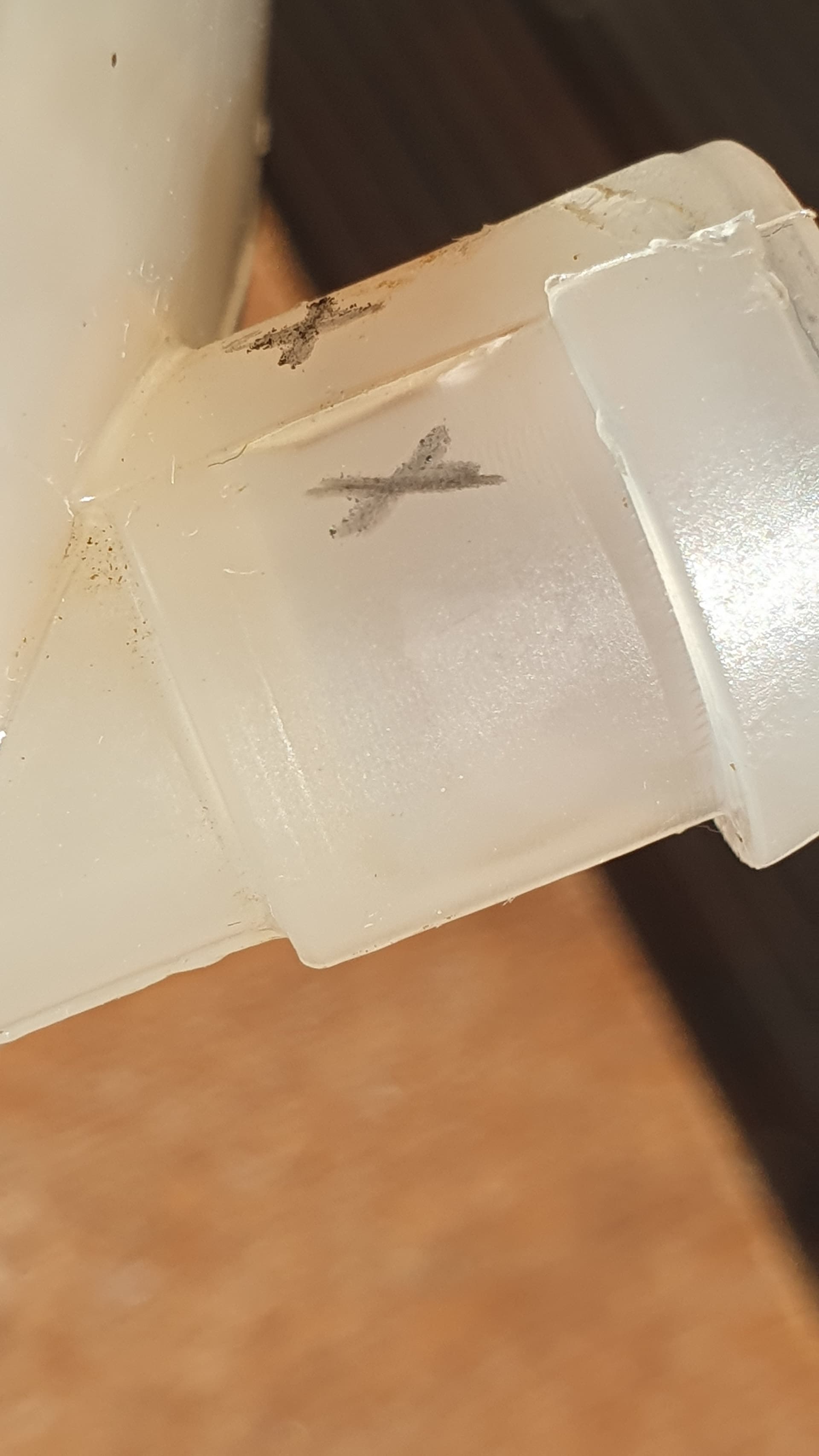

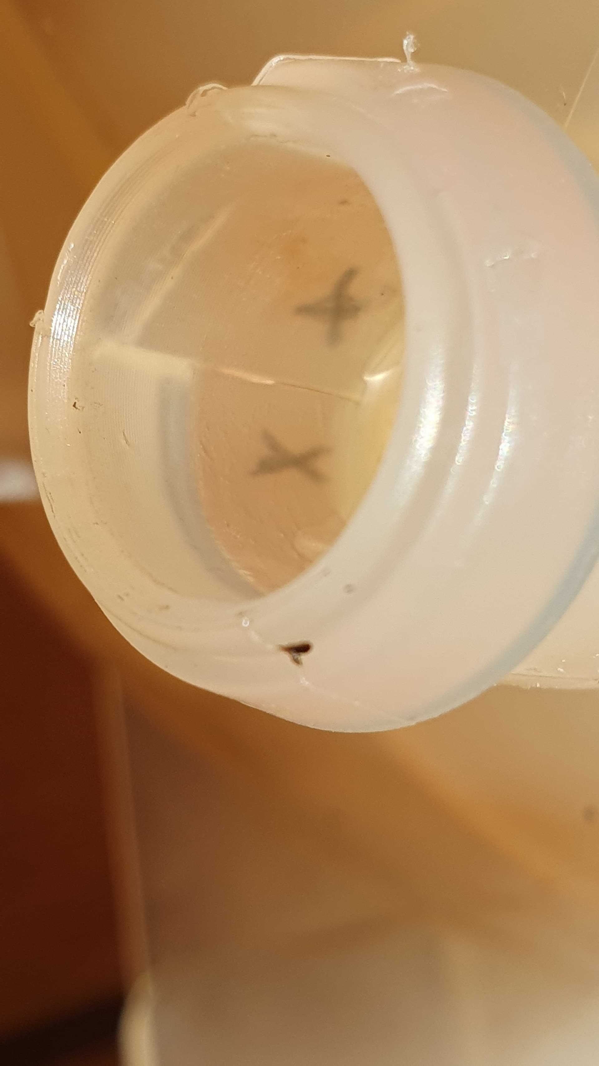

Hi Andrew, you were right about the tank maybe defective
An almost invisible crack along the seam of the lower small spigot. The hose clip oring would be just the wrong side of it and I didn’t want to risk it becoming worse, so new tank it is.
