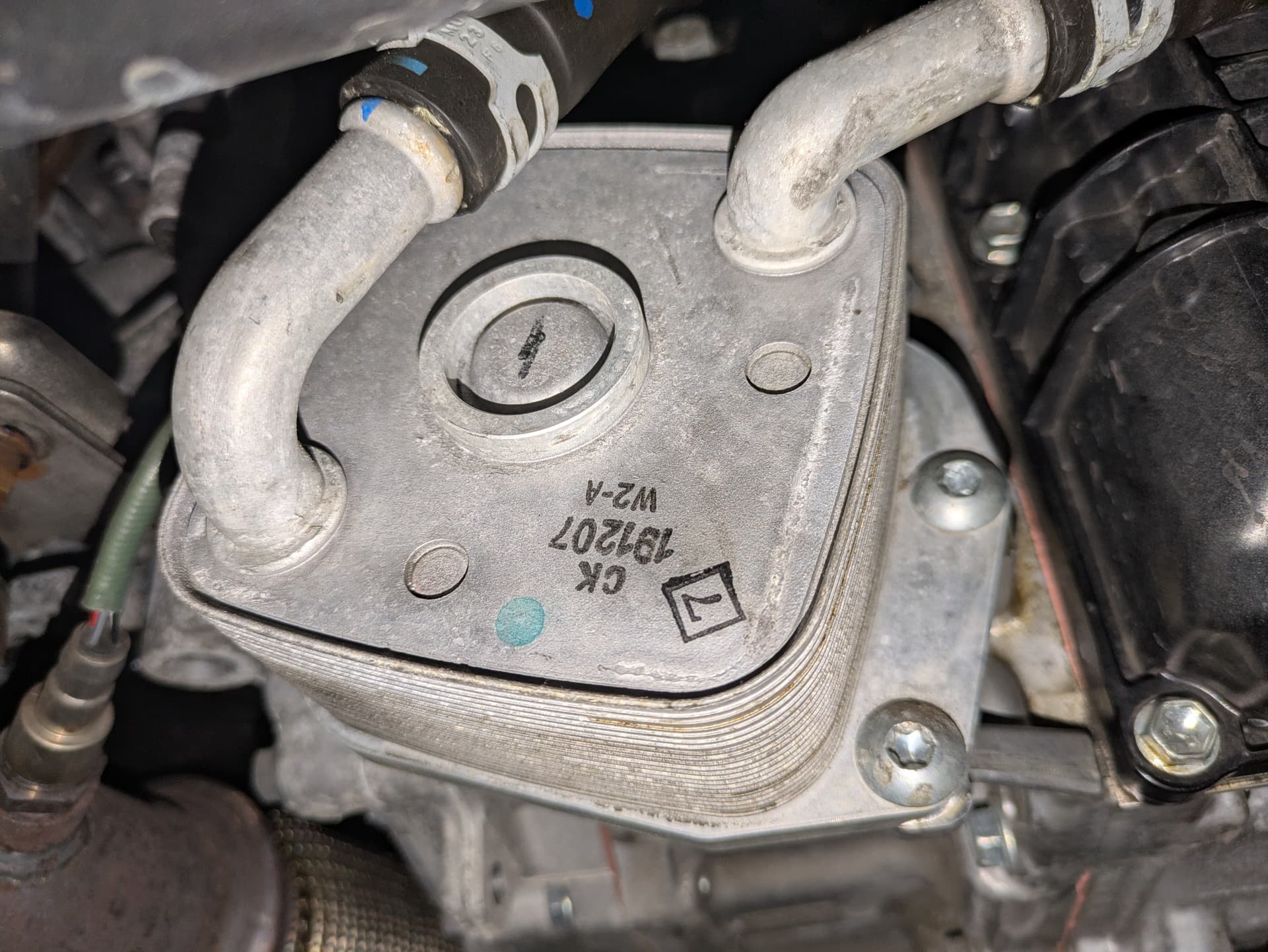

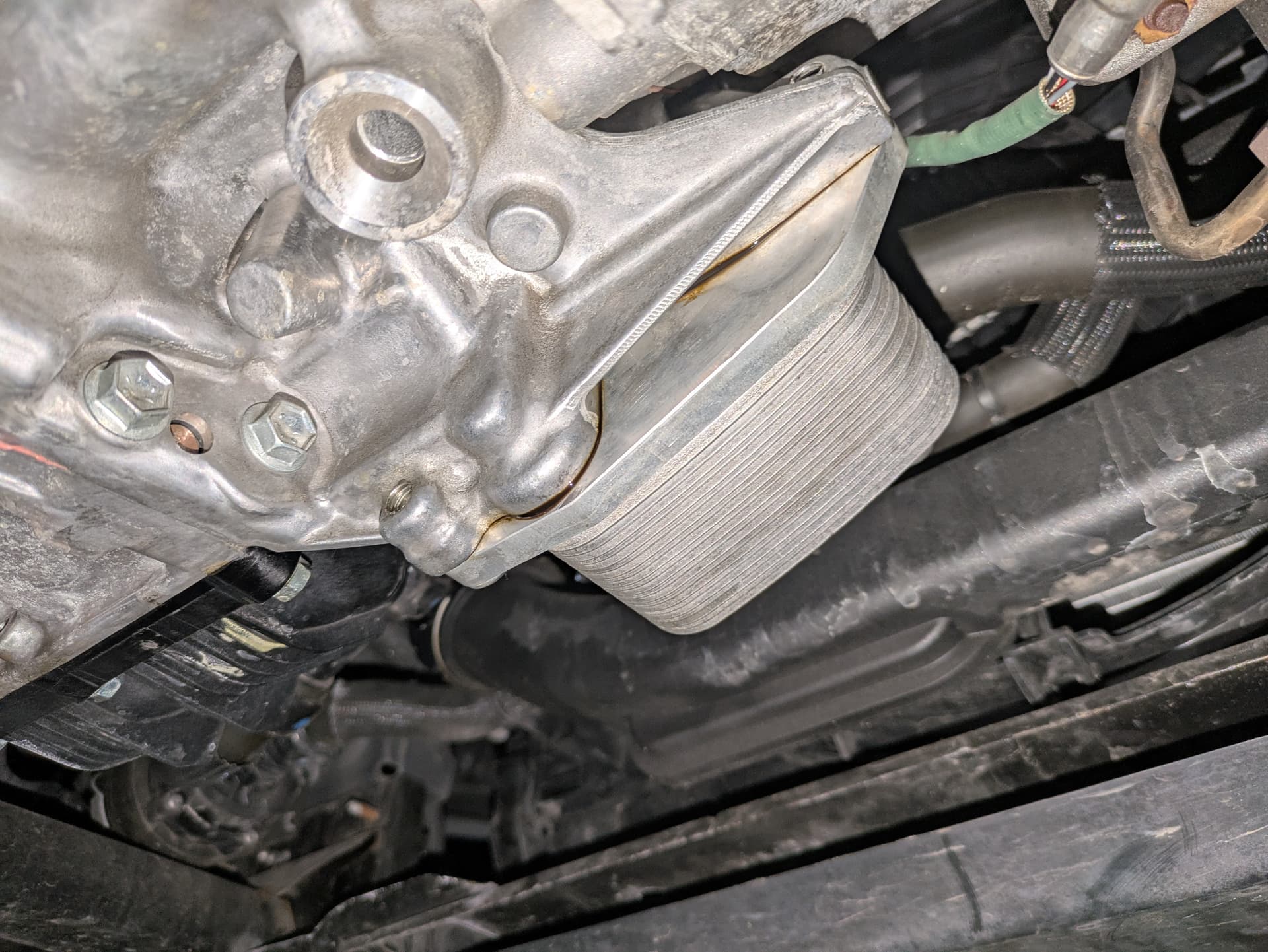

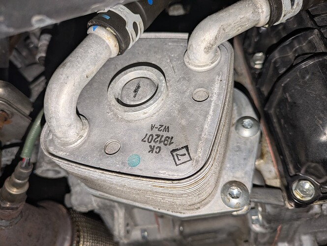

Last week I’ve been changing engine oil, and then I saw that probably the oil cooler gasket on gearbox is broken- the gearbox fluid/oil is running out.
Can you check for me this part Number VIA catalogue (gasket/seal)?
Last 8digits of VIN is LY056791
DS7 crossback 2021 1.6 e-tense 224KM J4DGZU
Hello.
I don’t want to give the wrong advice, but I had the same problem during an oil change. When the oil filter was replaced, the oil leaked onto the radiator of the gearbox. Try cleaning it with a solvent and see if it still leaks.
Ionut.
Thank for your advice. I’ve tried but that’s not the problem.
It’s OE 1654982580. Price 300+ EUR.
