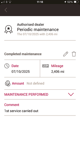

Are you all finding your service records on the myds app? My DS7 was supposedly serviced before I bought it and the dealer claims to have done the 2yr service but not provided paperwork for either servive and they are not on the app. The dealer is not returning emails or calls. The app is not woking at all today even after a re-install.
The app only offers theoretical suggested dates based on time/mileage or memorized data that you have to enter manually or previous suggestions that have expired and are saved as omitted.

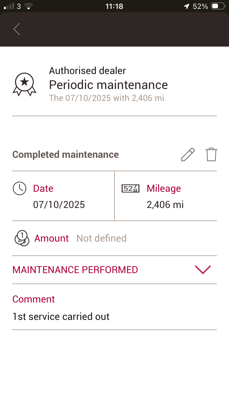

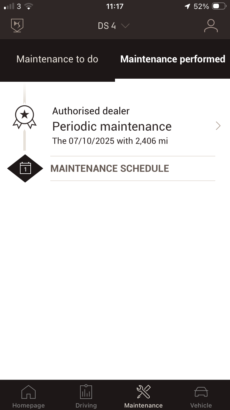

Your dealership has to update the service record on the app from their end.
Once they do that you’ll see t on the app with a rosette type image saying something like “Dealer Authorised Service” in the “maintenance carried out” part of the app.

I’m 2nd owner, both services were carried out so far were by Franchised dealers, and records of both services are not on my app. I was told when I had the 2nd service that I best keep hold of the receipt as they didn’t have access to the servers! So it may be the app data is only up dated by main dealers and not franchised.
I have now entered the data manually, quoting, what was done, when, by who and a reciept no., this data seems stored on the server as i have changed phones since entering it.
I also found a service book under the tyre inflator, and have subsequently been back to the dealer for a wet stamp.:grin:

Apparently once the dealership has uploaded the service info to the app they cant amend it.
For instance they have the incorrect mileage showing for mine, it should of been 1830 miles @ that date, they also failed to list all the parts replaced, yet on the paper work they supplied it show’s everything.
The app says cabin filter changed, yet the paper work says cabin filter, oil, oil filter, sump seal ring, screen wash.
