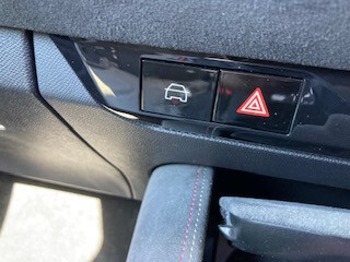

  5. My front camera can be operated manually if needed by pressing the button that has a picture of a car on it, i’ll try to get a pic. I can have the camera on even if not moving. It obviously comes on automatically as well when manoeuvring.

This is my interior, i have button with car only on multimedia diplay but after that i need to open fron view thru the menu.
I will check this about user profiles

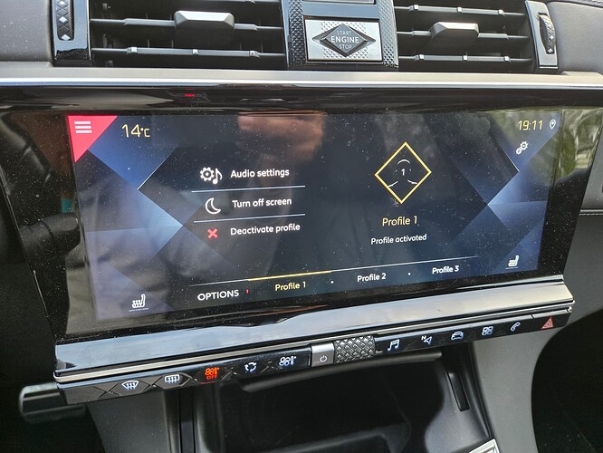

And this is user profiles screen.
I tried ambient light, seats and mirrors configurstion between profiles, but only noticable change is audio.

  2. As suggested, amb lighting should be one thing, but also the custom settings for the driver display behind the wheel.

Doesn’t look like you can set ambient lighting for separate profiles, which is odd ?
Each user profile in my car can have separate:
Audio Sounds
Saved radio stations
Ambient lighting
Mirror angles
Dash displays
Locking/unlocking of doors & boot on approaching the car
