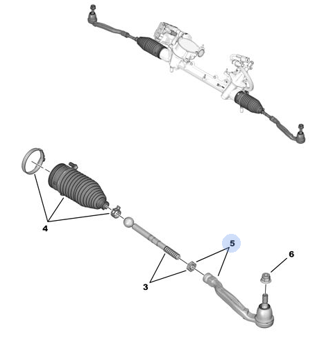

Hello everyone. I hear this kind of sound only when turning the steering wheel to the left. It doesn’t happen all the time. It doesn’t occur when I start the car while the engine is cold. Does anyone have any ideas?

Hello, replace the part number 5 in the picture on both sides and you will get rid of the problem. After replacing those parts, don’t forget to adjust the steering.
Hello. Thank you for your reply. Should I ask my parts dealer for the right tie rod end and the left tie rod end?
Yes, on both sides
