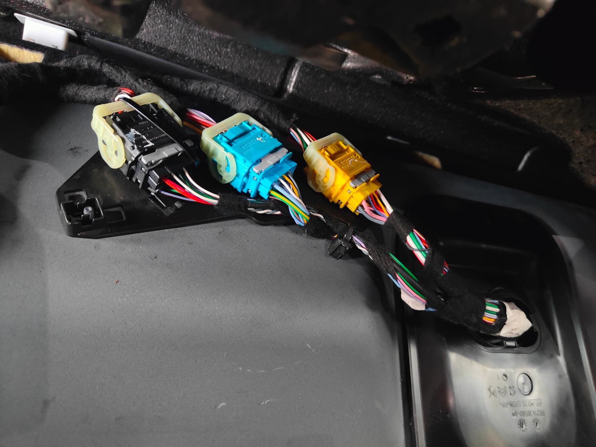

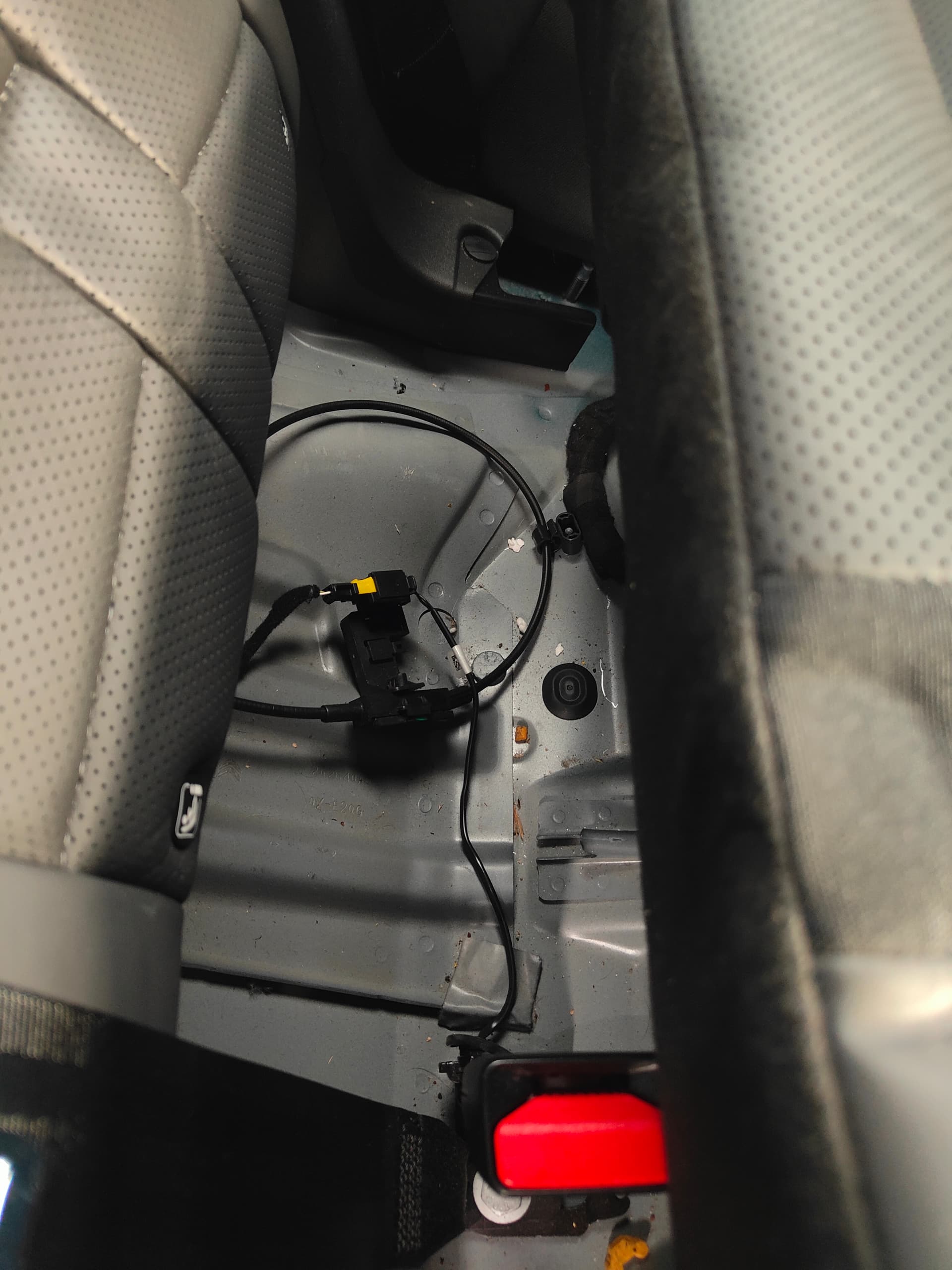

If everything works but the car does not start, sometimes it does and sometimes it does not. The wiring for the rear engine is under the rear seat. There are also plugs under the car, at the back, these can be damaged. New cable is very expensive and a lot of work because the electric motor at the back has to be dismantled. Also the coolant of this etc.
But I would first investigate whether all this wiring is still good.
Car does not start for safety reasons to prevent damage.

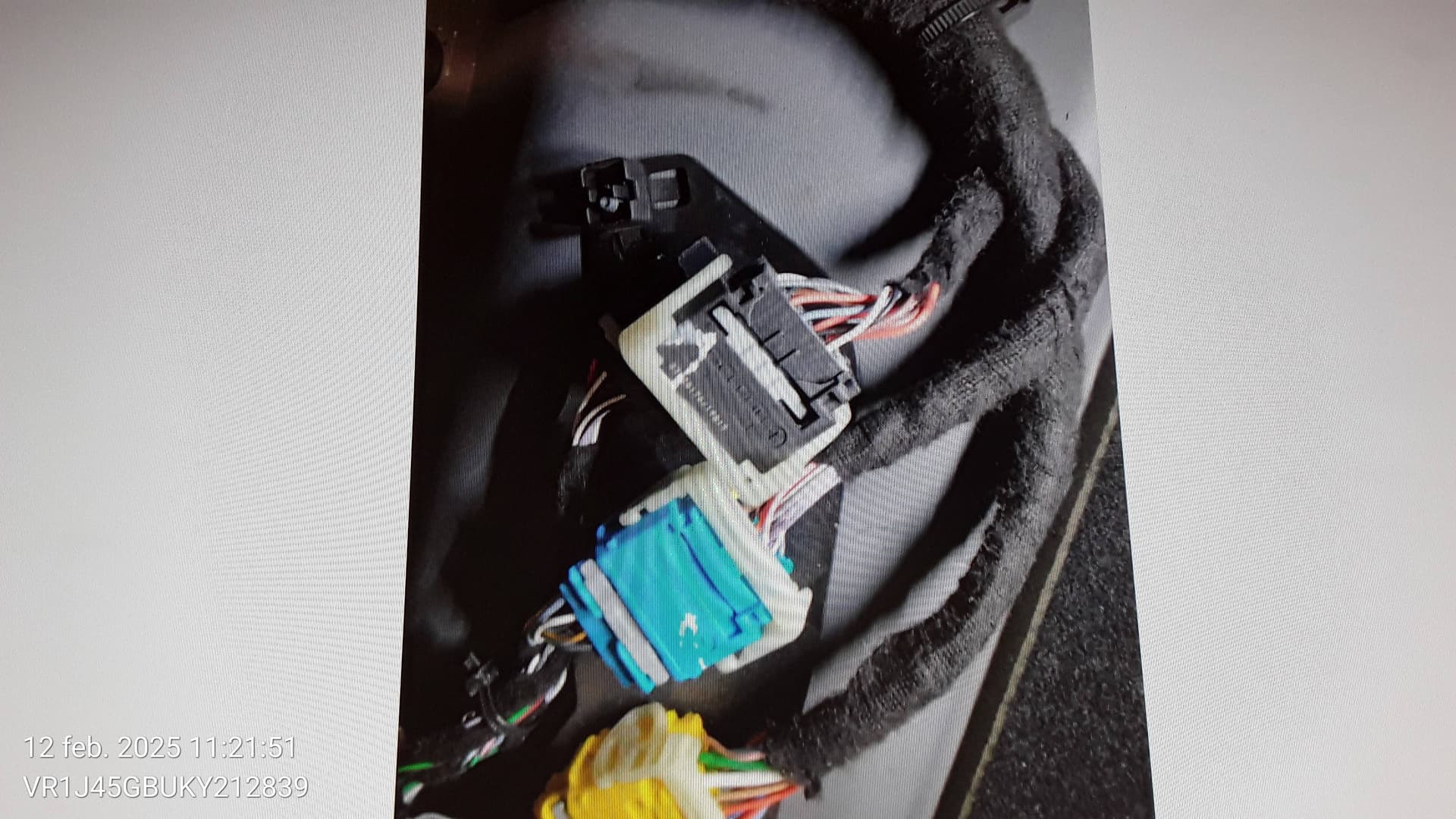

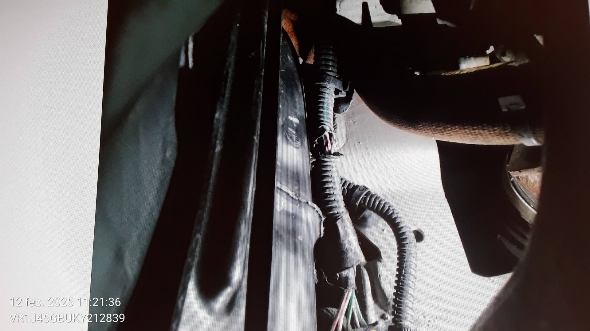

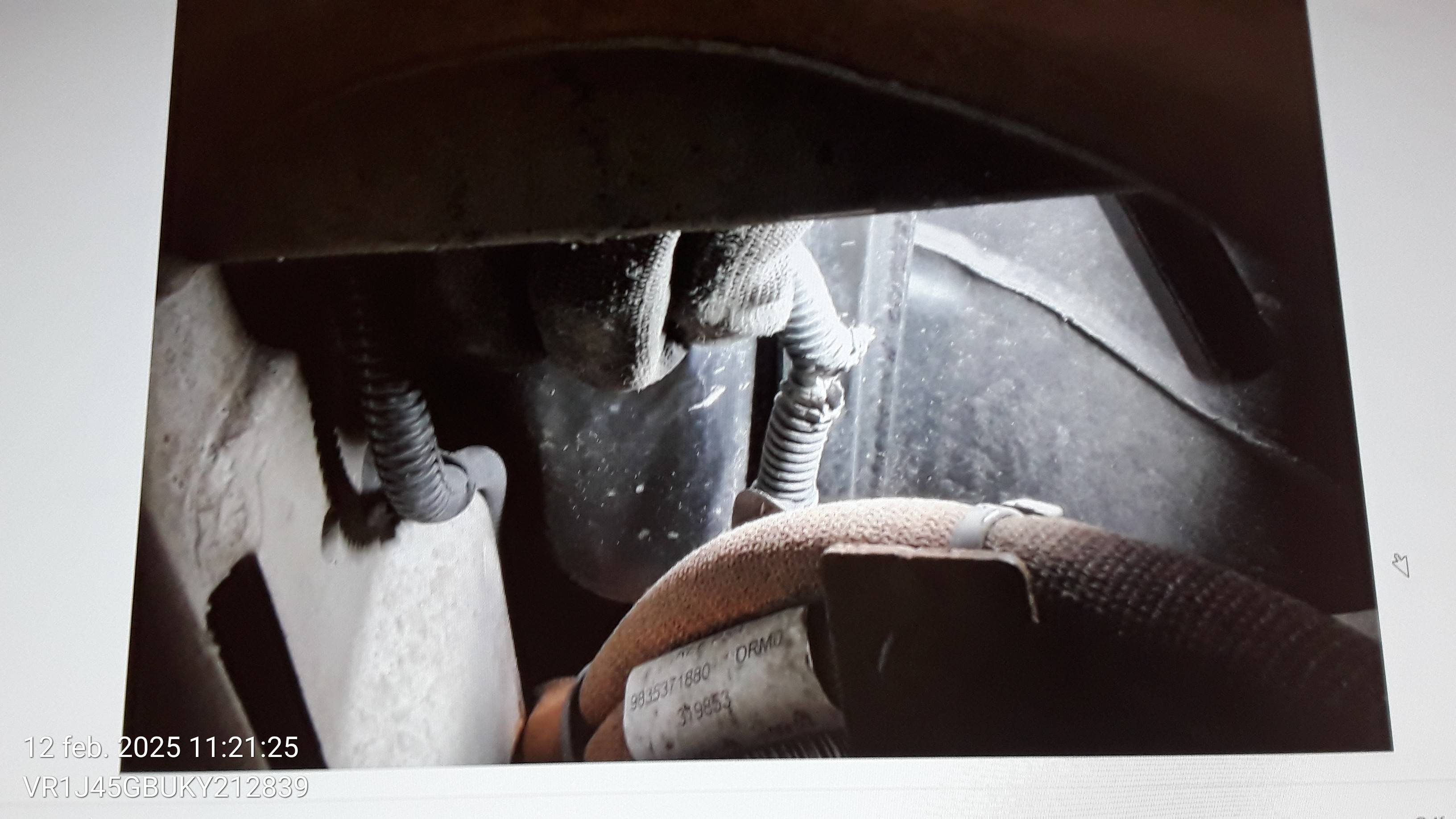

My car sometimes started and sometimes didn’t. It was difficult for the dealer to find, but after consulting a head electrician from Ds, the mechanic had to check this wiring. It turned out to be damaged in several places. Also, a number of plugs were no longer good. This could also have been caused by corrosion.
Hopefully this helps you.
