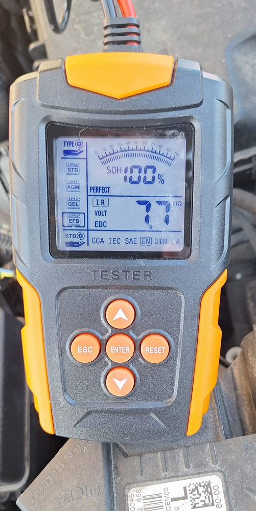

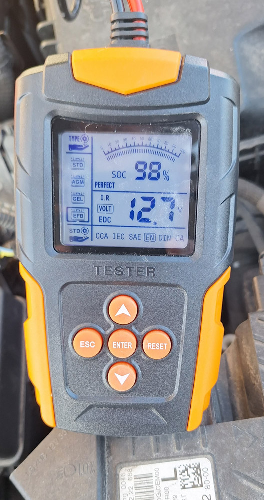

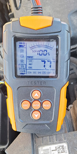

Good point - what should I be getting as a reading before starting to know if it is fully charged - it is a Varta AGM battery
12,8V SOH 100%, SOC 100%, internal resistance ab. 6-8 mOHM
I had 12.6v on my meter before starting so I guess I should top it up with a charger. Is it ok to do this with the battery connected?
It’s ok. But plug charger to 230V grid minimum after 1 hour from locking the car.
