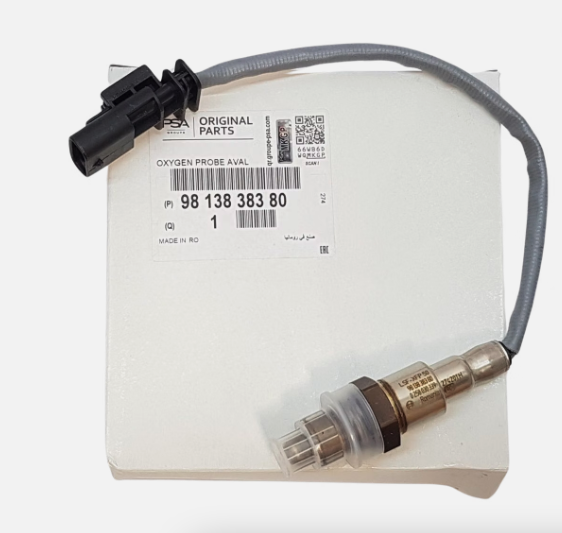

Just used a code reading to see if the car has logged the error and it found P2271 which I believe is something to do with the oxygen sensor ?
the light has gone off now but I’ll still mention it when the car goes in for its service.
Yeah, I have the exact same error as we speak. I also had it in december last time but it disappeared by itself 2-3 weeks later. I’m expecting it to do that again soon.
Heated oxygen sensor (HO2S) 2
bank 1 - signal stuck rich
Yeah Jay thats it.
Also known as a Lambda sensor.
Apparently known to fail on older Vauxhalls.
I was wondering if it’s down to low mileage ?
I think its the sensor that screws into the exhaust, and measures the Oxygen Fuel mix in the exhaust fumes ?

Don’t look to Google or AI for the answer, because a lambda sensor failure is unlikely in a low-mileage car. Problems with these sensors typically start after 60,000 miles.
So what is likely in a low-mileage car?
Bad petrol?
I’m currently at 45,000 km—so just under 30,000 miles. To me, that’s low mileage. And considering that I cover most of that distance in Electric mode, the mileage on the ICE is actually very low.
I’m at 64.000 km, but I think I wasn’t clear enough in my question.
You said a lambda sensor failure is unlikely in a low mileage car, and my question was if a lambda sensor failure is unlikely, what is then more likely to be the issue?
I don’t know. You need to read all the error codes. It’s too complicated to simply give an answer here.
That was the only code showing.
It came on when I switched from comfort mode to sport mode during driving, it then stayed on for 2 or 3 days no matter what mode the car was in .
I then put the car in sport mode and drove harder than I normally would for a day or two, the light then went off and has stayed off.
I’m thinking the sensor might of pick up a bit a crude initially and and perhaps burnt off when I drove the car in sport mode for a few days ?
Either way, thats the only code showing .
I’ve left it on there so the dealer can see it when it goes in for its service.
There is likely too much air in the fuel mixture. The first step is to check the air intake for leaks.
You could also check the lambda sensor wiring, as a rodent might have been in that area.

So bit of an update.
The car went in yesterday for its annual service, ideal time to check out the error code that came on a few weeks ago for a couple of days but not since.
Anyway, long story short.
They are replacing the probe under warranty.
Apparently there’s been a number of cases in the UK where this part is failing even on lower mileage cars like mine.
Error code showing is P2271
