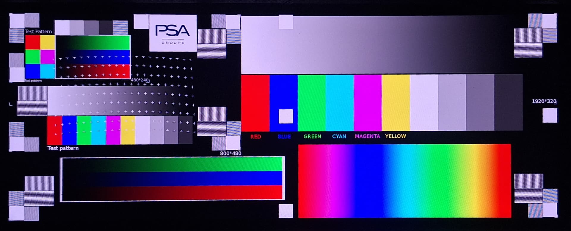

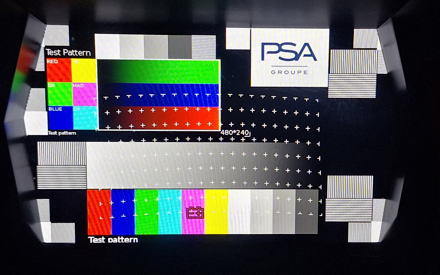

IVI_head_unit controls the counter and headup display, so if the IVI has a fault on the LVDS line (video), the counter and HUD will be black.
As a curiosity Test Pattern in odo and ivi
Even the defrosting of rear view mirrors stops working when the head unit doenst work ![]()
As I’ve been told theres probably a damaged component or solderpoint, thats why the problem reveals itself sometimes when there’s sudden temperature shifts between + and - , high humidity etc.
Is that from your car @Andrew_PL ?
Yep…
