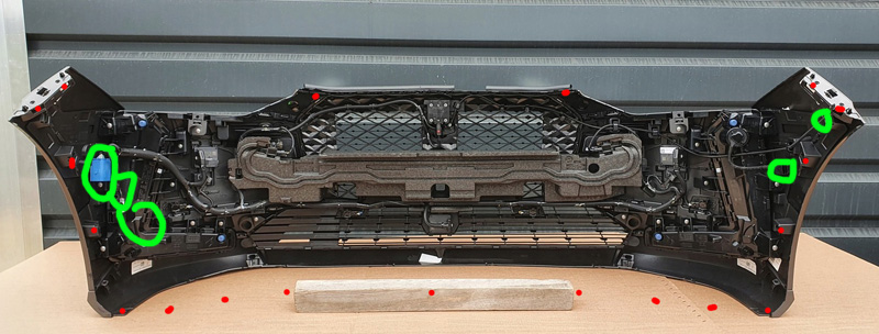

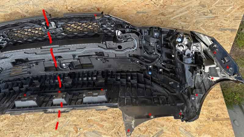

The entire bumper needs to be removed. The lower engine cover and partial wheel arches (from the front) need to be removed.
Then, in the wheel arches, you need to unscrew the four bolts (10mm wrench) between the fenders and the bumper, and disconnect the four bumper wiring harnesses and the camera washer pipe.

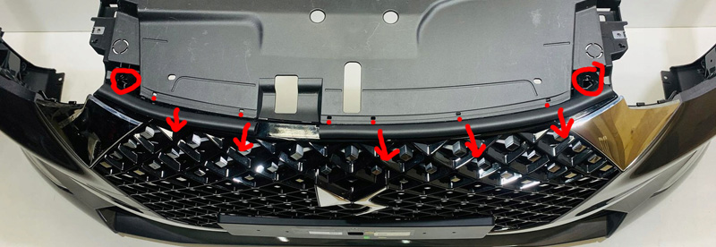

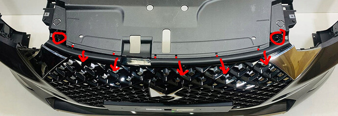

From the top (near the headlights), unscrew the two small Torx screws and separate the bumper/grill from the lock cover.
If you’ve never done this before, I recommend a specialist.
