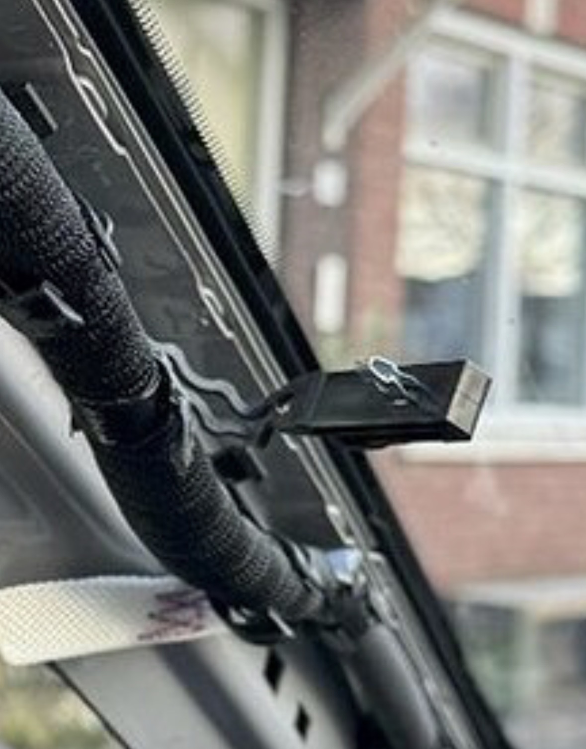

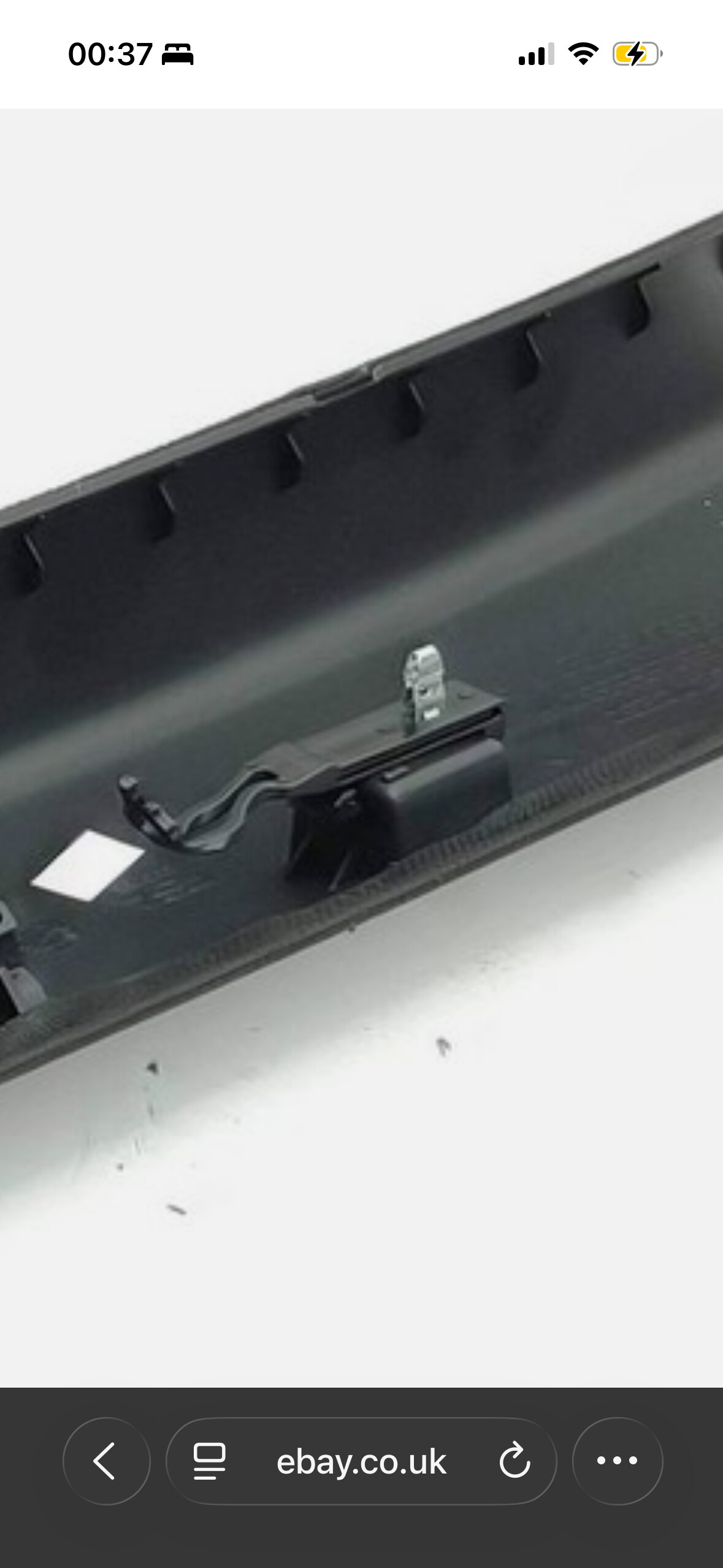

Please see the pic I found in the forum, for reference.

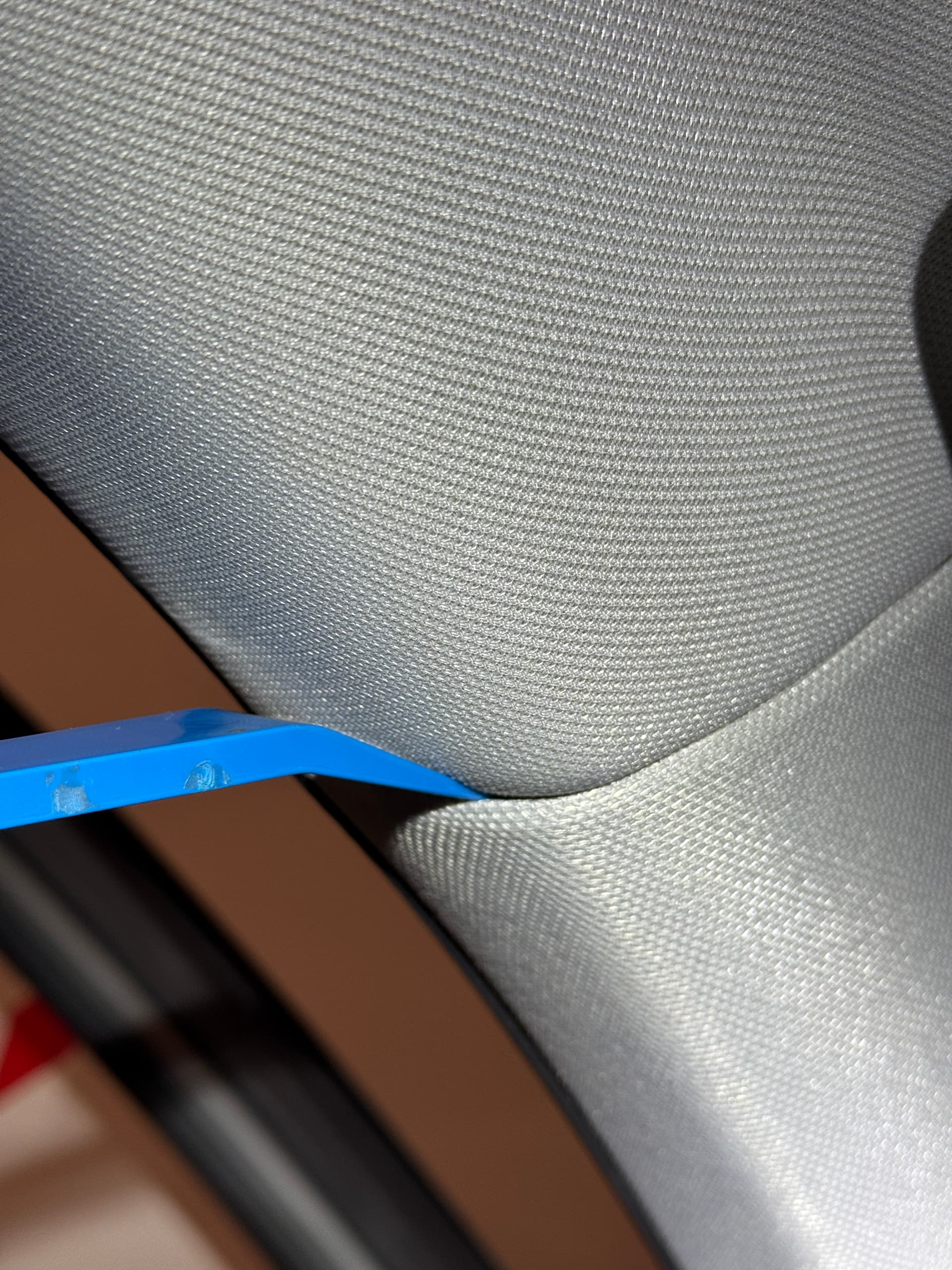

2- Use a lever to lift the A pillar cover near the roof.
3- Apply a little force and release the first plastic clip, pulling the plastic A pillar panel toward the passenger compartment.

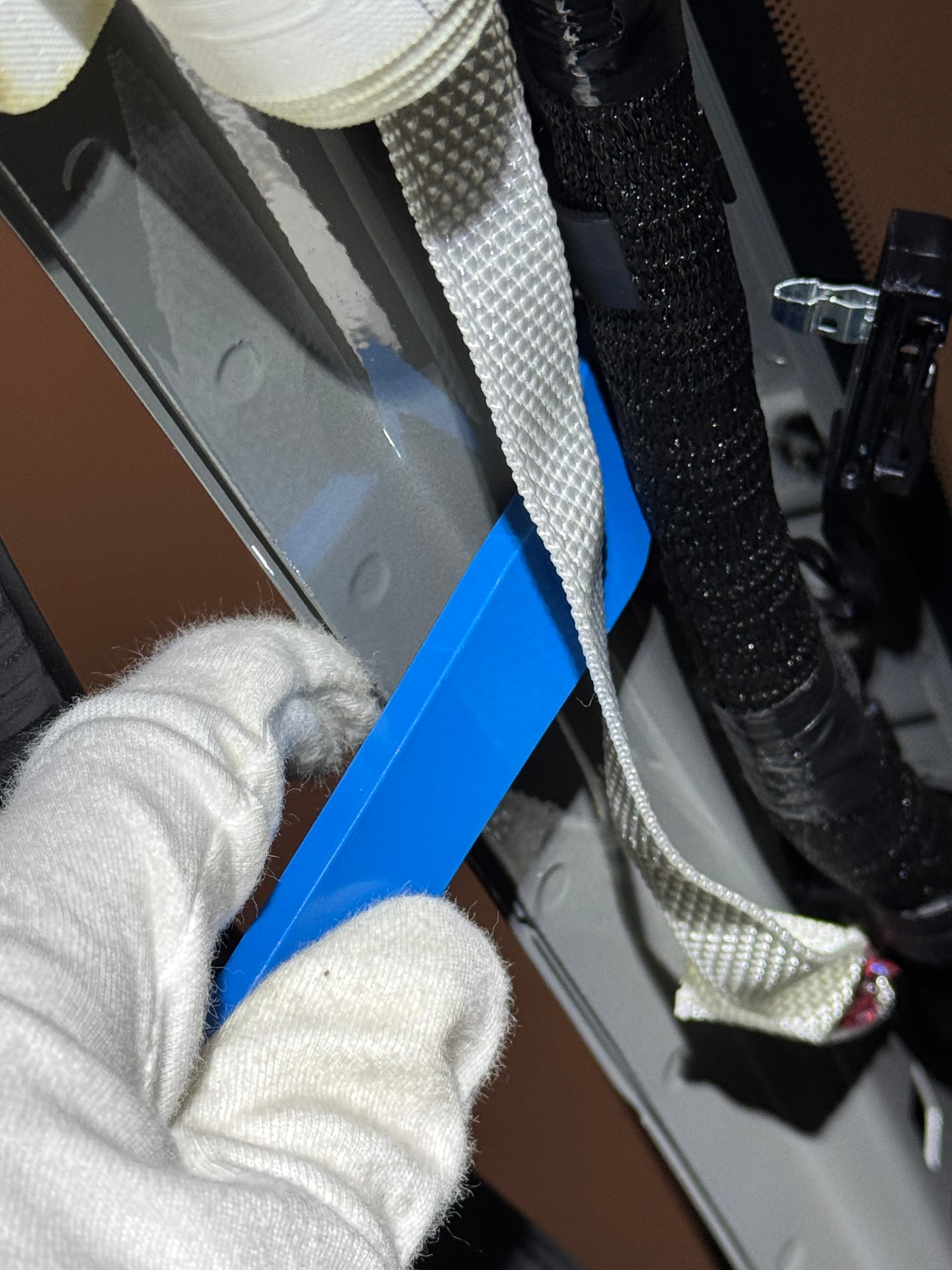

5- Pull aside the door seal near the center of the A pillar.

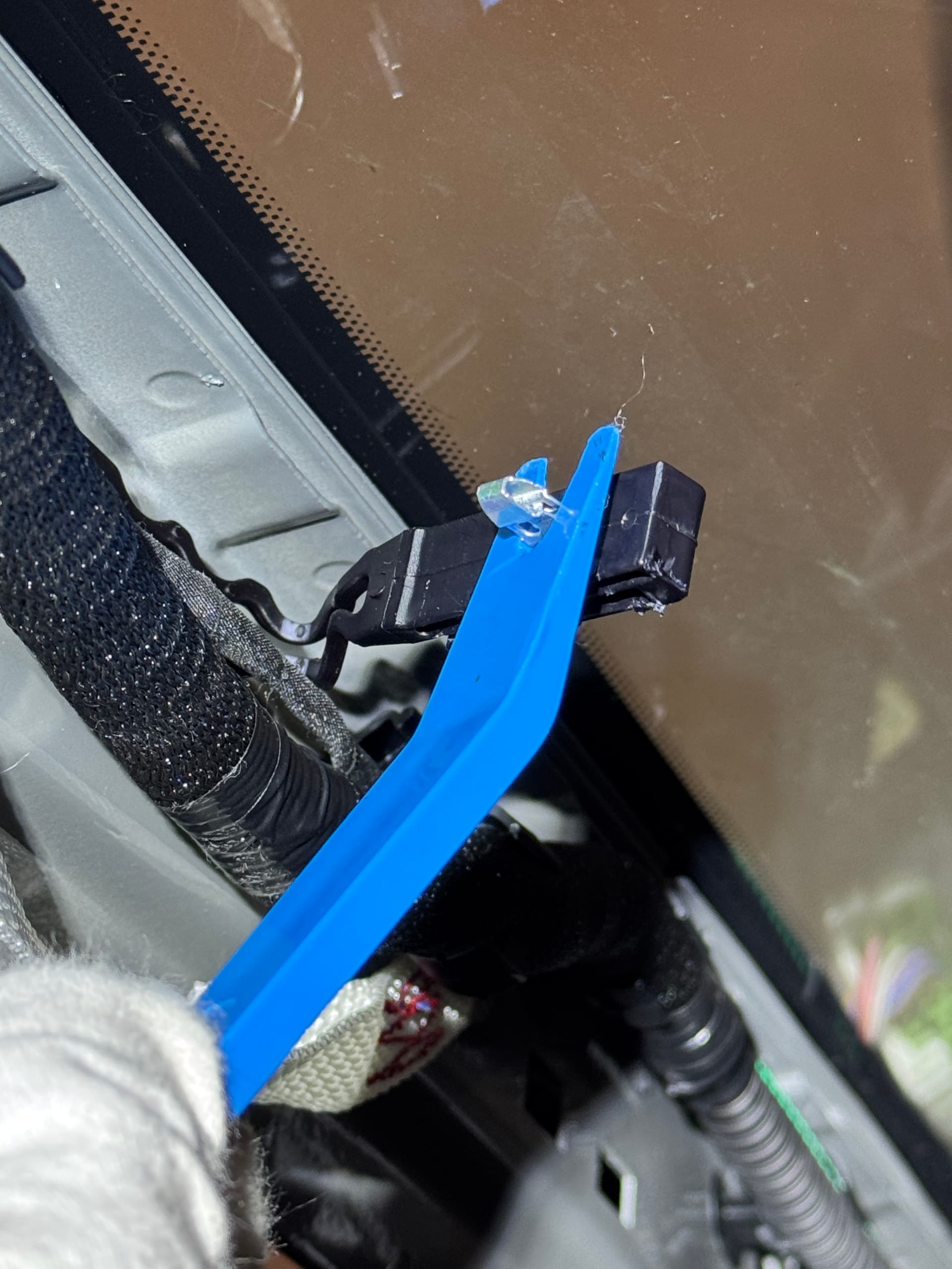

6- Use plastic levers to find the leverage point to release the center metal clip (BE CAREFUL of the side airbag cables).
picture taken after removing the A pillar, for showing the right point of leverage

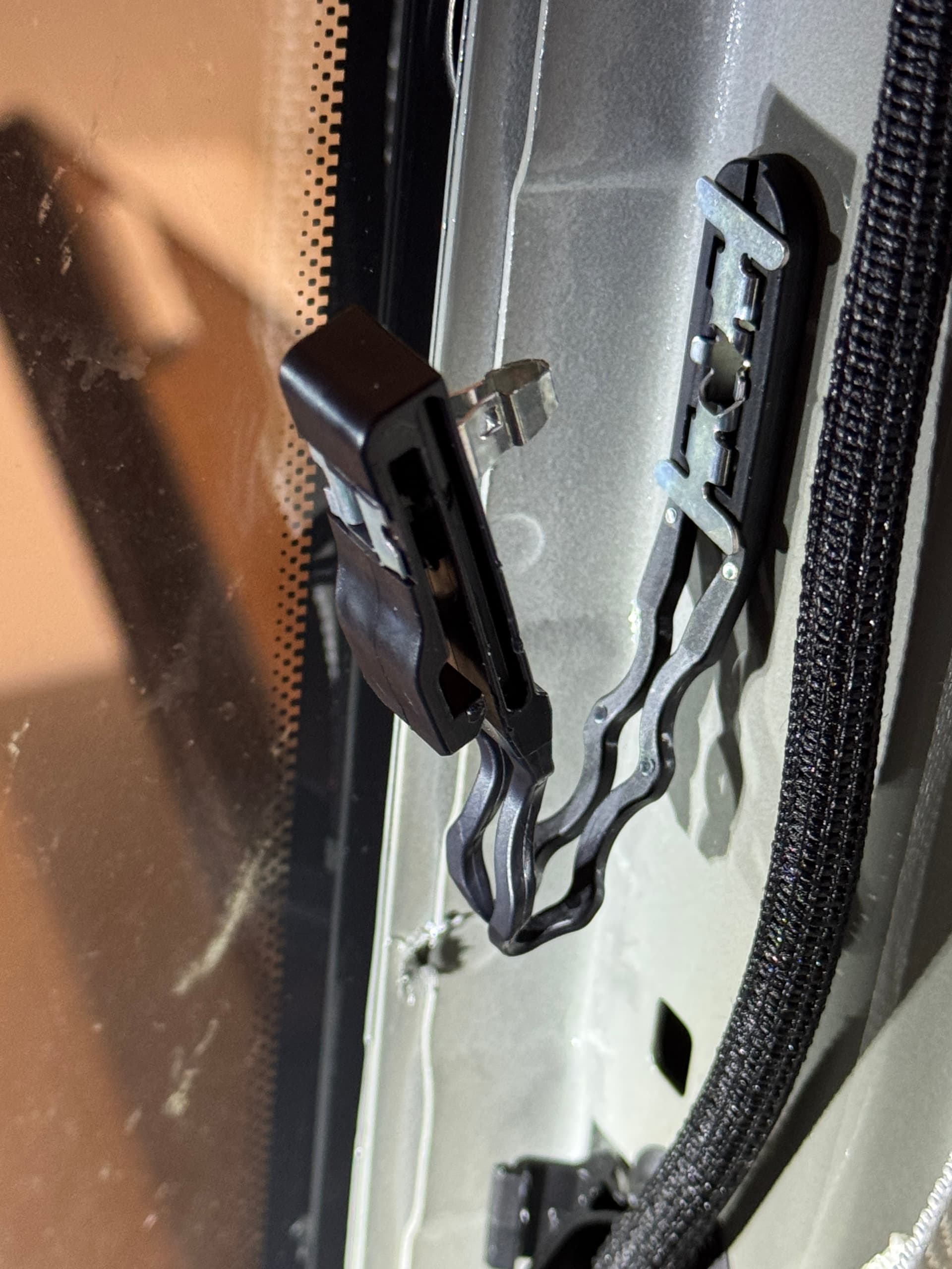

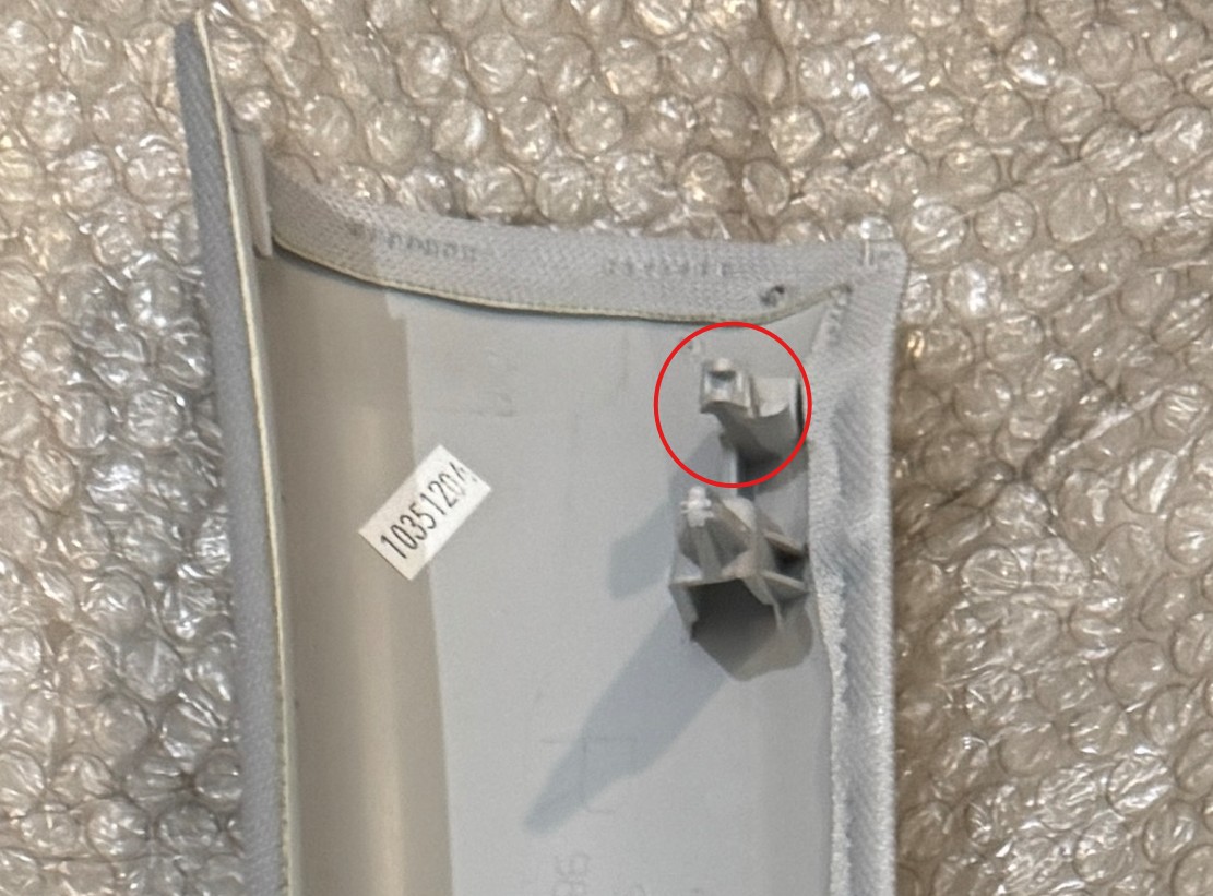

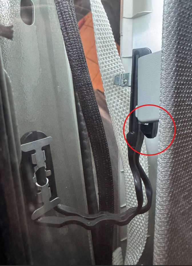

8- Unhook the flexible strap from the plastic strut , the strap will remain connected to the metal frame. have a look on it from the exterior of the car through the windscreen.
you have to disengage the clip (red circle)

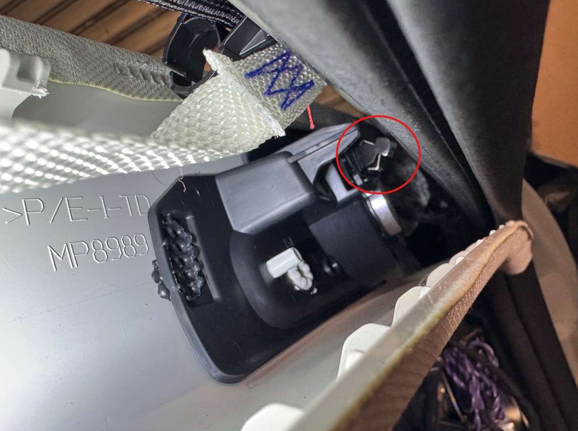

9- Now pull on the lower part to release the clip near the tweeter.
10- Rotate the A pillar panel toward the dashboard, without pulling on the tweeter wiring.
