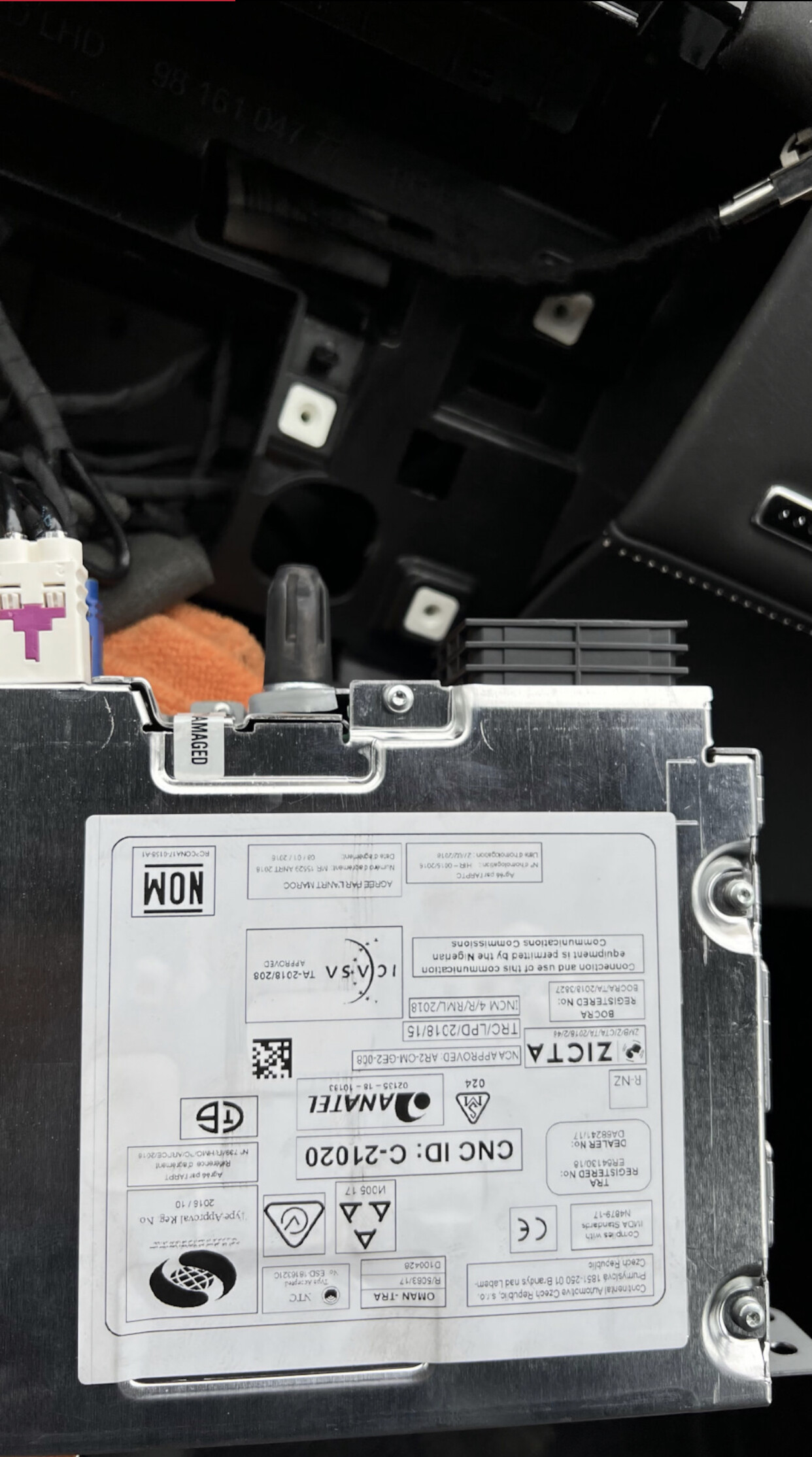

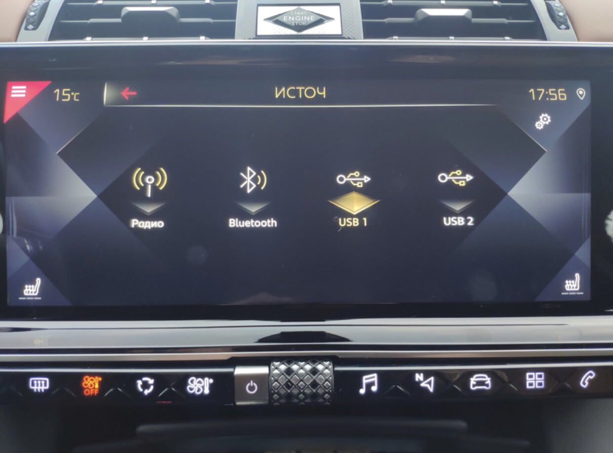

But, it’s possible to add one more usb if u want)
Hey @Vik, can you provide a bit more details, please?

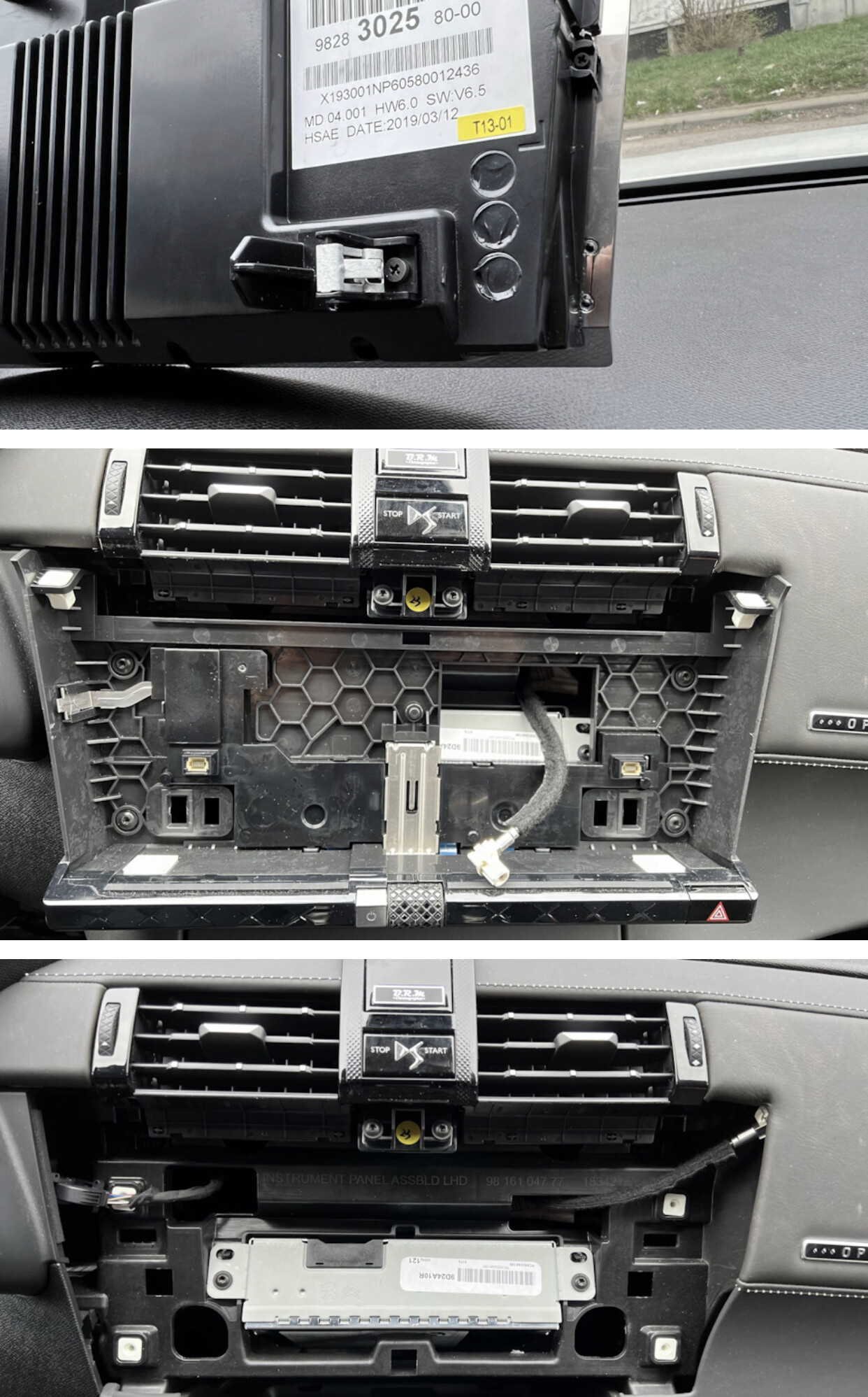

I have long instruction how to do it, u need to disassemble multimedia. If u want I can send it to you in pm. Or me I’ll write this information here, if it will be possible to add photos
I see. Thanks, but nah, I’m not interested in disassembling the multimedia. I’ll just use the 12V charger adapter as an alternative.
Thanks anyways.
I’ll add information, mb somebody in future will do it)
Sorry if it have not good translation)

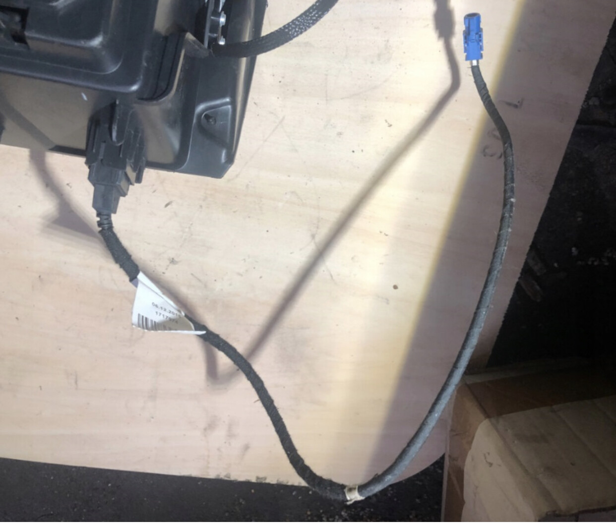

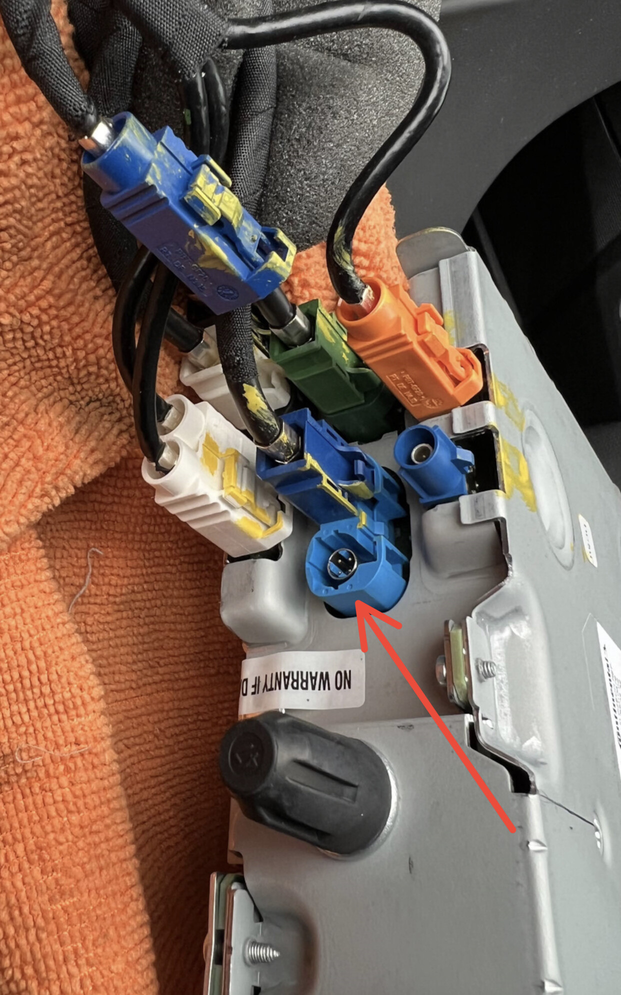

So, and u need to buy additional wire from PSA like this.
30 min of work) but u need to place him somewhere. For example in glovebox.
