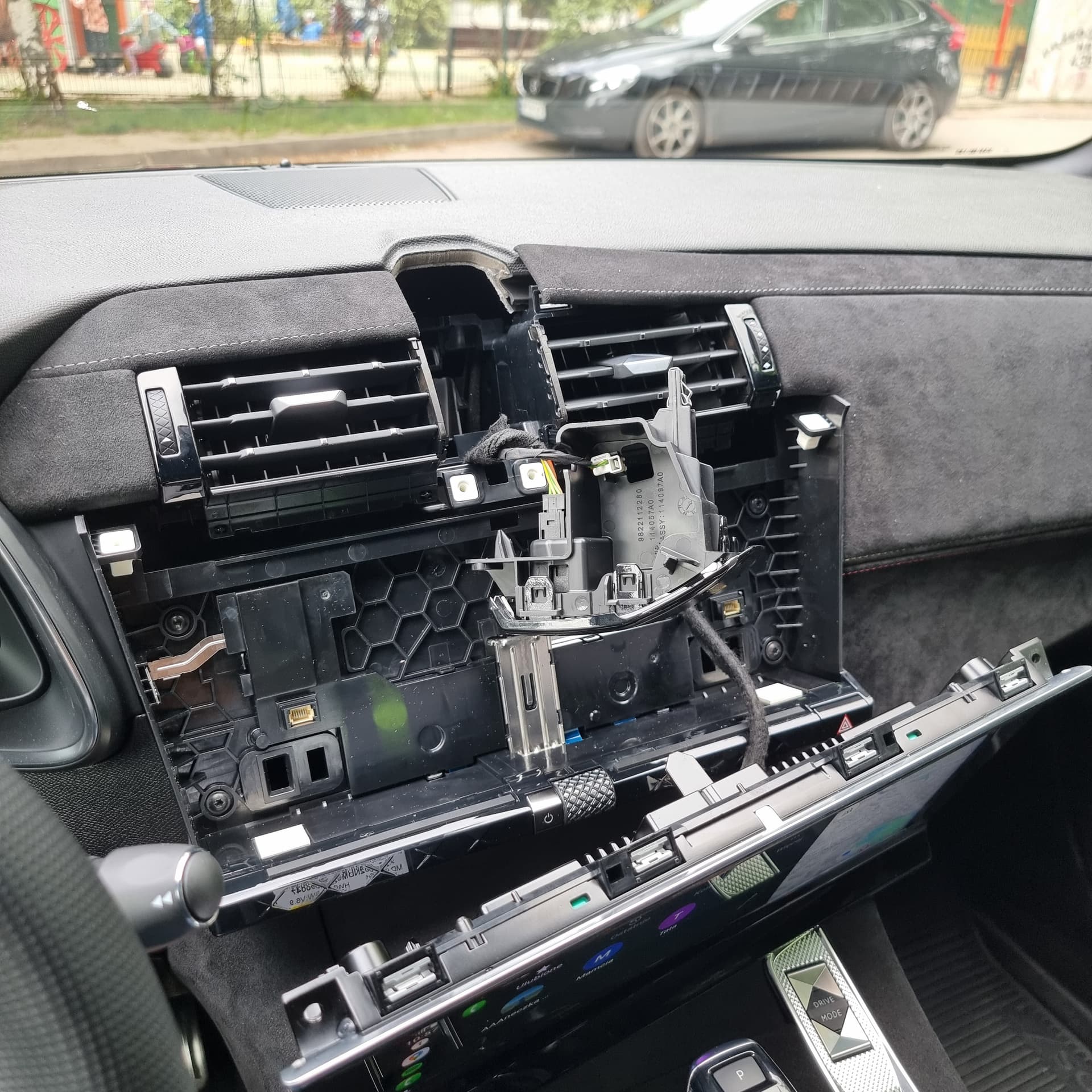

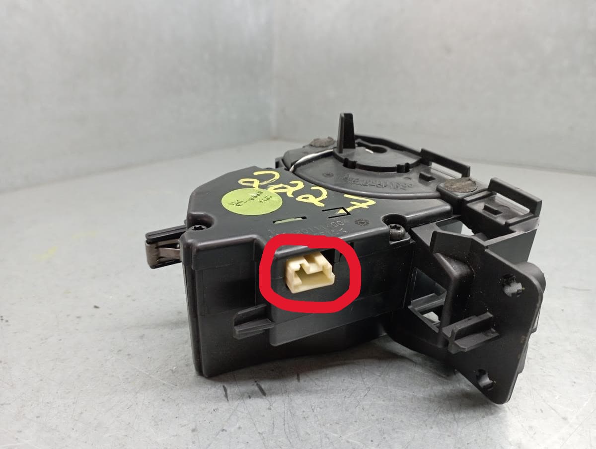

Hello, just a small problem here… there is no connector for clock in my car. Do someone have a wires schematics for clock- there are 3 pins connector on the back. I think there is positive, negative and CAN connections, but not sure.
Thanks in advance.

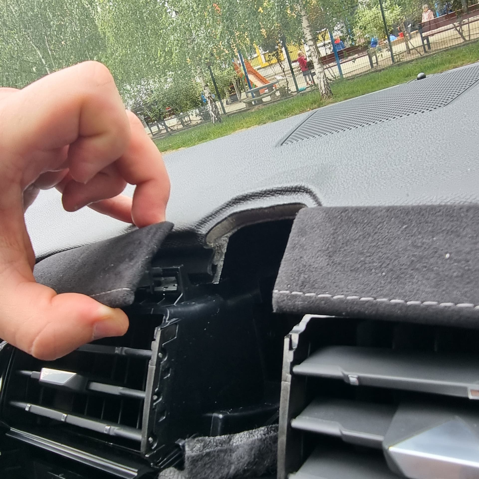

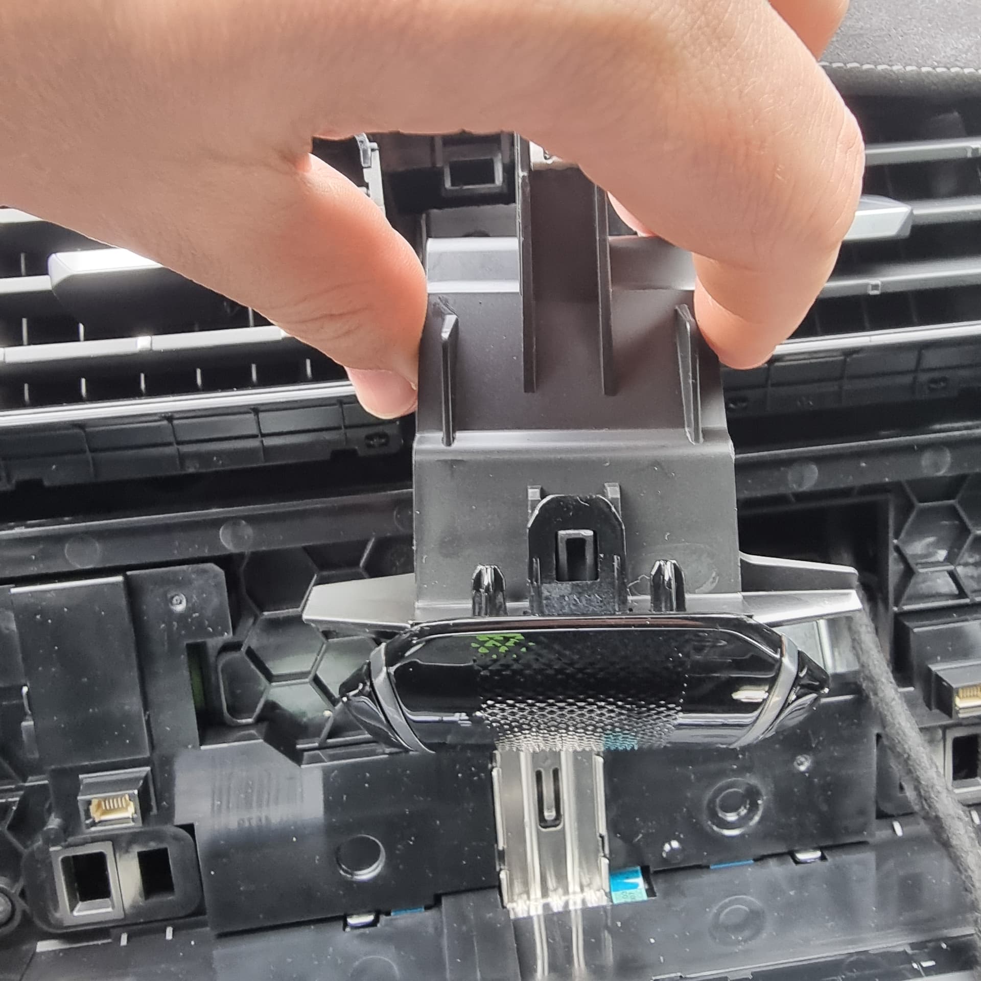

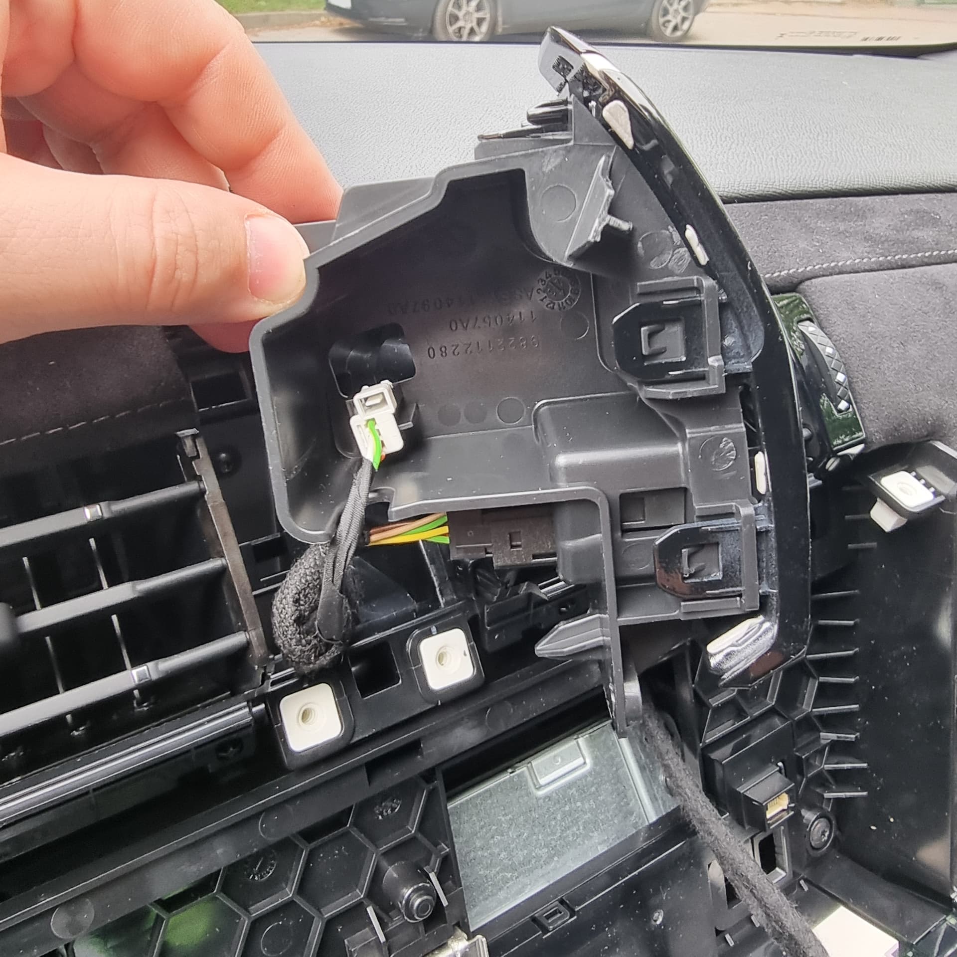

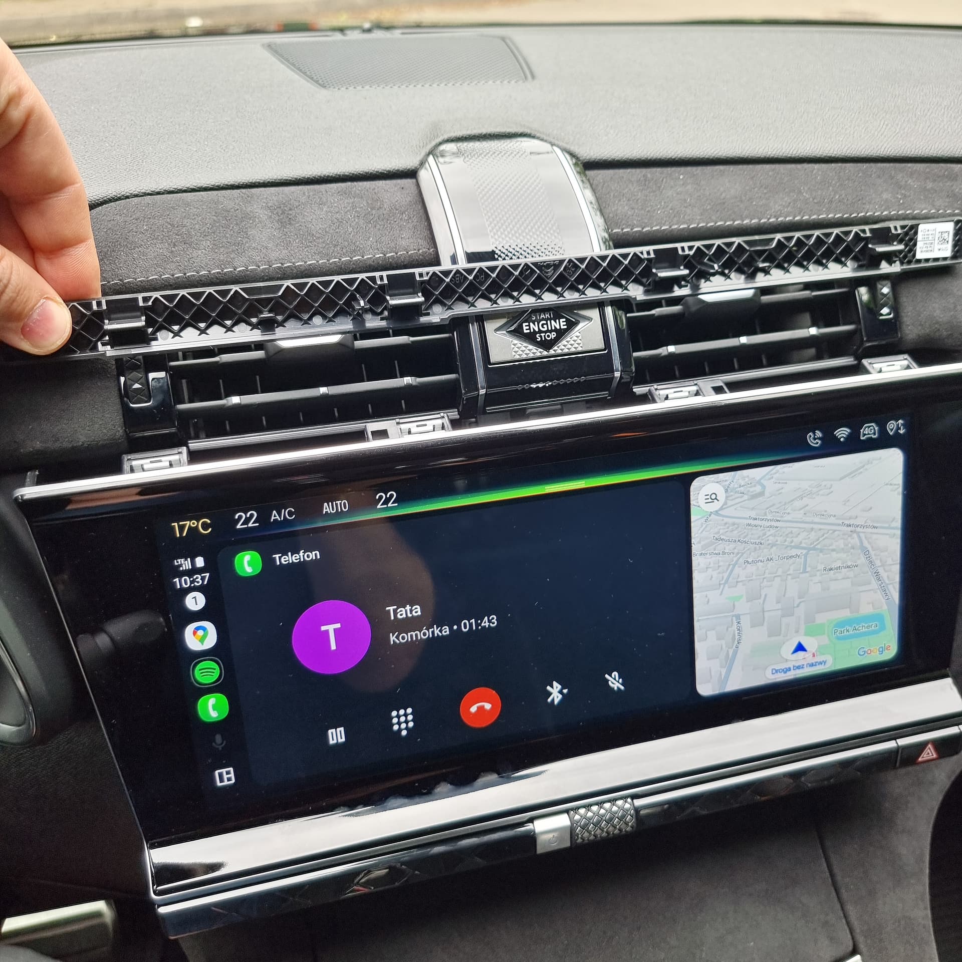

Hi, some photos from disasembly, it is 2025 Edition France 1.5BHDI.
Hello everyone. I just removed the start stop button to install the new one with the clock but the connector is missing. How do i connect the clock? Has anyone found themselves in the same situation as me? Is there a wiring diagram?

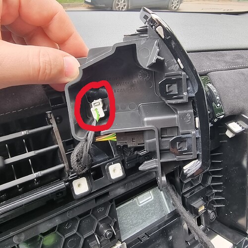

Thank you for your reply. When I remove the panel where the future clock will be installed, I only have one cable instead of two as shown in the photo (I do not have the red one).
When looking at the clock, there is a connector that needs to be plugged into the clock.
Helli Leonardo. I have the same problem. Cannot find the connector for the clock, i even took out the complete infotainment centre to look for it. Has anyone come back to you with a solution yet?
Hello Jeff. I cannot find the small white connector either.
Could it be wrapped in the covering of the staryer cable. I have a 2019 petrol performance line could it be this model did not have the connector ? Or i need to look in a different place for it, i have already took the stero out completely.
Hi Simon, mine was attached to the starter switch.
