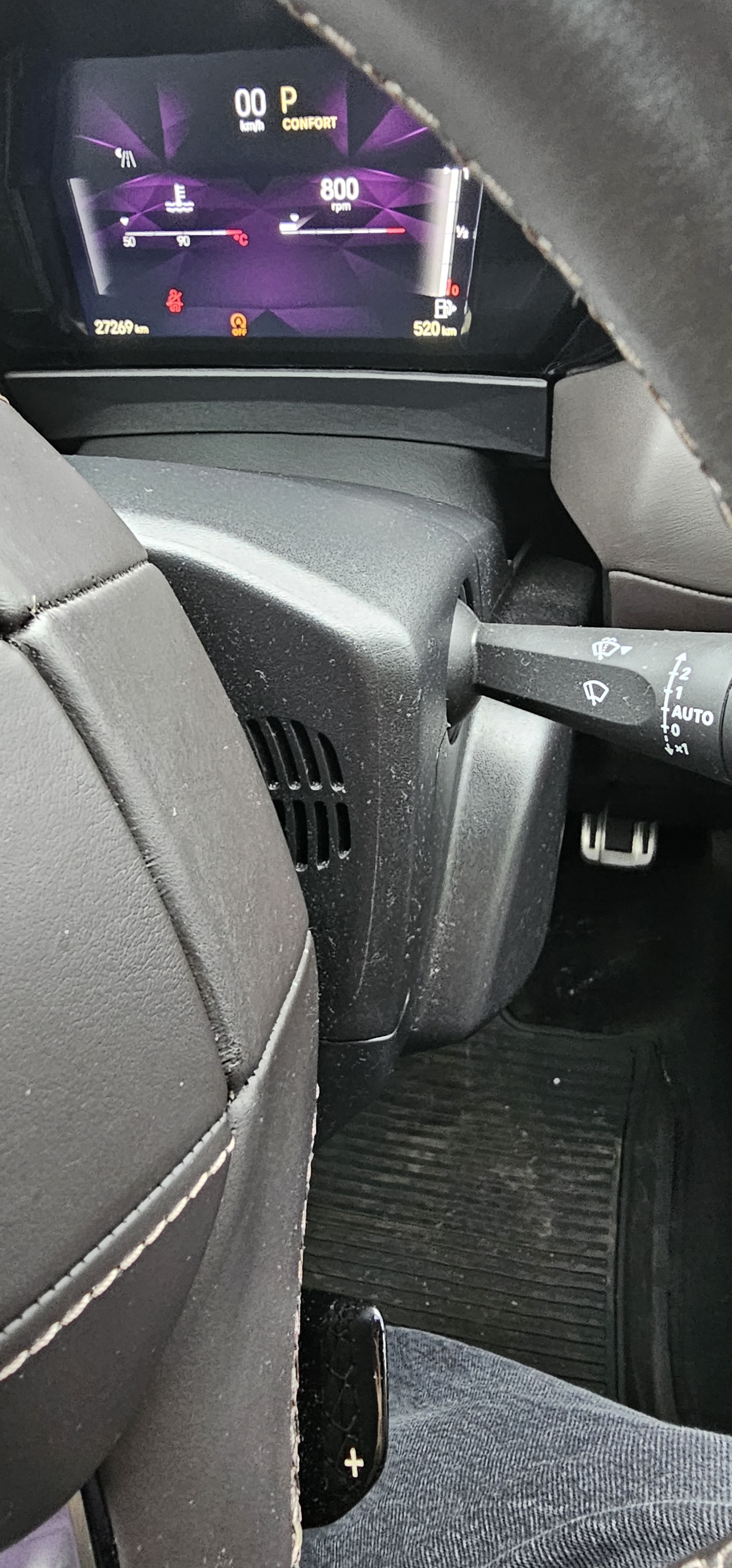

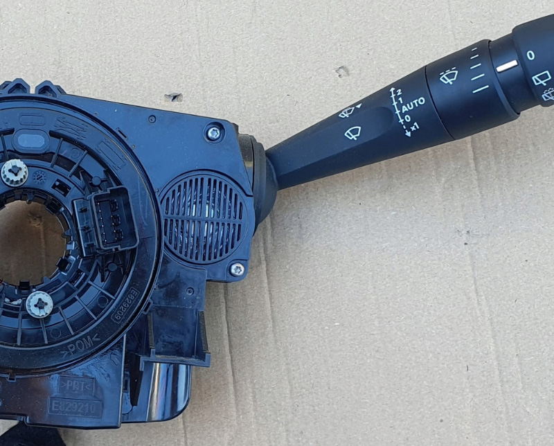

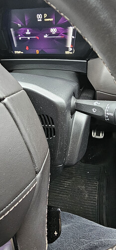

I’m still a bit confused though, where is the steering wheel buzzer located , I cant see anything on my steering wheel ?
And you won’t see it because it’s inside the steering column housing.
So what is this usually used for, I cant recall ever hearing a buzz sound from the steering wheel ?
Hi, Jactac
You can see that buzzer in the attached photo, as noted by both Andrew_PL and myself. It seems this buzzer is used in the situations mentioned above, if the alert sounds (such as seatbelt reminders, doors opening while driving, missing key, turn signals, etc.) cannot function through the speakers due to a problem, like in my case, the system automatically switches to the buzzer so that these alerts can still be heard.
