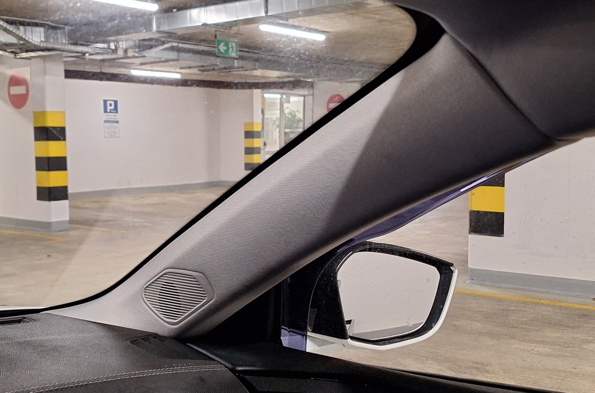

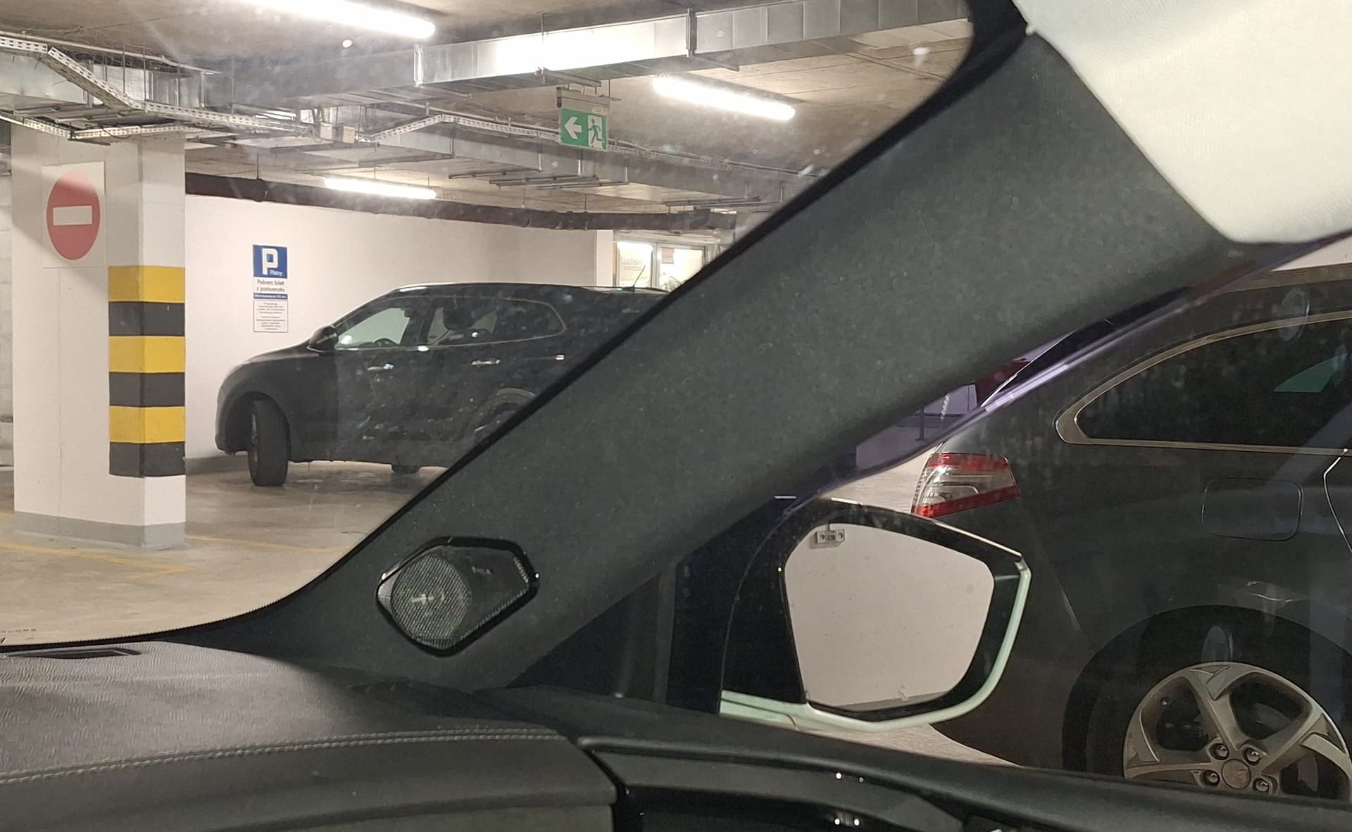

Since I always have something to do, this time I decided to improve the audio quality in my DS4. I have standard audio, meaning no amplifier. There may be a few issues, but the main one is the speaker mounting in the front doors. These mounts are unusual for PSA cars and need to be modified. The rear has three screws, so there shouldn’t be any surprises there. I plan to replace the standard speakers with Focal aftermarket speakers designed for PSA cars. The speakers have the same connectors as the factory speakers, so changing the wiring harness isn’t necessary. The speakers are Focal IS PSA 165 front speakers and IC PSA 165 rear speakers. However, I’m not ruling out the option of IS PSA 165 front/rear. The whole thing will be complemented by soundproofing the doors, which will improve low frequencies. I also have plans for a tweeter in the front (A-pillar), but I’ll write more about that after I’ve verified it. The last photo is a preview of this.

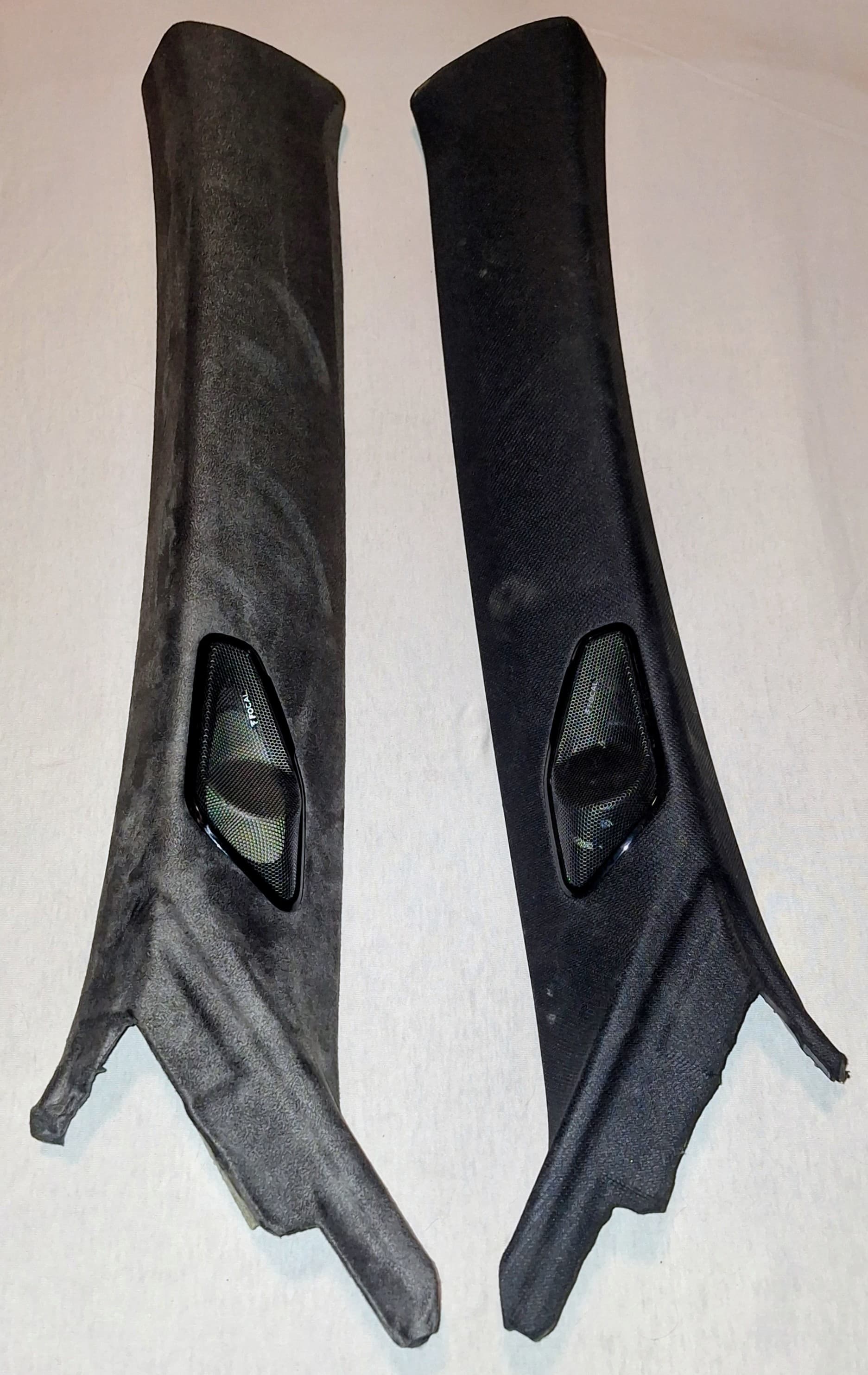

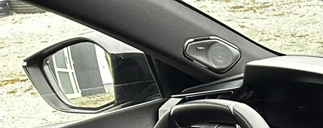

As for the front tweeters, the Peugeot 308 T10/408 has the same A-pillar covers as the DS4 (and the Astra L too). It’s enough to look out for number 9832170280 or 9832170880 (right or left pillar cover). The results will yield different answers – gray, black, Astra, P308, DS4, with/without Focal. The conclusion is the shape and mounting of the cover is the same, only the finishes are different.
So I bought the black A-pillar covers from the P308 with Focal speakers to test. There is a different angle of the tweeters and this may have an impact on the audio stage and at the same time there is less light gray in the interior.

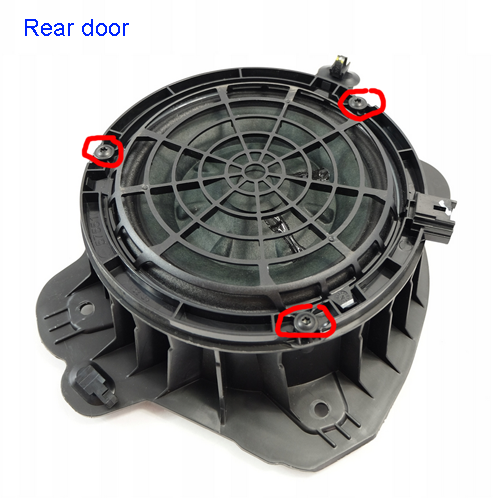

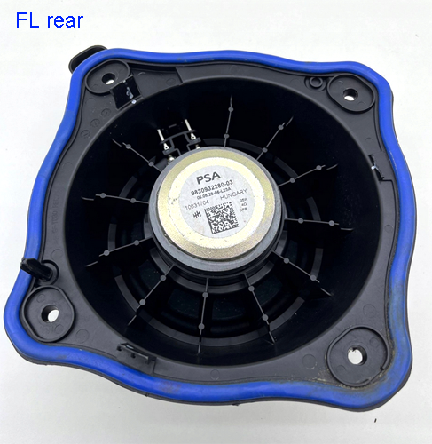

Changing the rear speakers is simple. Remove three screws and the speaker can be removed. The Focal IS/IC PSA 165 should fit in the rear doors without issue.

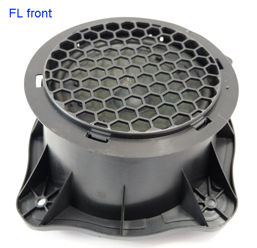

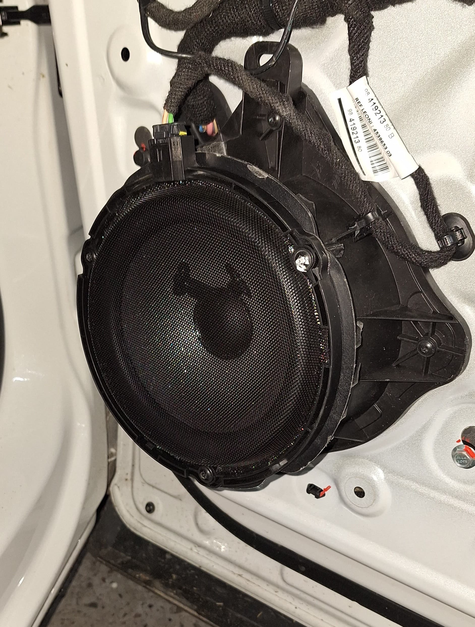

The front doors are where the problems begin. Dedicated PSA speakers won’t work here. The speaker is integrated into the plastic that mounts to the door. There are no screws holding the speaker in place. 3D printing or reusing the plastic from an existing speaker will be necessary.

On the occasion of my speaker replacement, because my DS4 is the Performace version with Alcantara finish, the A pillars will also have graphite Alcantara. Black would be too obvious as a choice.

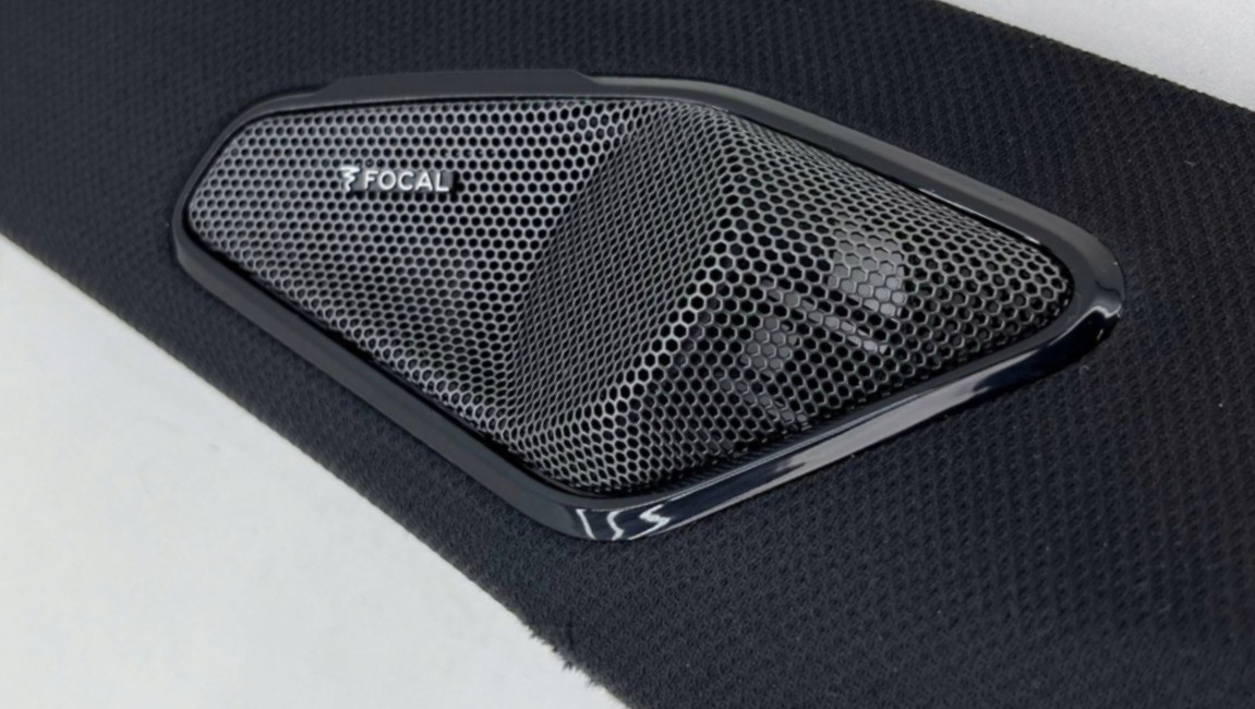

4x Focal tweeters

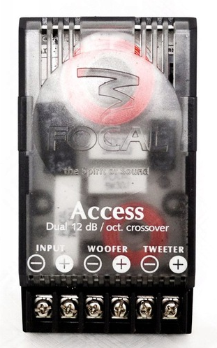

4x Focal 12dB/oct passive crossovers with 0/-3/-6dB setup for tweeter

The A-pillar cover from P308 fit, of course.
But if someone just wanted to replace only them, there are three problems:

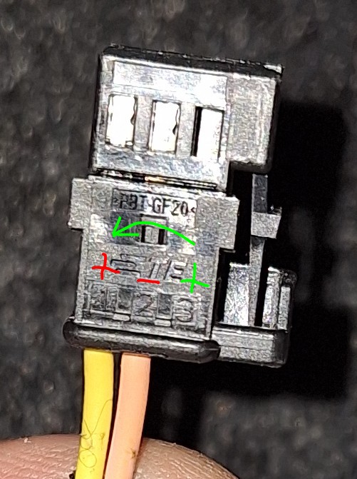

  1. The wires in the no Focal plug are inserted differently, and for the PSA Focal tweeter, they should look like this:
  2. For the tweeter to work for a long time and properly, you should at least add a 63V 10 microF capacitor to the + cable. Without this, the tweeter could be damaged at low frequencies. However, a passive crossover is generally recommended.
  3. The Focal tweeter has higher efficiency than a standard tweeter, so replacing just those drivers won’t improve the sound. It’s going to be weird. The woofers should also be replaced because without it the midrange and bass will disappear

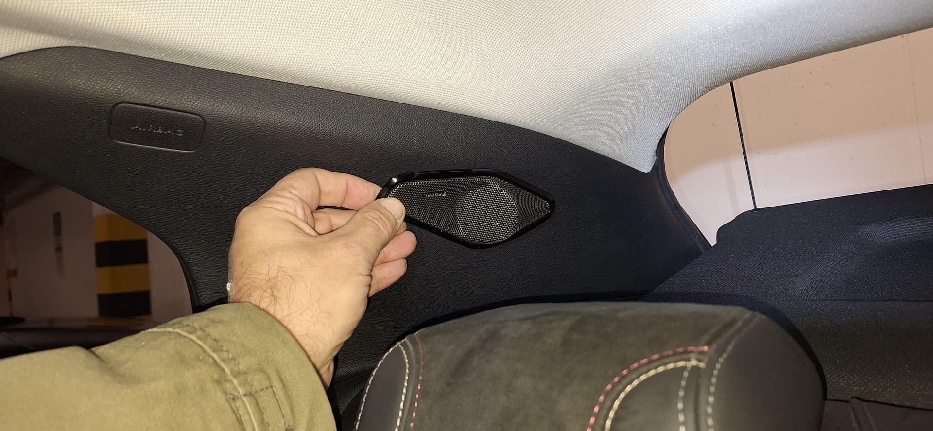

Now I need to mount the tweeter in the C-pillar

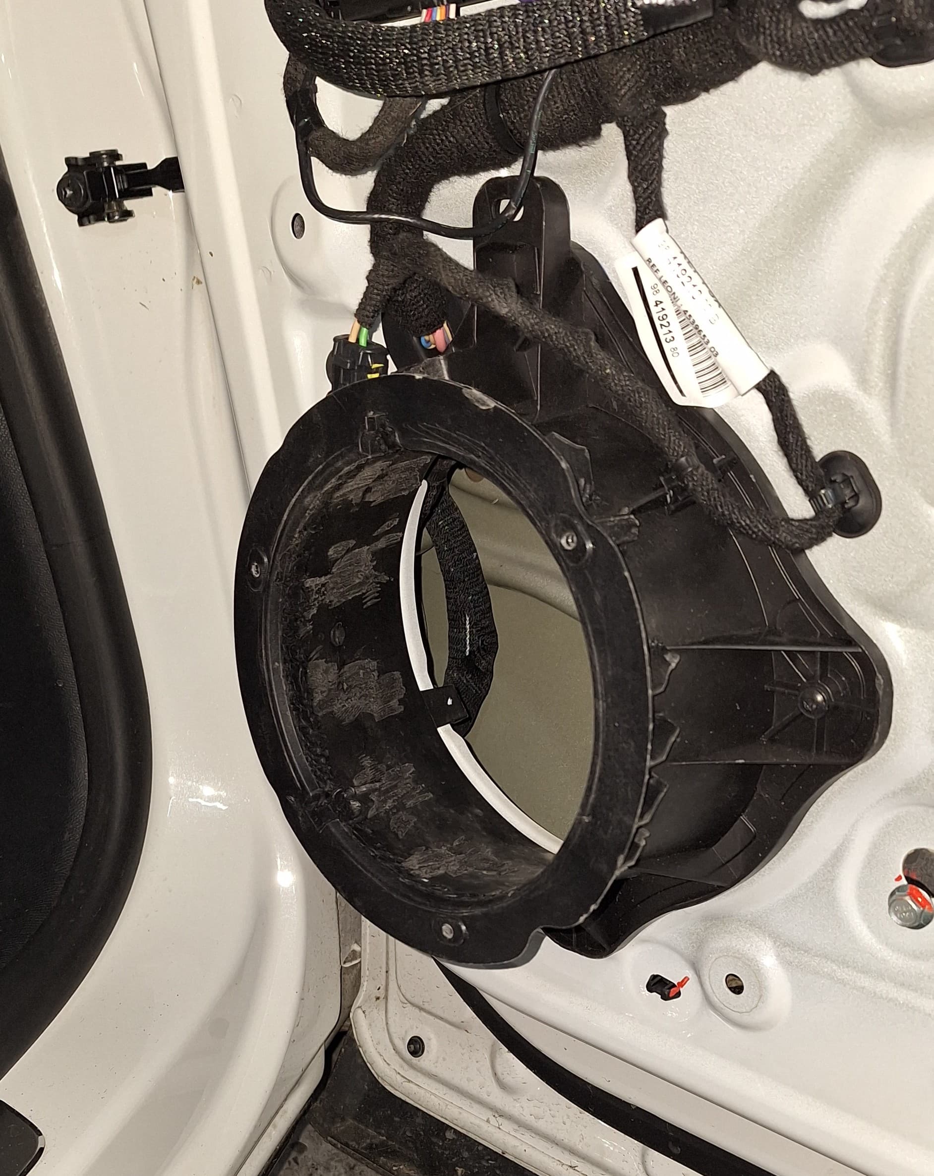

Replacing the front woofers requires making new spacers. Unfortunately, I don’t have a 3D scanner, and that would be the best way to 3D print the spacers later, as the angles are variable. Doing it manually is a real hassle.
Done.
The prototype of the spacer in the front doors for the PSA screw-on speakers looks like this
Fits perfectly
OE numbers of the spacers for original Focal Electra speakers in DS4 front doors are 9830785880 (left) & 9830785780 (right).
I received this information too late, so I had to build spacers by myself.

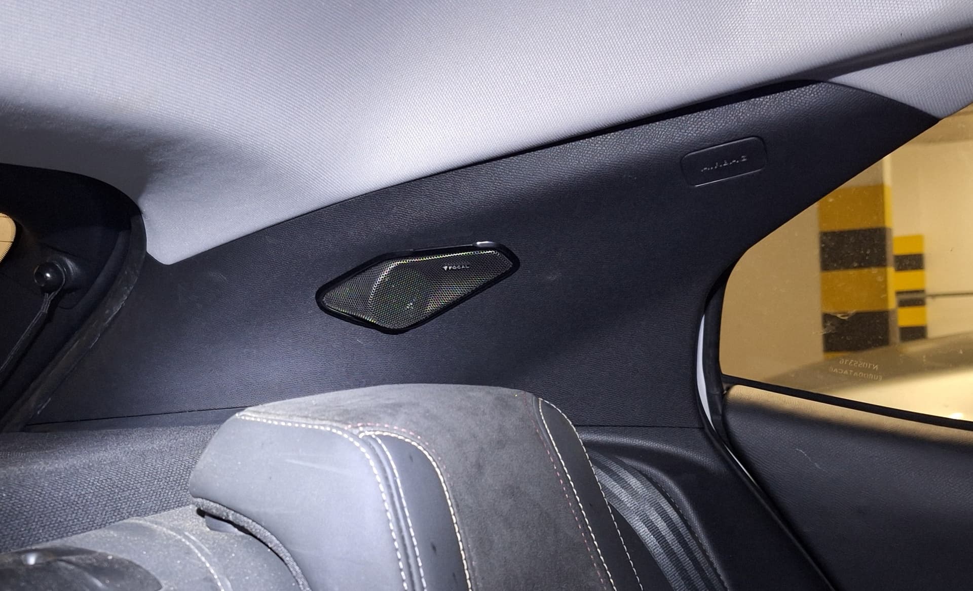

2: I suppose rear speakera are just an a crossover woofer like woofer tweeter in 1 165 right? while in electra version is tweeter yp and woofer down. So how does you fit a tweeter in c pillar on non electra version? You leave woofer in rear door and take the signal from rear door a place a tweeter in c pillar?
Both speakers are the same size, but constructed differently. The Focal speakers can be unscrewed and replaced with other 165mm speakers. Without the Focal speakers, you’ll unfortunately also need to replace the spacers in the front doors with Focal spacers.
You need to find and cut the wires in the B-pillar, insert the crossover, and power with the wires the tweeter in the C-pillar.
This can be done without a crossover, simply by adding a capacitor (6 dB/Oct) to the + tweeter line. However, this will cause the tweeter to play too loud, so a 2-way crossover (12 or 18 dB/Oct) is recommended.

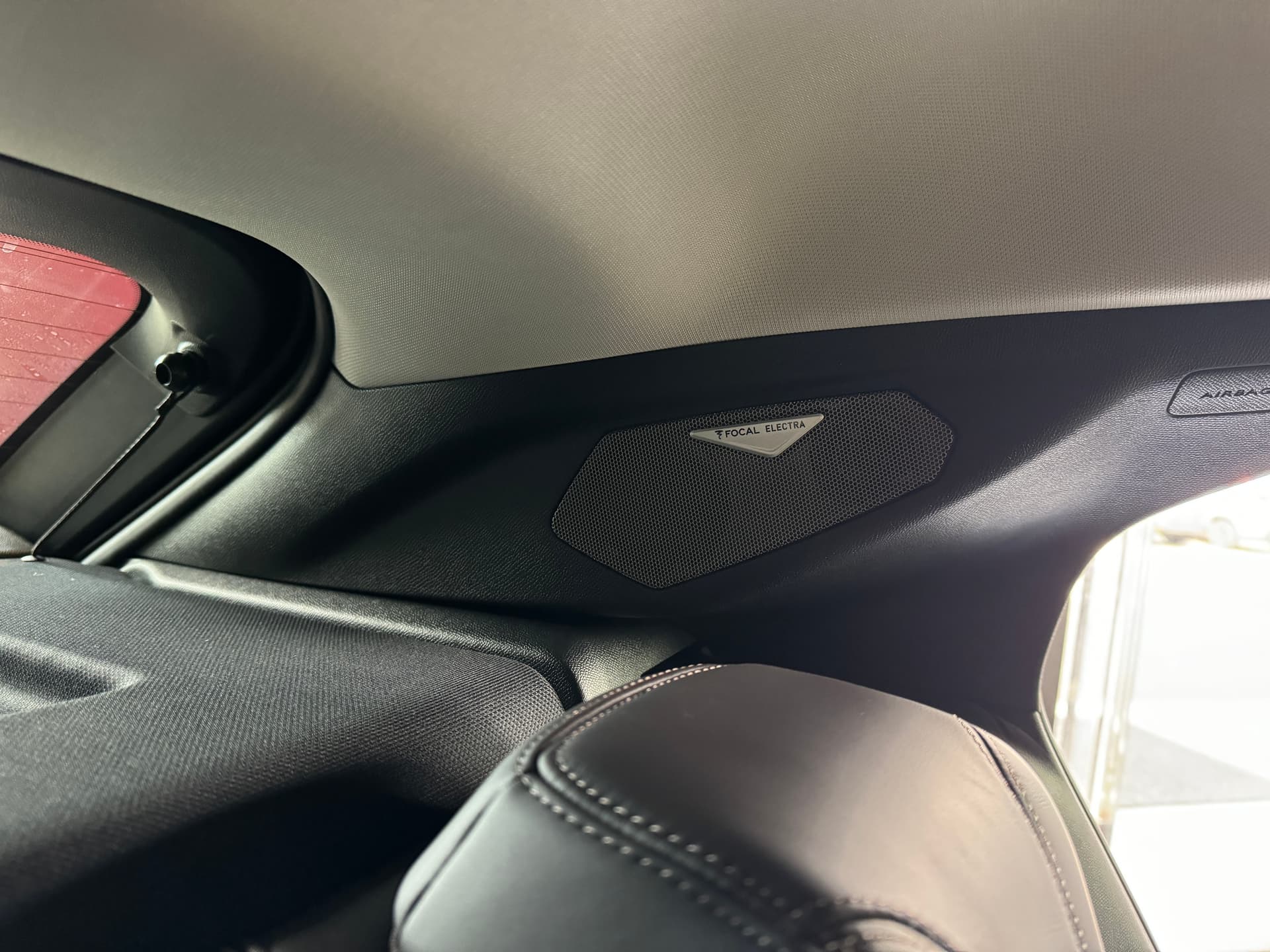

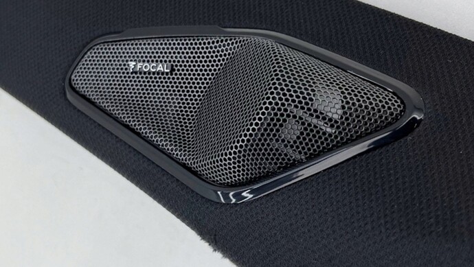

hello Andrew, May I kindly ask you why have you choosen to do this modifcation instead of replacing the entire C-pillar with the one “Focal made” that contains tweeter and midrange? please see the pic.
and also, can I ask you, was it easy to disassemble this C pillar?
thank you in advance
That’s why I did it, because the Focal Electra C-pillar is unavailable as used part. And a new one in the DS Store costs a small fortune.
Is it easy to disassemble? Yes, but you need a little experience to avoid breaking the latches.
