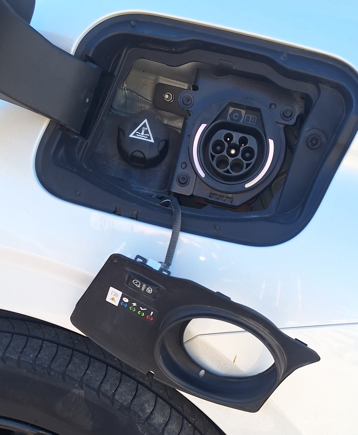

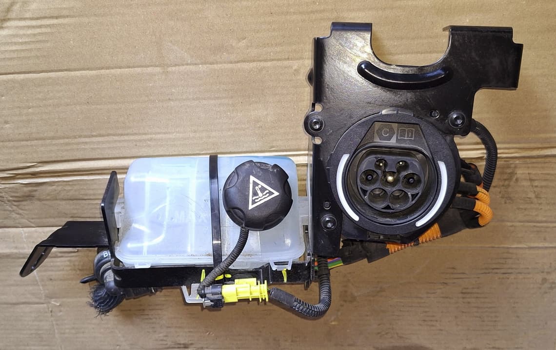

So the DS4 PHEV has two reservoirs that need manually topping up ?
I can see the obvious one under the bonnet but where is the second one on the DS4 PHEV ?
It’s under the plastic in the charging socket. This part with the button, sticker and rubber seal is removable.
The latches for this part are at the bottom, so you have to do it from the bottom. It’s not possible to do it from the top, as it could be damaged.
Wow,
Excellent tip. :+1:
How often does this need topping up, is there any indication on the dash when it needs topping up ?
Does it require antifreeze like the usual reservoir under the bonnet ?
I’m still amazed you knew about this.
I cant find any info in the manual regarding this hidden reservoir ?
There’s no information provided for this system. It’s worth keeping in mind, though. There is no indicator light either, there will most likely be some error in the traction battery cooling.
Yep, the same.
