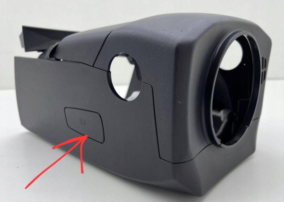

Anyway - theres a spot on the steering wheel column with a symbol like the RFID symbol. If you hold your fob against that symbol you can start and stop the car even without battery in it.
I replaced my battery without any success. After that I disconnected the two batteries, let it sit 10 minutes and reconnected.
After that everything started working again.

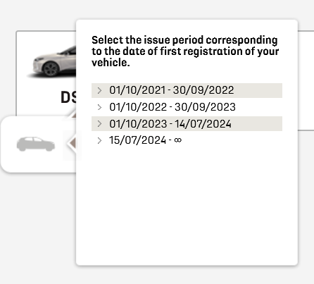

It’s worth knowing the car’s production date, as this increases the likelihood that the manual will be accurate for a specific vehicle. This doesn’t mean, of course, that it’s clearly written.
Unfortunately, even in the available sources, DS described it incorrectly, which may be misleading if the car was standing in the DS yard for i.e. 12 months.
