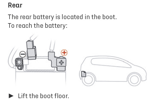

Yes, but after the vehicle has been sitting for a while (12–24 hours), you need to open the trunk and wait about an hour. A voltage below 12.3V indicates an undercharged battery; anything below 12.1V means it is discharged.
In general, this battery needs to be replaced every 2 to, at most, 3 years.
Ok, can i do that with my own multimeter? And where exactly because i’ve opened the trunk and that … lid? And i see some electrical wires but nothing like some + or - to put the multimeter on haha
You can do this using your own multimeter, provided it is in good working order and gives accurate readings.
On the 12V battery, the red plastic cover indicates the positive (+) terminal, and the black one indicates the negative (-) terminal. The actual terminals are located underneath these plastic covers.
In any case, the polarity doesn’t matter when measuring voltage; at most, the result might show a negative value, but the magnitude itself will still be correct.
I’m not talking about the front engine one. On the back in the trunk first you have that big cover, then a smaller one with some small handles, and beyond that where you have like the key for wheels, on right side you have a cover. Beyond that i thought it should be the baterry, but i cannot see any terminals
Neither do I.
I’ll look again but nothing that seem like terminals were spoted :d
Remove all the inserts from the trunk, and you’ll find it on the right-hand side, near the bumper.
