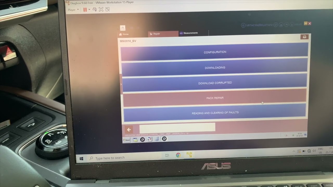

Hello,
Possible solution provided by me from Peugeot forums. If I am not mistaken, DS and Peugeot use the same solutions:
I had that issue at my friend’s 508. Managed to fix it with the instructions presented below. All of that is necessary to be done in Diagbox.
Make sure the RADAR has adequate parameters (X and Y tilt)
Reset the RADAR module in the “REPAIR” option and all its related errors
Take care of or remove errors in the modules related directly to RADAR (such as NVG)
Go to BSI module → PACK REPAIR → REHABILITATION OF THE VEHICLE DRIVING ASSISTANCE FUNCTION FOLLOWING THE DETECTION OF AN IMPACT (IF THE FUNCTION IS PRESENT ON THE VEHICLE)
If issue persists after the steps above, do the learning ride - option available in RADAR module
[EDIT] As an additional note. If tilt parameters do not change after readjustments and obstacle distance does not change dynamically (you just put your hand next to the radar and see if it calculates the distance), that means the device is most likely faulty or wires require further inspection.
