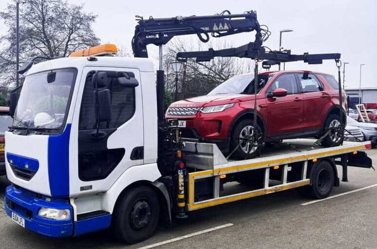

Look around because there is still the street lifter option and then you don’t have to do anything.
I have breakdown cover. Nearer to the garage appointment date I have to phone and book a lorry to get the car there. I was told to mention the carvis locked in park and the parkibg break is on. Then the breakdown company will send a truck with the appropriate equipment.
