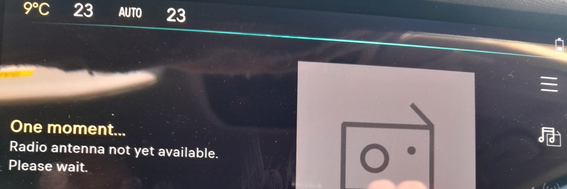

For 3 days now, the radio is dead, no signal no radio stations showing, no sound
The sat nav display works visually, but the location is all wrong and its showing no signal, so pretty useless in truth.
The connectivity on board wifi will not connect to the Stellantis servers… flipping the on /off switch it defaults to off.
It’s not finding any wifi networks that it usually does.
Stopped and started the car numerous times today, radio still dead.
The settings screen displays ‘One moment… Radio antenna not yet available.Please wait.’ See photo >
So I reckon its the sharkfin aerial telematics unit that is faulty?
There is just no signal at all.
Contacted DS dealer today , they suggested I try a BSI reset at the battery, I did this but nothing has changed.

That’s probably the case. Resetting the BSI (VSM1) won’t help; dealer intervention is required.

Also, now I think about it… it’s been getting warm to the touch recently and I notice from images of the unit online, there is a cooling fan integral to it… so it may have over heated.
Whatever, its under warranty so DS will sort it.

All sorted, DS dealer was excellent.
The BFSR unit has ceased communications with other modules including the shark fin telematics. They said they purged the system, then rebooted it… something a BSI will not do at that level…
Everythings come back, radio, sat nav, radar the lot…
