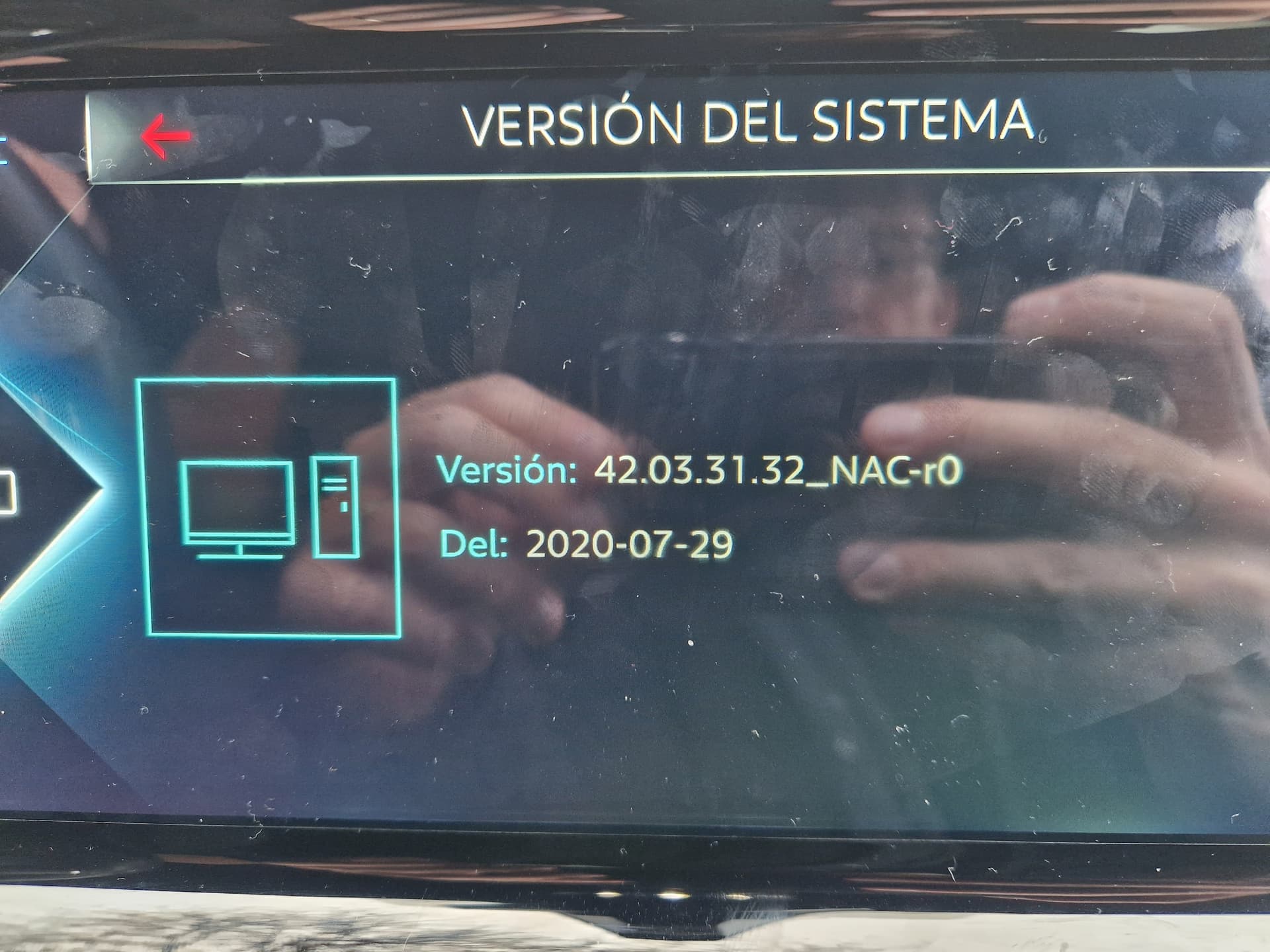

My question for you guys. Any idea on how to get the assembly date of the car? I got this crazy firmware version from the car itself:
Its impossible that the car was made back in 2020, but its crazy how this unit stayed not updated until now, and even left the factory in whatever year with a firmware that was already years old. I can not wrap my mind around the fact.

Hi @Fran_Bosquet
Date of assembly is on a sticker on pillar B. It’s 5 digits. For yours MY begginning from 17XXX.
01.01.2024 its OPR/ORGA no - 17220 + each day gives i.e. no 17420 as date 19.07.2024
The production date does not indicate the sale date/warranty start date, so you may have a car manufactured in 2023 but purchased in 2024
As for the radio, it could have been damaged and replaced at the DS Store. It’s best to check the radio’s sticker – that’s where the production date is. The software date doesn’t necessarily correspond to the radio’s production date. You can also check this with Diagbox software, but that requires a fee.

So the coincidence is that I managed to get an answer from DS Spain today, the same day I decided to seek for help here.
They just confirmed the assembly date: December 2022. So thats why I have no IRIS. This is really sad, as I know for sure that Its not possible to update the system. And yes, I should have asked here before, there is an N in my VIN for the eighth char from right, so that matches 2022.
