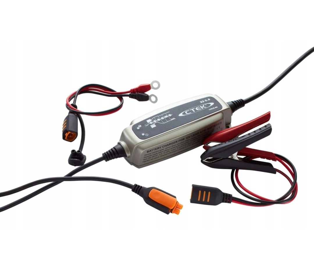

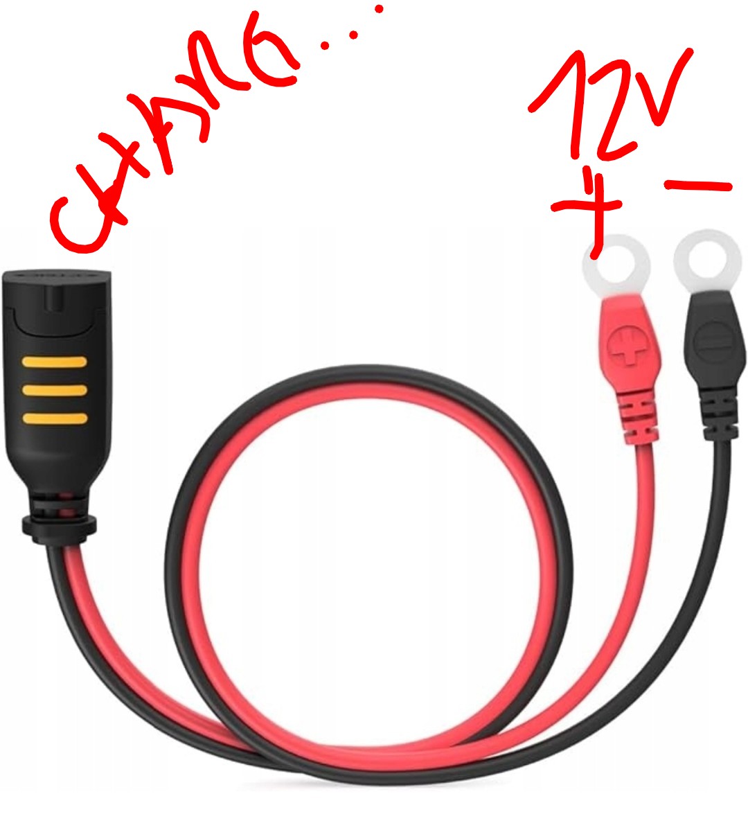

CTEK mxs 5.0 charger has wires with eyelet what is perfect to maintrance small 12V battery. I use this model for battery maintenance. This cable is still mounted in my car for easy access.
Thats exactly the charger I have, and use the eyelet on the main 12v battery.
When I last took the car to the dealers for them to check on the batteries they were apparently told by DS technical to remove the eyelet as it might be the cause for the battery to be self depleting ???
So, it was removed, a new 21v main battery was fitted and now I’m waiting for them to recheck the new battery to see what the outcome is.
Personally I think they are talking rubbish, trying to blame the eyelet.
